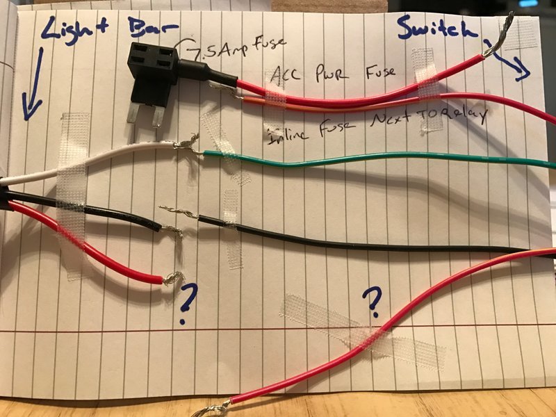

    So I have installed a front light bar in the bumper. I have never installed a switch of this kind, (always non-lite toggle). I have searched and searched but still cant figure it out. I want the switch to only come on if acc/power is on so I don't drain the battery. Every time I wired it before the switch stayed on with key out of ignition. I have supplied a picture to what I have been working on. Thank you in advance. IMG_0791.jpg

    It's a little confusing to see what you've got going on from your picture, but I think I have an idea. First off for clarity-
    Are you using a relay?
    Do you want the switch light to be on always when ACC power is on, or just when the light bar is on?
    Do you want the switch to only be active (turning on light bar) when truck is on or anytime?
    Likely the solution will come with choosing the correct fuse to tap for switch light power. Using a multimeter, check voltage of a fuse or blank slot with the vehicle off, and again with the key turned to ACC. When you find a fuse that has power in with the key turned, but not with the keys out, you're in the money.
