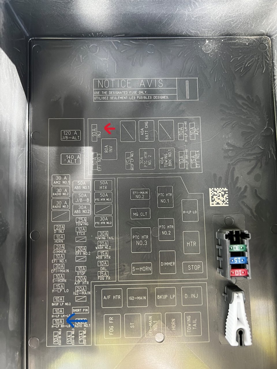

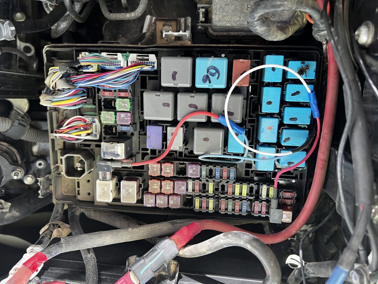

    Ignition switched, correct? If so, this is what I did for my SwitchPros which I got from a thread:
    Edit: Here's the Thread Lots of good info in there
    Injection fuse for Ignition On sense (Red arrow)
    Headlamp for lights On sense (Blue arrow)
    I do not recommend pulling power directly from these fuses but using them to trigger relays
    RJkcay2G7fQ0AKTqEhThw_7PjpQIl8tAI9wmsEal_d3ab257bbe2ba7a689cf8a0d8189e8b50496547d.jpg
    Used add a fuse for both. Remember to add BOTH fuses.
    _P8ioMQbI9jDISxJbiawBsm4B-uk_XklH6cSz8Cf_37aa9f150dd56c0863a48d9b3d26eec45ecc0fd3.jpg
