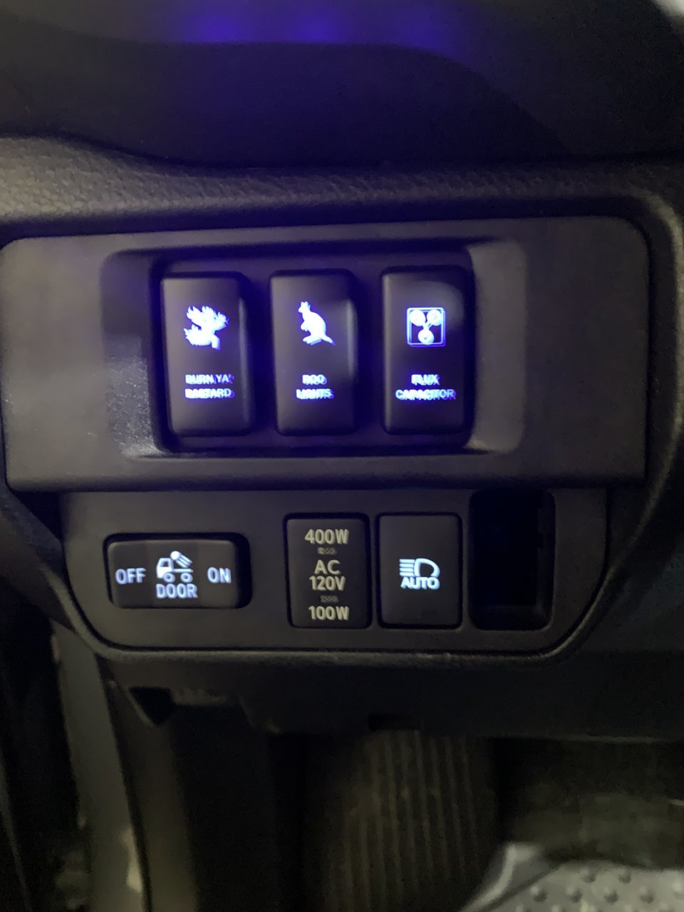

    Thanks. So better match than ch4x4 but sill not perfect. It does look like at least the color tone is close just not the brightness, do you think with a resistor to dim them they would be better?

    Possibly. But I think pumping all the time, effort, and research into $10 switches is kind of over kill. They fit perfectly and you probably won’t find a any switch that the glow/tint matches perfectly that doesn’t have “Toyota Motor Company” stamped on the back.
    Here’s a better pic. Note the BYB and Roo accessories (bumper light bar and ditch lights) are switched to on. The graphic portion of the switch illuminated when the switch is pushed on.

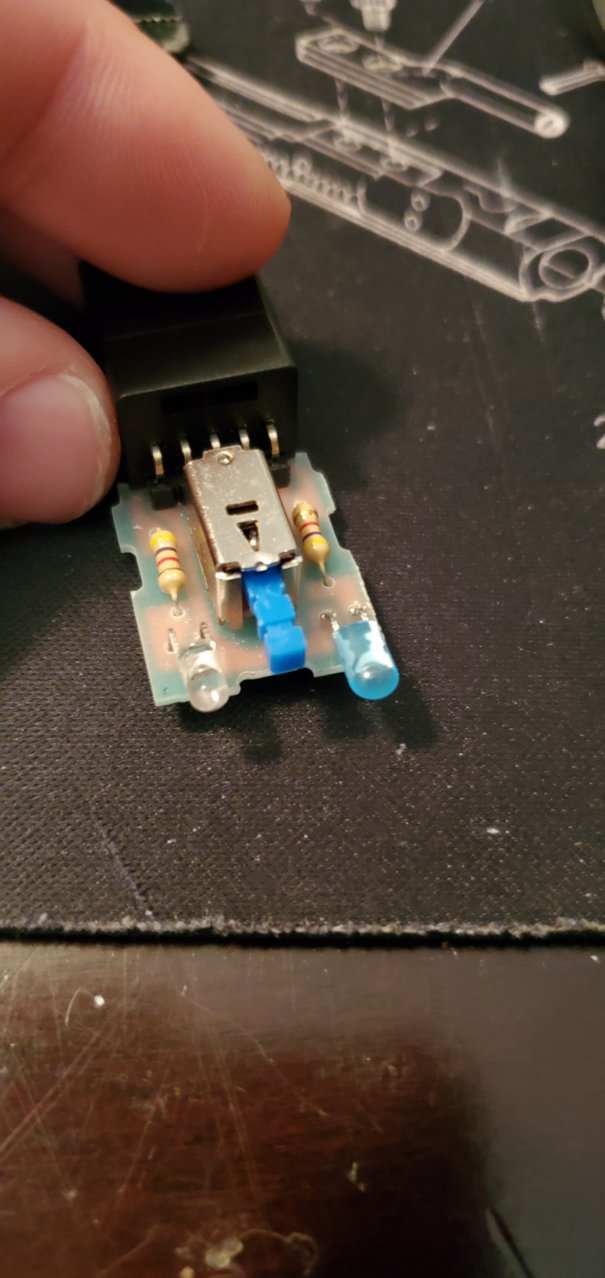

    Ive been playing around trying to find the perfect match led/resistor combo for the mictuning switches. Its relatively easy to desolder the leds and resistors on the mictuning boards. Closest ive got is swapping the 5k resistors for 10k to knock the brightness down and 475nm leds seem to be closer to what the AOB switches are but still not a perfect match. Let me see if I have some pics somewhere.

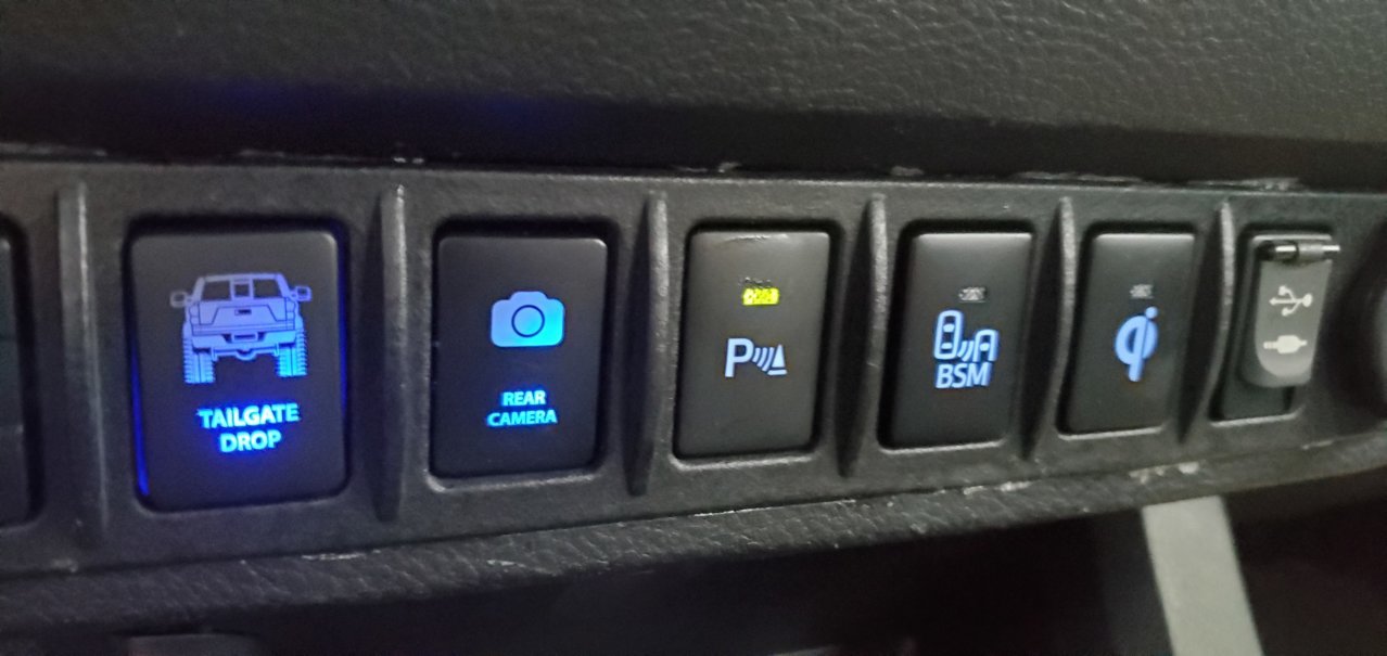

    The Tailgate drop switch is original mictuning (ch4x4) blue. The rear cam is with the 10kohm 475nm led combo i soldered on. Pics don't do it justice.
    This is the only picture I have of the board when I had one of the leds swapped. Blue is the 475nm. And the resistors are the original. Swapped those after this pic. Actually hooked a potentiometer up to try and dial it in, settled on 10k.
