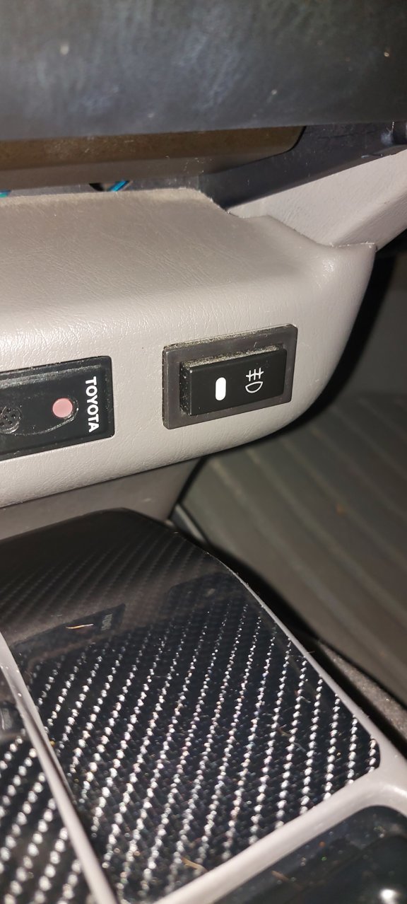

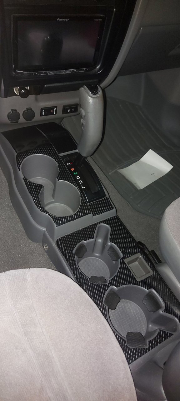

    Carbon fiber kit?
  11. Apr 22, 2021 at 11:35 AM
    SellyKlater
    SellyKlater Well-Known Member
    Feb 8, 2017
    #210037
    753
    Ponce Inlet, Fl
    2004 Tacoma 3.4L Double Cab TRD
    3" ome lift 883. Fnfx pros.

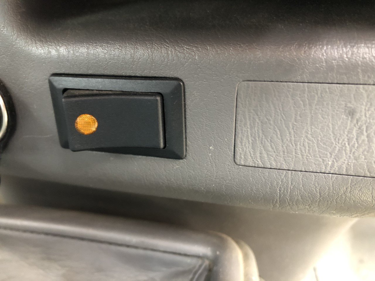

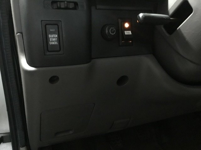

    This is ultimately what I used. Switch from Amazon, Scion OEM style lighted rocker switch. Oznium. I used it for control of my power outlets, like to have the option of either on or off without ignition.
    Thanks for all the replies and insights.
