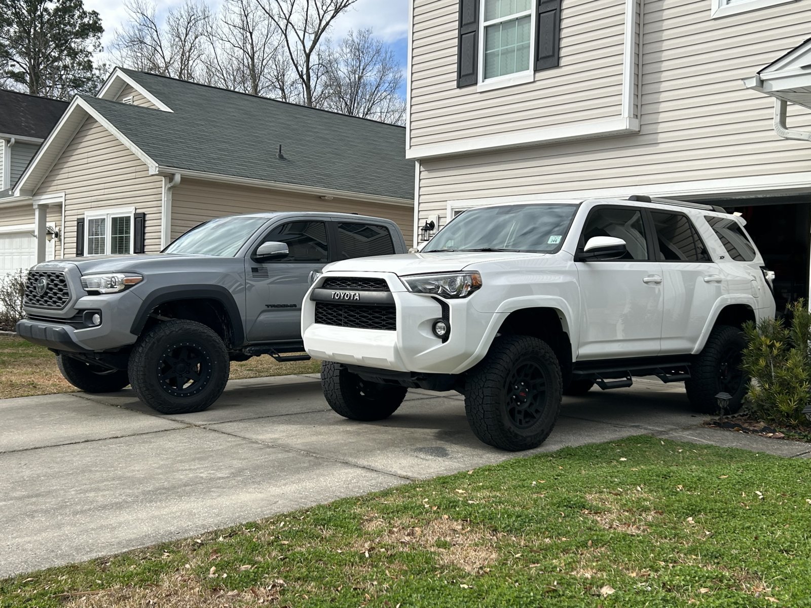

    I bought my daughter a 2019 4Runner a few weeks ago. I love it. I can see why people have both a Tacoma and 4Runner. I need my Tacoma for things like towing the boat and loading the bed up with man duties. But the 4Runner is very comfy. Interior still has grab handles and sunglasses holders. Deeper center console. More room in the back seats. I can see myself buying a 4Runner for myself. It will help keep mileage off my Tacoma too. I average like 35,000 miles a year. So it will be nice to split mileage between two Toyotas.
