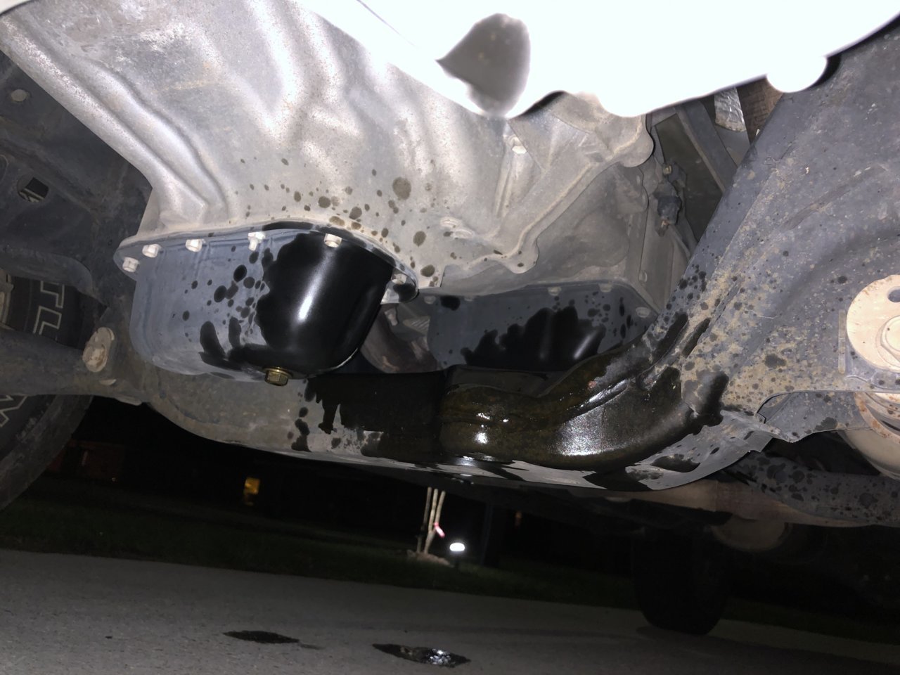

    Decided to go with the Mobil1 High Milage full synthetic... so for no leakage... except for the fact that I didn’t tighten the drain plug as much as I though I did:boom:
