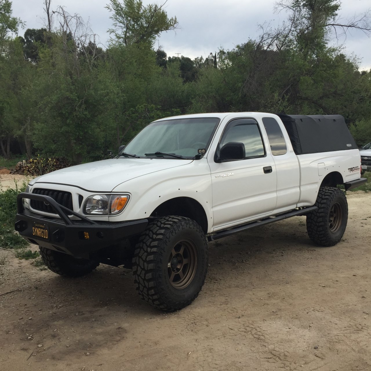

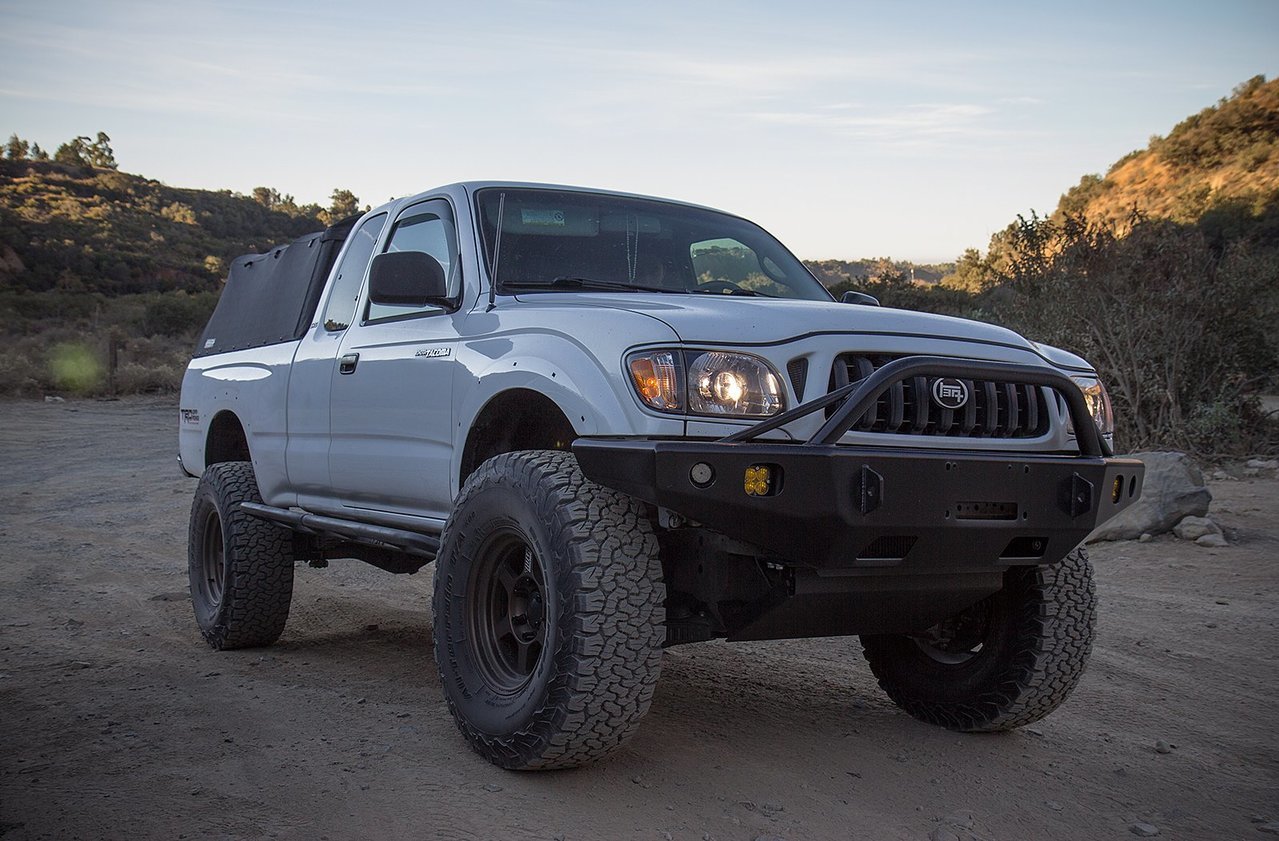

    Current setup:
    With the Wildernest camper on:

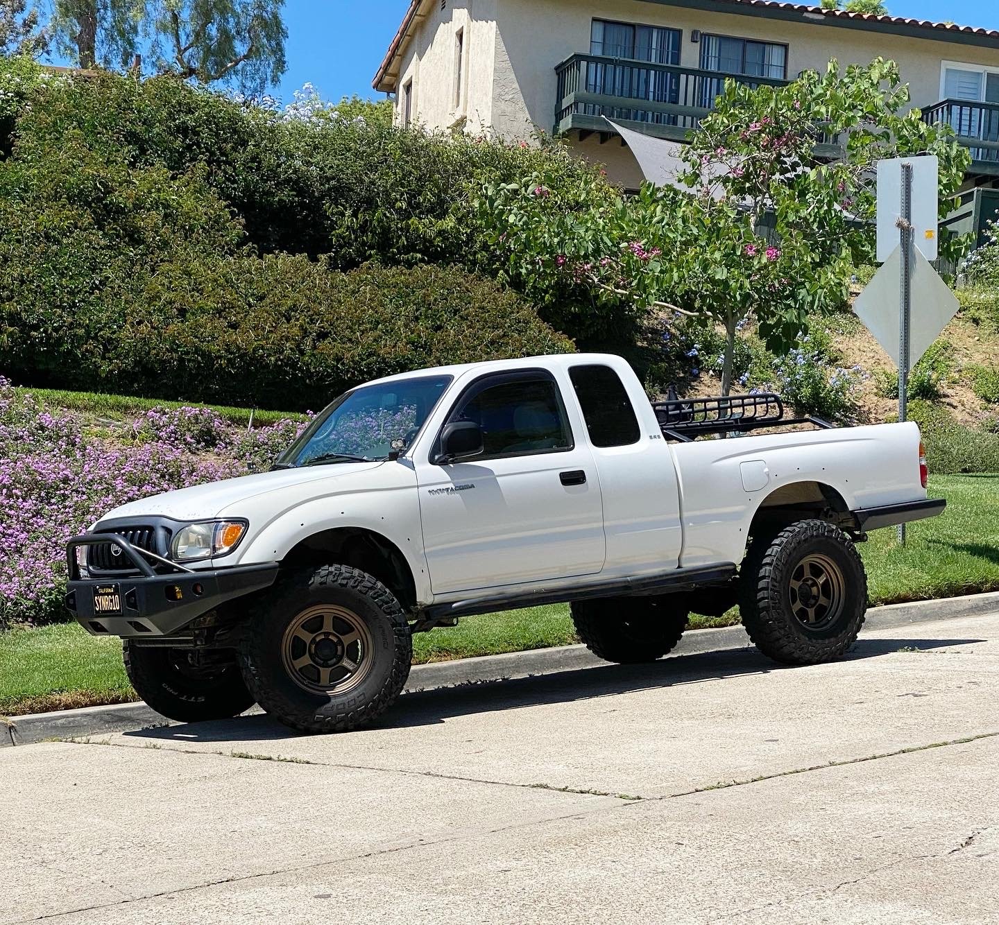

    Went from this (Purchased a double cab in 05/2015 to replace it. Put it back to stock/oem for dad to drive):
    To this (lost in an accident on 11/2017 - https://www.tacomaworld.com/threads/my-2nd-02-taco.424445/):
    Then back to the extra cab:

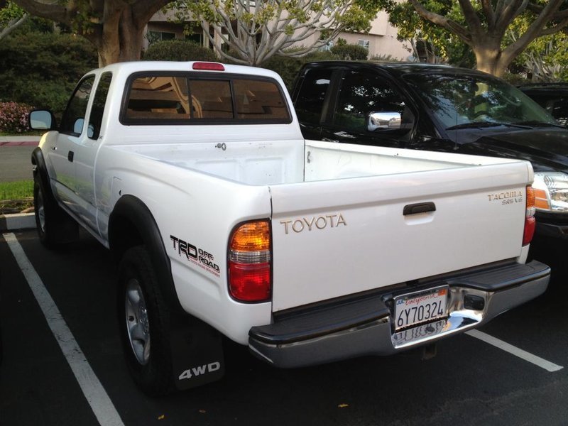

    Back in March I was searching for a truck to replace my 98 CRV as my daily driver and found this 2002 Taco. After some negotiating, I got the deal that I wanted so I jumped on it.
    Mods
    Suspension:
    • Front: ICON 2.5 coilovers, 650lbs
    • Rear: ICON 2.0's with Deaver leaf pack
    • Camburg uniball upper control arms
    • Total Chaos weld-in spindle gussets
    • Total Chaos cam tab gussets
    • Wheelers U bolt flip kit
    • Timbren front and rear bump stops
    • Removed front sway bar
    Armor:
    • BAMF bolt-on sliders with kickouts (ended up welding them on)
    • RAT skid plates (Front/trans/fuel tank skid)
    • BAMF LCA skids
    • Shrockworks front plate bumper (asked them to add hoop support bars)
    • CBI Bushmaster 1.0 rear plate bumper (asked them to build without side protection tubes)
    Lighting:
    • Morimoto Mini H1 HID headlight retrofit
    • TYC Replacement headlights
    • Fog lights: Baja Designs Squadron Sport with amber/wide-cornering lens
    • Ditch lights Baja Designs S2 Sport with clear/wide-cornering lens on CBI ditch light brackets
    • Rigid Ignite used as turn signals
    • Sylvannia LED bulbs all around
    Drivetrain/Wheels/Tires:
    • OEM rear E-locker
    • Total Chaos diff drop
    • 285/75-16 Cooper Discoverer STT Pro M/T
    • 16x8 0 offset Volk TE37X in bronze
    • Tundra 231mm 13WL NAPA calipers, OEM pads/rotors
    • Wheelers Offroad stainless steel brake lines (front & rear)
    • BAMF BPV relocation bracket
    • Grey wire mod
    • Rear diff breather relocation
    Engine/Transmission:
    • AFE dry drop in air filter
    • Airaid intake pipe
    • Removed cruise control (have the part I removed in storage, just need to locate it)
    • SCARAB windshield washer reservoir relocation kit
    • Custom battery tie down
    Exterior:
    • Stubby antenna
    • Weathertech in-channel window visors
    • Removed fender flares (have another set along with clips in storage)
    • OEM bed extender
    • Redline Hood Struts
    • Rago Fab bed stiffeners
    • Factory spare tire mount (in storage as well)
    Interior:

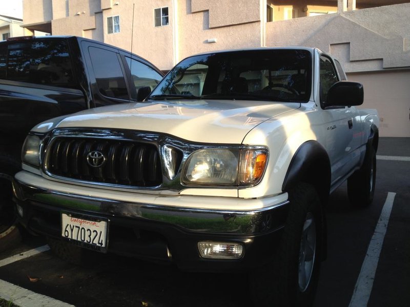

    The day I took my truck home:

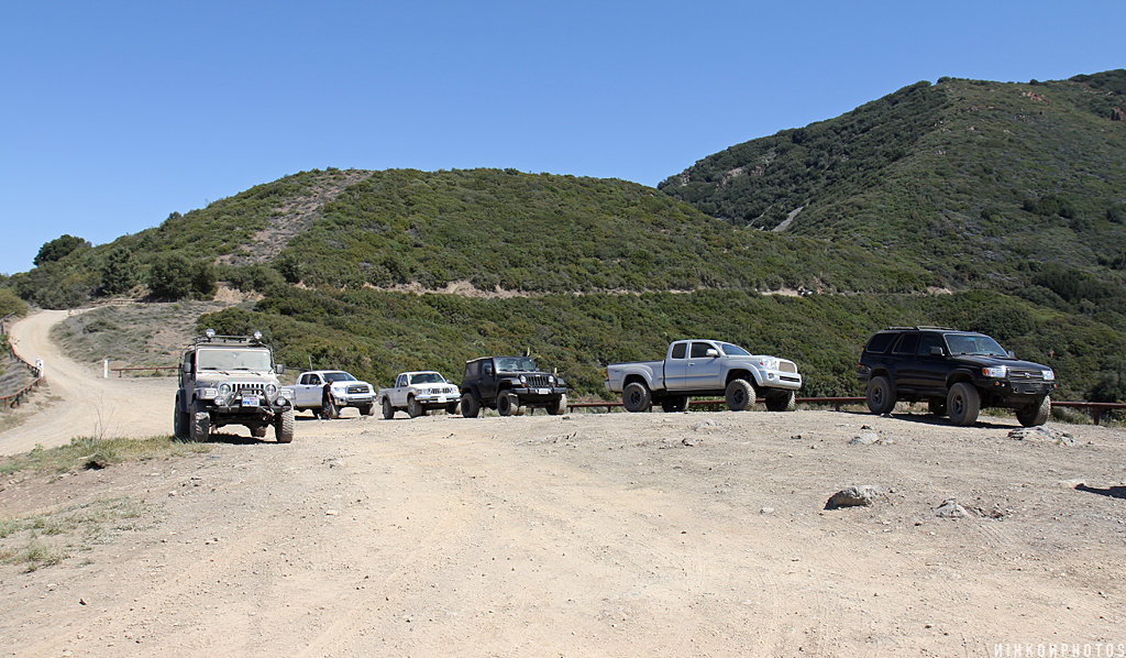

    Within a month I went out on my first "soft" roading trip (taken by my buddy Jason owner of the black 4runner).
    Group shots:

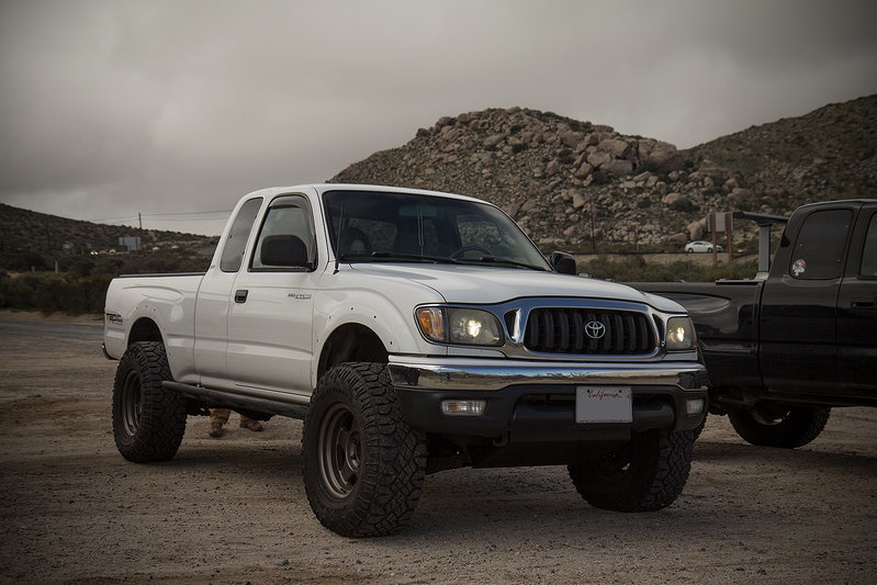

  4. Aug 22, 2013 at 2:43 PM
    synergy10
    synergy10 [OP] @synergy10.sd
    Mar 28, 2013
    #100826
    1,368
    San Diego

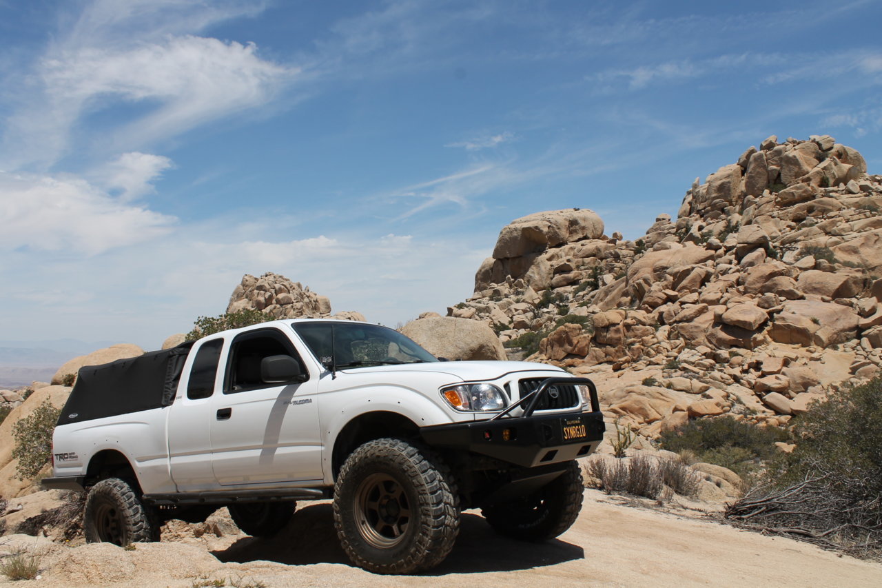

    In the past couple of weeks I was able to get my lift kit, uca's, wheels/tires installed. Really happy with the outcome. Next up, rock sliders.

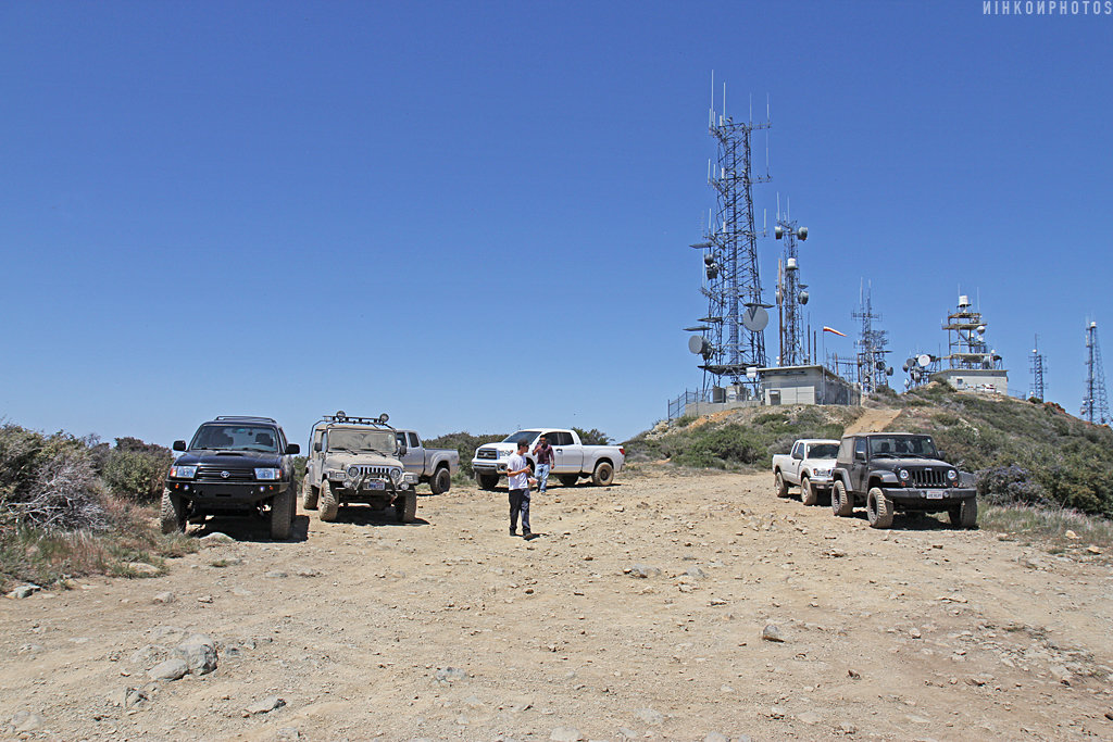

    Looking good man. The group photo at the antenna's - where is that? Im in San Diego too and can't picture where this is...if SD at all.
  10. Nov 6, 2013 at 10:37 AM
    synergy10
    Mar 28, 2013
    #100826
    1,368
    San Diego
    That trip was through Santiago Peak. We started on the Lake Elsinore side then ended up in Orange County.
