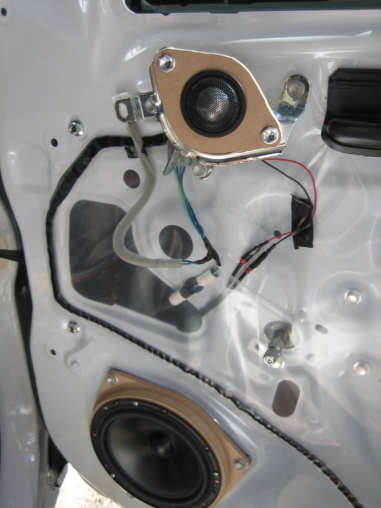

    I just posted almost the same question, but regarding a sub in my 2008 SR5 4x4 Reg Cab and was very disappointed in the response (zero). So, I'll jump out and tell you what I did.
    I didn't need a really high end HU so I bought, on sale, a Kenwood KDC-HD545U. At the time, I did not expect to add an amp right away, but it had nice features that I liked (USB port for Ipod in the front of the unit), HD Radio built in, etc... It was $139 on Crutchfeld, who also provided a free install unit wire harnesses and master sheet on the vehicle. Made it a really easy install. I also found, on Crutchfield, a pair of JL VR525 CSi component speakers on sale for $149. Looked on crutchfield today and they're $299. Again, free wiring harness and free speaker adaptors.
    The issue you'll have w/ the tweeter is that the factory tweeter has a bracket welded to it. So either go to tacotunes.com and order their adaptors, or be prepared to manufacture your own. I traced the factory bracket onto 1/2 plywood, drilled a 1 1/2 in hole for the tweeter, superglued it into the plywood bracket, drill pilot holes in the plywood and ran some short wood screws through the factory tweeter bracket hole. The wiring is confusing, too. It appears that in the factory woofer/tweeter config that a very tinly crossover was on the tweeter so the same colored wires went to both speakers w/out any distinction. So, I traced them back through the wiring boot inside the vehicle and tapped them there since I was going to a crossover anyway and didn't want to put them inside the doors (crossovers are mounted high on the plastic kick panel on either side of the truck).

    Honestly I would try to find one that has at least 3 RCA outs, just in case you want to run rear speakers. Your amp choice sounds good, but just remember that placing the amps under the seats isn't the most ideal location (I speak from experience) they tend to overheat once in awhile down there, but it does hide them and keep them out of the way.
    If your looking for sound quality I would not go with coaxial speakers. The speaker placement in the Tacoma's are pretty decent, and it really helps to have the tweeter farther up in the door for better imaging. The tweeters are not very hard to put in; just buy some MDF adapters from either EBay or Mr. Marv. You shouldn't need to make any adapters. Make sure you specify that they are for a regular cab; we have 6 1/2" round speaker holes vs. the 6X9 type that the Access/Double cabs have. Also if you run amp'd speakers you should run your own speaker wire. Another problem with coaxial is that they run in-line crossovers, like the ones that come stock on our trucks. these usually don't get the job done as well as a full sized crossover.
