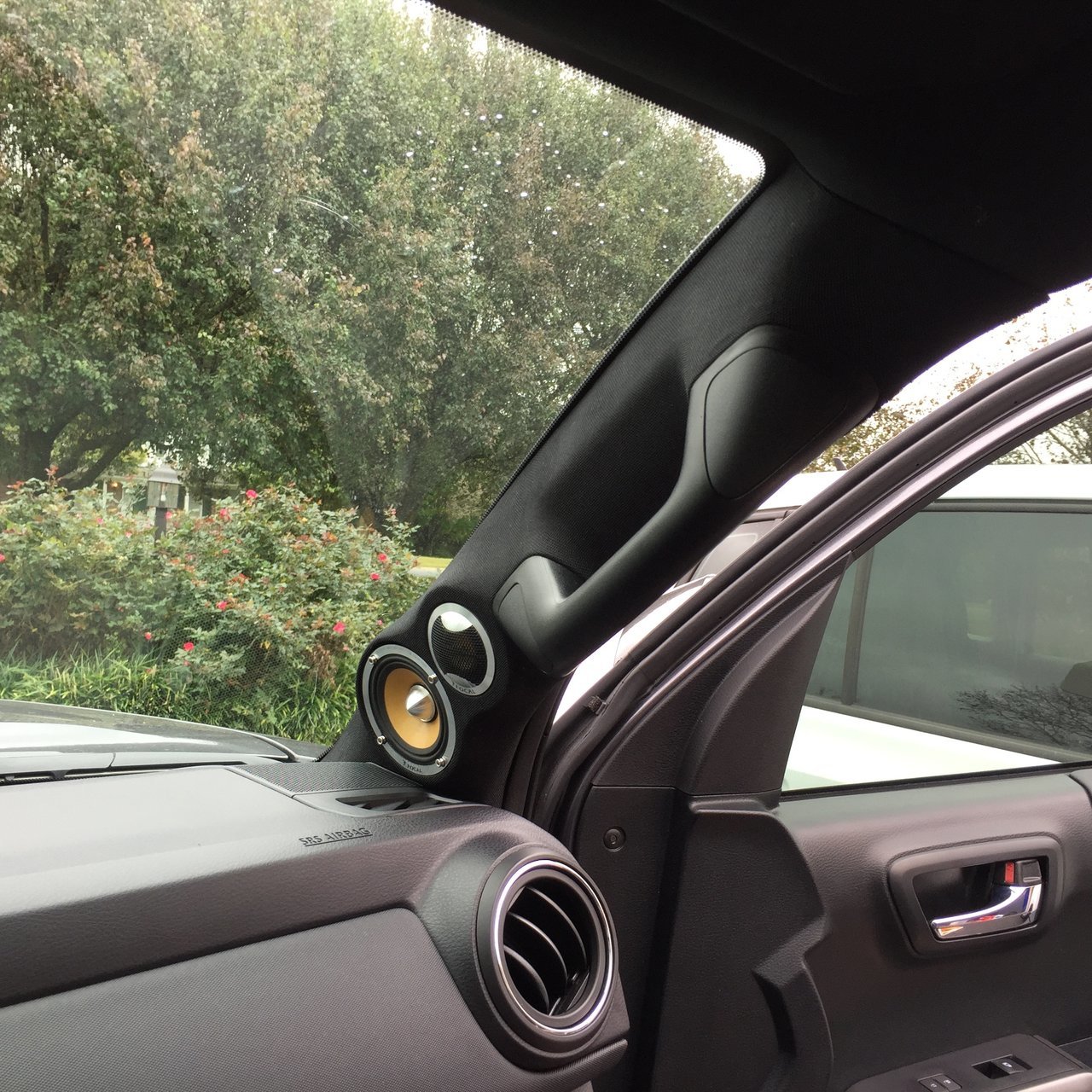

    Pillars stay stationary when airbags deploy. They are bolted in with 10mm bolts. I installed my mid and tweet in the pillars of my 17

    The SR5 stock HU is not the same as what the OP has and many of us have found that the Premium Entunes HU is surprisingly good (for a stock HU). It is relatively powerful and clean which is why so many people are quite satisfied with a simple speakers swap-out (w/ no amps or signal processors). Of course, the stock HU is limited in it's audio controls and it definitely has some EQing happening...but those can be fixed with a signal processor to flatten things out before you amplify it.
    Also, the airbags are not an issue in the a-pillars. Someone else posted it in TW, but the crash test video showed the a-pillar trim staying put when the airbags deploy.

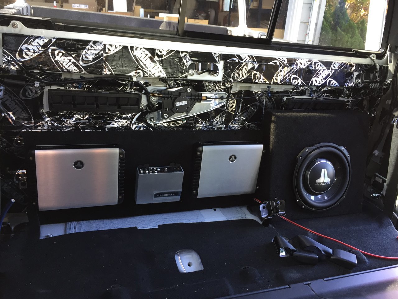

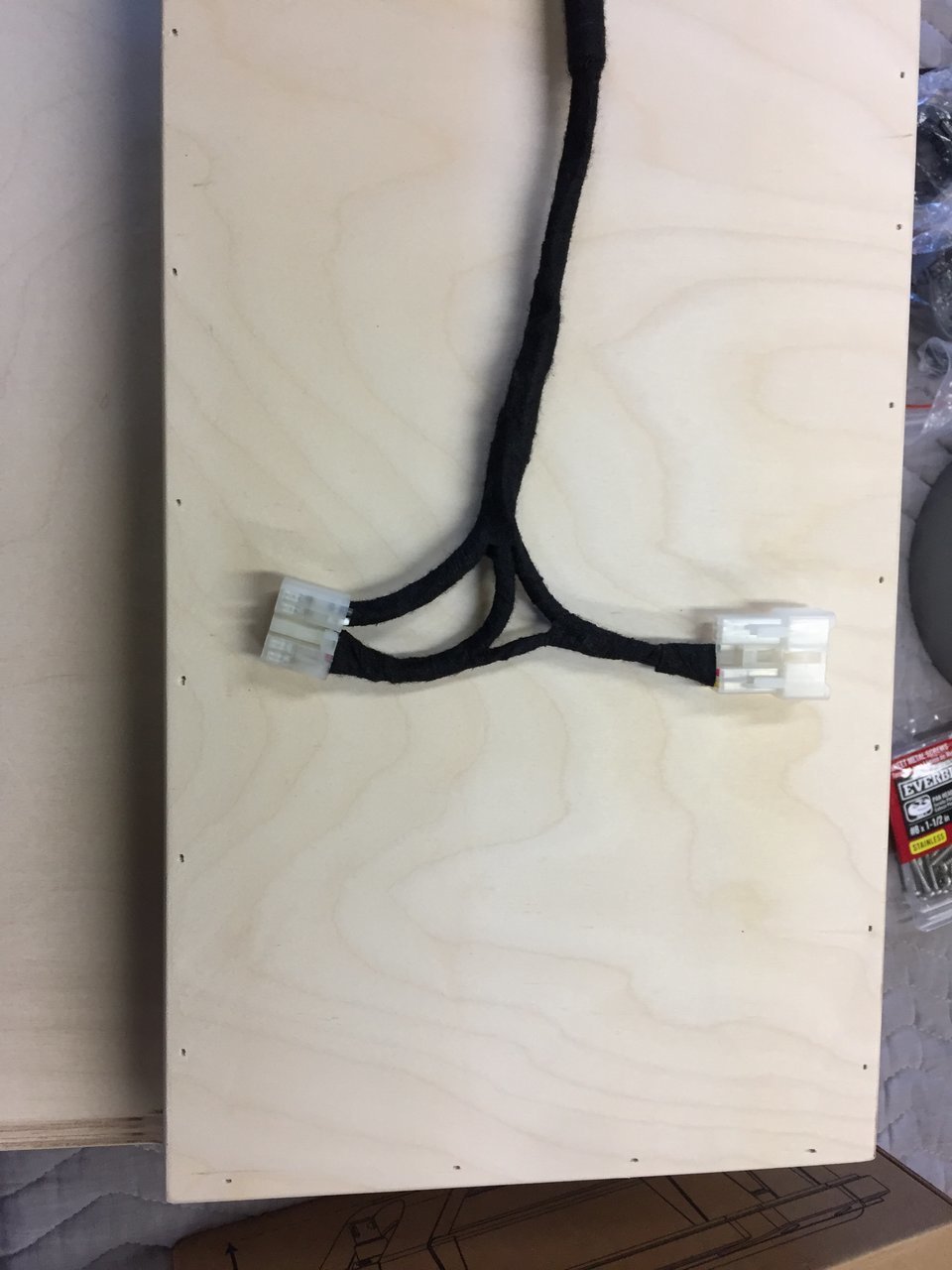

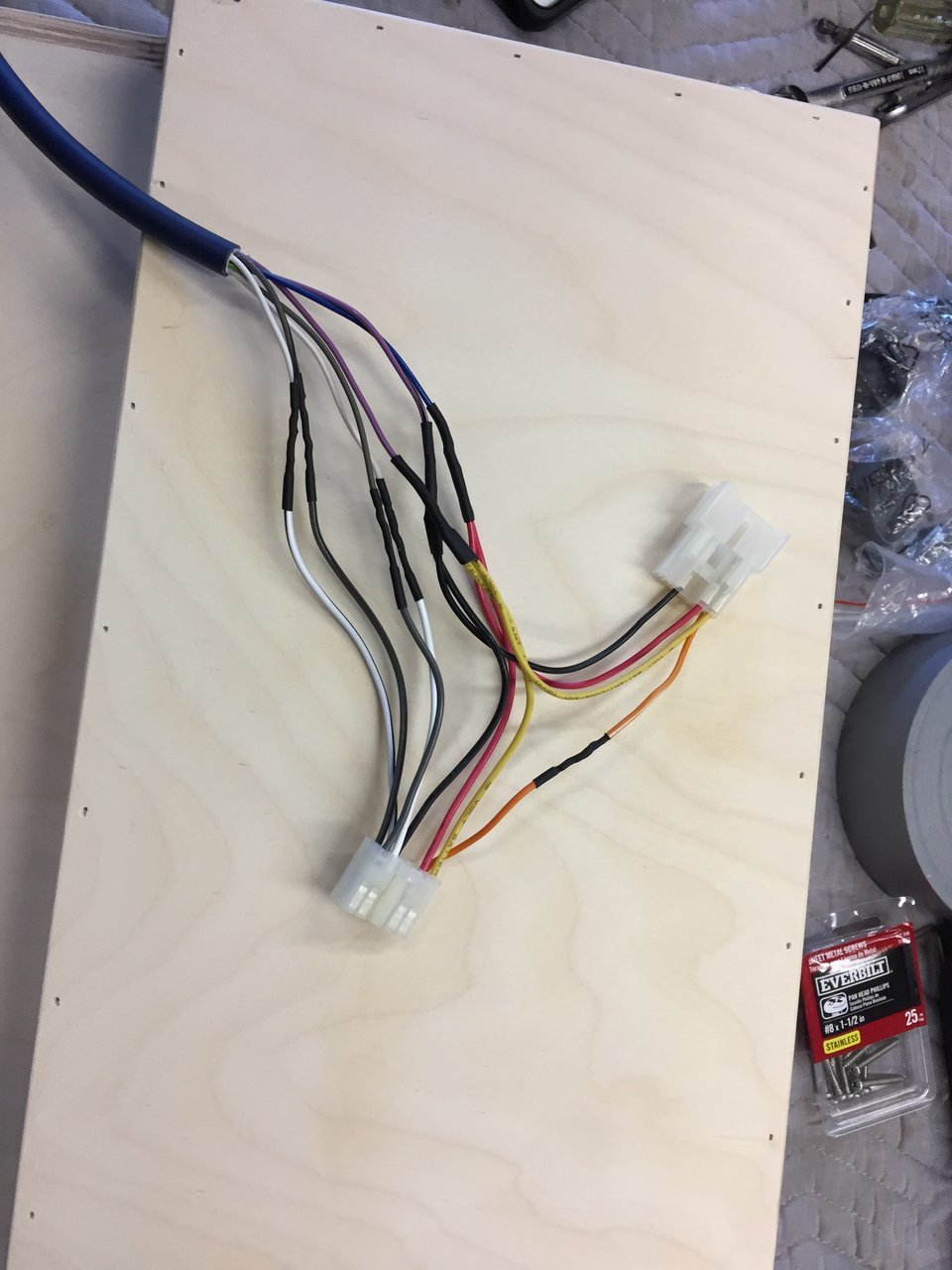

    Well after about 17 hours of labor between Mr. Marv and I we got all the equipment the last weekend , I'm heading down there again tomorrow morning to do some tidying up and tuning, onlt some cross over point have been set so far so I can break in the drivers.Mr. Marv build a nice wiring harness to plug the DSP into the head unit without having to cut any of the OEM wiring so I can return it to stock when is time to trade in
    Which he wrapped up nicely

    Amp rack/subbox/adapters were built from Birch

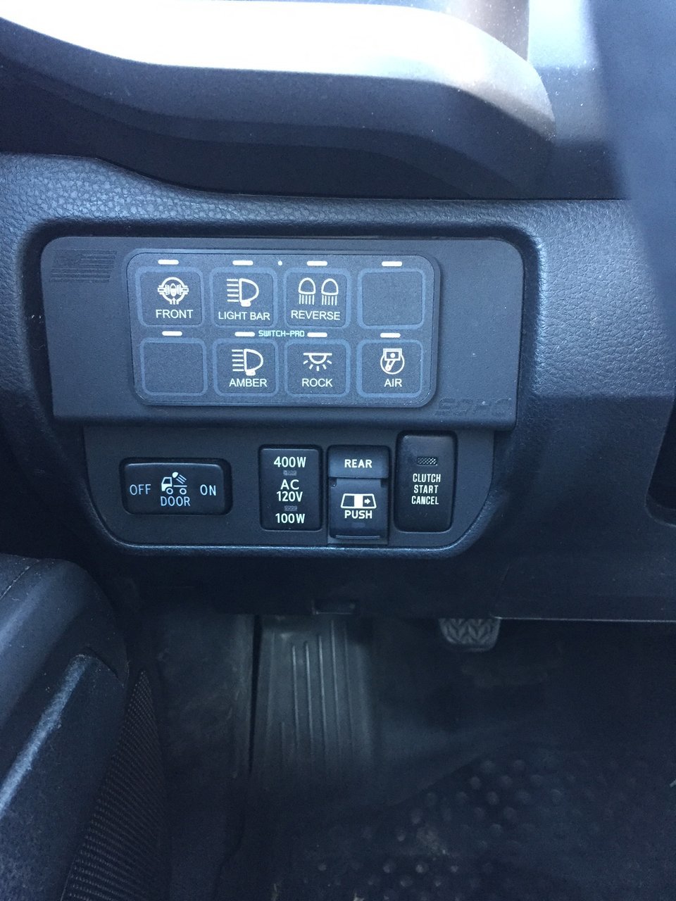

    Controler was installed in sunglasses compartment

    Just wondering if there was a reason you did not put the controller on the left of the steering wheel ?

    Because I have a Switch pro in that spot
