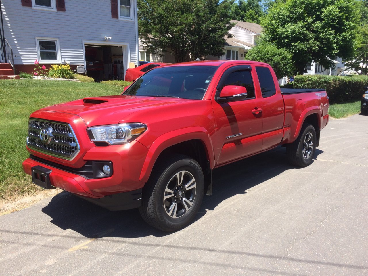

    So, I took my truck in for an oil change, fan motor recall and complained about the transmission. I told them it's terrible to drive in heavy traffic, as it doesn't like to downshift properly. So I pick up the truck tonight and drive it home......WOW what a difference! This is what the truck should have driven like from the beginning. I've read many of the posts about how this update makes such a difference, well all those posts are not kidding! It is SO much better to drive!
