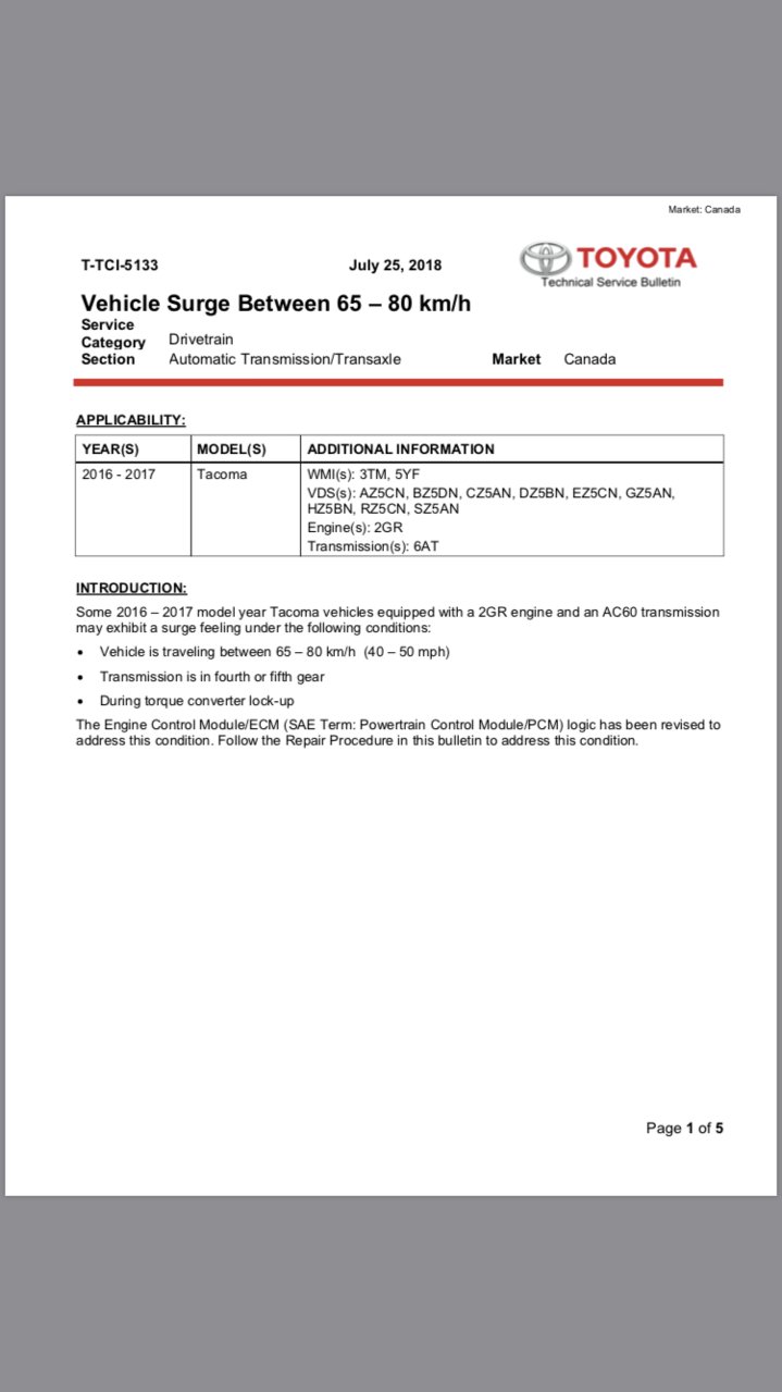

    At the dealership (Not my reg one) getting my alignment and asked them to update the ecu for this.
    I had it printed out and handed it to the tech.Told them about the constant shifting while on the highway or going up hill. No prob we will see if the update is available.

    Is this the first time doing the update?

    Second one for me
    Had one done shortly after buying

    Is this the Canadian version of the recent TSBs to fix stumble, surge, etc?

    Yes

    I printed it out and handed it to the tech
    Myself and asked if they could update the ecu to this update
