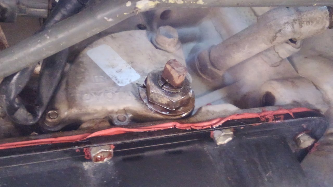

    Anyone know what this is? Right side of transmission above the transmission pan

    That's the sensor that says if it's in park reverse neutral or drive

    Update
    Just changed out the neutral safety switch, which was bad and the seal behind it, all gear lights light up on dash and no more transmission fluid leak behind NSS
