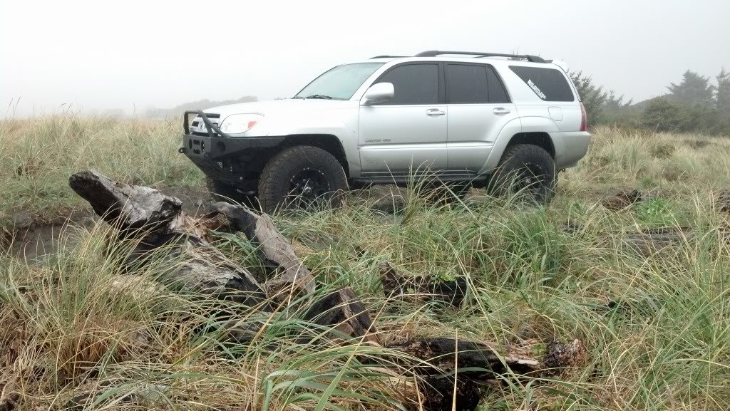

    Pretty much the same places that the 285/75/17 would rub, just a little less drastic.
    -remove mudflaps
    -Body mount chop
    -heavy trimming on the front plastic bumper if you keep it(recommend plate bumper for clearance)
    -inner fender liners at rear of front fender wells
    -pound pinch weld flat.
    and finally if you still rub on compression, possibly a 1" BL or just limit up travel enough to stop the rub.
    Mostly a street queen.... 35's look killer on 2-3" lift on a 4th gen. :D

    I have the mudflaps off already. I'm thinking i should borrow a set for a weekend and see what needs to be done. I want the 285/70/17 but don't want to piss the wife off with trimming the front bumper. I will be getting a bumper soon as well so maybe I should wait until that comes in. I'm looking at shrockworks but I'm liking that one you got there
    EDIT: the bottom part of the bumper (covering bottom of radiator) is that part of the bumper or a skid?
