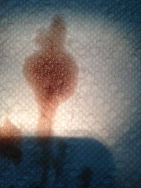

    thanks for the info guys, did the 3rd gen v6's have auto tranny issues?
    dad said that the tranny is slipping and shifting funny, but it doesn't do it all the time, it also has 290,xxx miles on it.

    They have issues with the radiator leaking and coolant mixing with the tranny fluid, called Pink Milkshake... will completely ruin your tranny. Solution is buy a new radiator and/or add an external tranny cooler.
    You might want to check your dad's transmission fluid... post a pic for us.

    i checked it the other day, it was light red, but when i wiped the stick on the paper towel it was pinkish, it was also above the hot mark when the tranny was cold.
    i'll go take a picture for y'all

    the fluid is up to the 3rd notch, the pic is fluid that just got put on the paper towel.
    sorry, not that good of a pic.

    Hard to tell from the pic. Maybe someone else can chime in and give their opinion. Your dad's truck is showing symptoms but I'm no expert. I'd definitely address it though, new radiator. Koyo makes a good one. As for an external tranny cooler, look into a B&M 70264.

    i'll keep a eye on coolant levels, and we're gonna change the tranny fluid sometime soon, so we'll know then.
    it is pretty simple right?
    i'll see if i can find a writeup.

    Yeah tranny cooler install is real easy, and the cooler is only like $60. There's a couple real good write ups on t4r.org but ohhhhh waaiiiit. lol
