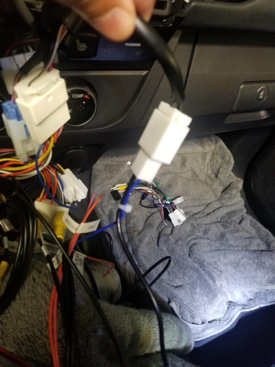

    Never ending......$$$
    Are you getting static when trying to play the radio? I only got static after plugging in the antenna to the back of the radio but there is also a antenna plug that plugs into the antenna harness that I missed. Once I plugged it in, radio worked fine.

    Yes I have the antenna plugged into the deck and the other end plugs into the oem connector. I wonder if I should just wire up my previous antenna adapter and see if that one works. I will just need to splice into power. You would think u would at least hear static if the antenna wasn’t connected properly?

    Jist to be sure we're talking about the same plug, this is the plug I'm talking about that's connected to the antenna plug. I missed it at first because the plug from the factory isnt plugged I to anything and I had the fish down into the dash to find it.
    Fyi, I have the jbl audio system.

    Yes this is the same wire I have. Mine is jbl also and yes mine is plugged in and still have zero sound. Thanks for helping. I’ll probably pull mine this weekend and try my old harness like that and see if anything changes. Thanks
