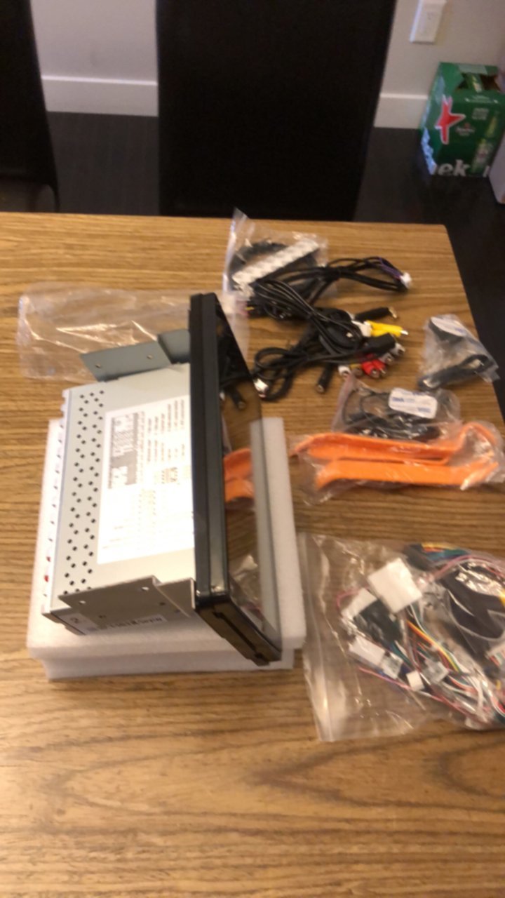

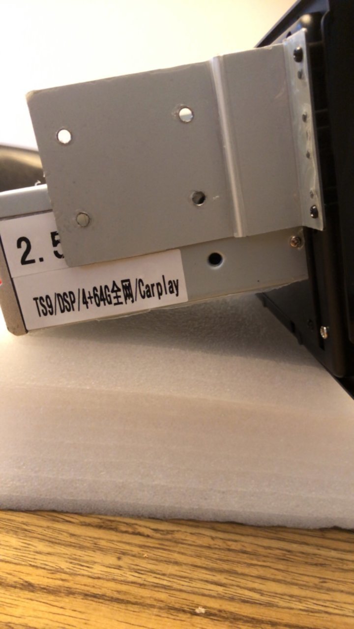

    cruxx
    cruxx [OP] Well-Known Member
    Apr 20, 2017
    #216831
    1,199
    Huy
    2017 TRD Sport
    9CA3BA8D-469C-4460-98F9-ABAF6DE2FE27.jpg 37F509FF-86F1-4656-9EA3-F9B323F0340E.jpg
    Its possible you got the wrong bracket. Mine lined up perfectly. The headunit had a bracket built into it that lined up. Where did u get it from??
  11. Jul 3, 2020 at 9:08 PM
    #51
    AFMurse2014
    AFMurse2014 Death Can Wait
    Nov 15, 2015
    #169730
    2,050
    Devin
    San Antonio
    2016 MGM Double Cab TRD OFF ROAD 6 Speed MANUAL
    Freedom, American flags and ISIS blood Morimoto 35w 5500k HID/ LED highs from TRS. RCI expo rack Core Short throw shifter, hypertech speedo recalibrator. Rear seat molle panel. OVT. PnP 2LM. C4 Hybrid Bumper w/ amber BD squadron pods. 33 pizza cutters. T9 radio
    Cartrimhome, yea those brackets didn't line up at all. I took them off, and drilled my factory brackets. It was so close to being perfect alignment. With some tweaking it'll be perfect.

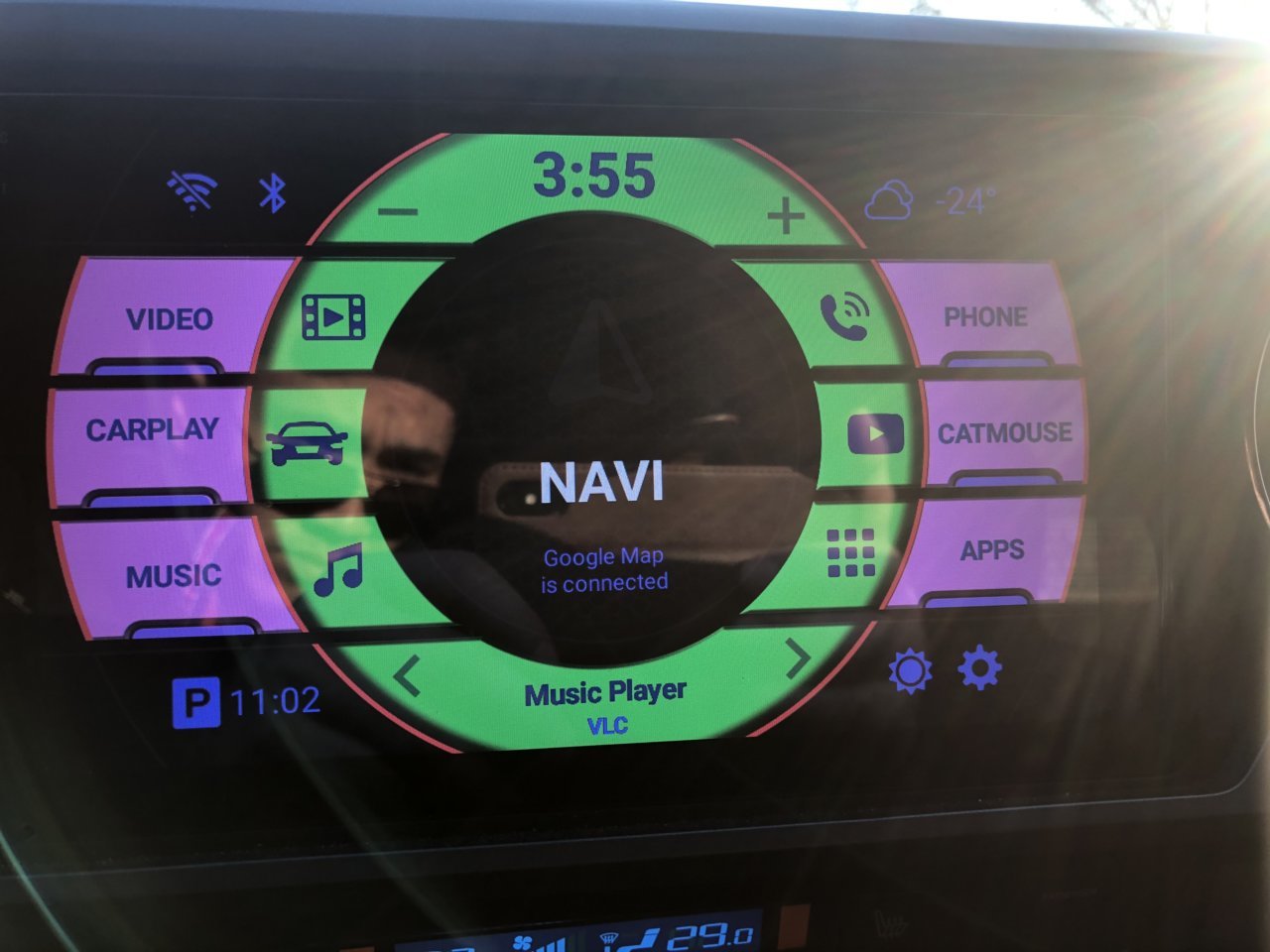

    TK-422
    TK-422 Toyota! Oh what a feeling.
    Apr 2, 2016
    #183071
    2,346
    So Cal - SCV
    2015 4Runner TEP
    Toytech 2.5 lift BFG KO2 275-70-17
    That is the cleanest agama screenshot I have seen. I like it. I will install it soon.
    I have the 4Runner version of the T9. So far it is great. It cost a little more because it has the full bezel to replace the stock one. Other than that they should be the same.

  19. Jul 11, 2020 at 11:35 PM
    #59
    TK-422
    Apr 2, 2016
    #183071
    2,346
    So Cal - SCV
    2015 4Runner TEP
    I got my AGAMA on and liking it.
    I need reading glasses but don't wear them when driving so the google maps is hard to read. I installed Sygic maps this morning and so far it's much better.
    When driving it's like a garmin GPS
    When still it switches to a normal map view.
    I paid $7 for the navigation add-on. I believe the full blown version is $26
    I also installed Firefox with Ghosterly and Adaware add-ins. I'm not a fan of Chrome.
