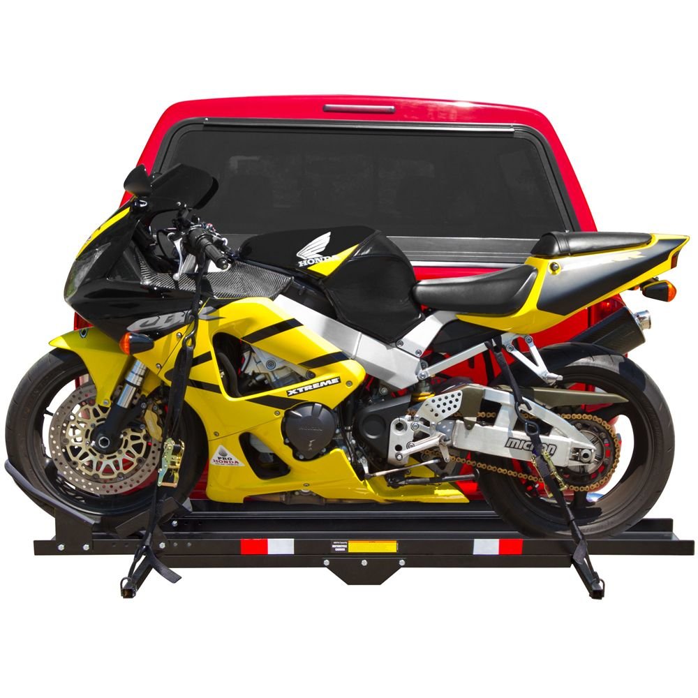

    Could put one of these on and have a normal camper shell.

    Motorcycle leaves a lot to interpretation they come in all sizes. I think the soft topper as mentioned above may be a good solution but may not be tall enough. The hitch mount bike carrier above works for lighter machines but can be downright dangerous with street bikes or heavier machines.

    I have seen many use the “heavier” tongue mounted carriers but in my mind they are dangerous. The longer you make the tongue to give clearance to the truck the more strain you put on the truck. My RC51 has to weigh double that of a dirt bike. Since it needs more clearance to the truck and therefore a longer tongue the weight could multiply to 3 times the dirt bike in terms of stress on the hitch / frame. I know a local guy with his RC on one of these mounted on a Cherokee and it scared the hell out of me. Now if I custom made one for a one ton truck I am sure it could be made heavy enough and the hitch braced enough to be safe knowing the truck itself could handle the big lever and weight that far back. But we are talking a Tacoma and that is a lot of weight on a big lever. We need more info from the OP on the bike and it’s dimensions and weight so we aren’t guessing and filling in blanks that may not be relevant.

    Like I have said I am not a fan of tongue mounted carriers unless for light dirt bikes.
    I have argued with guys who road race and don’t have a place to store a trailer. I heard about a guy who destroyed his bike when his hitch broke off the frame from the weight and long lever. Now I did a quick check and 3rd gens have a 640lb tongue capacity with tow package hitch. So take your ball mount and now compare that distance to the center of gravity of one of these hitch mounted carriers. My impression is you will exceed that weight easily with a sport bike. The distance and leverage are the killers on this design. The carrier may be strong enough but the leverage is what makes them dangerous.
    (EDIT)
    One thing many forget is the safety factor vs breaking strength. For example the same cable that lifts a load on a crane has a safety factor of 5 times the breaking strength iirc and has a SF of 10 times the breaking strength if used to lift PEOPLE. So in essence it is rated for half when lifting people.
    So in the case if these carriers they might not break but they may be exceeding the safety factor of the design which over time could cause a disastrous failure. So one day it breaks and the motorcyclist behind you gets killed by your motorcycle or that family swerved into the ditch and everyone dies. Guess who is liable? Here in Ontario Canada the MTO (Ministry if Transportation for Ontario] have no design department for trailers and carriers such as this. But in the event of a failure your setup will be deemed to be unsafe or overloaded and both the operator of the vehicle and the manufacturer will be held liable. Now if the manufacturer rated it lower than your motorcycle you are 100% liable. If Toyota were named and they can prove your leverage exceeds their rating they are off the hook and once again you take 100% liability.

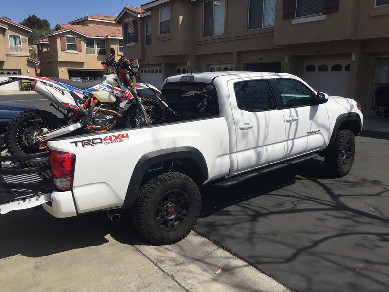

    I've been trucking and riding all my life. Whatever you do will be a compromise. I had the shell and used a MotoJack & trailer on my Gen 2, but on my Gen 3, I've held off on the trailer and so far think I made the right decision.

    ^^This. Hitch carriers are a dumb invention. The receiver hitch was never designed to haul weight like that on an extended lever arm that puts a bending moment in to the structure. With the designs I have seen you would at least double the load on your hitch as compared to the weight on the carrier. Meaning if you have a 600lb hitch, you should be putting 300lbs or less on one. I wouldn't put anything but a light dirt bike on one, and it would need to be a full size truck at minimum. All that weight behind the rear axle. Hard on the frame, hard on the suspension, screws up the weight distribution of the vehicle. Very very bad idea. Yes, many people get by with them, but in the bed or on a trailer are the best solutions.
