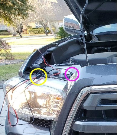

    Higher up is almost certainly better... it should allow for a wider (side-to-side) view. But on my stock 2017 Limited grille I really didn't have a lot of choice in the matter if I wanted to stay centered. And my experiments with "test" mounting positions convinced me that centering the camera was the right thing to do.
    Back to my earlier comments about pulling the camera cable through the firewall . . .
    I'm not sure what camera you will have, but with the Natika cable the hardest part to get through the firewall was the "junction" part circled in yellow in this picture. The 4-pin connector I had mentioned is circled in violet. Obviously this picture was taken before I actually pulled the wire through the firewall.

    I have to see exactly what camera came with the Taco Garage Kit. The camera has a lead coming off the back of the camera and the end of that lead has a "quick connect" that is roughly 3/8" thick... once i pass that through, it seems i connect the other lead to the camera lead i passed through the firewall. its a two piece lead in its entirety. I'll lube it up with some teflon spray or something... I'll break open the box on my lunch break and take photos. I'm sure this thing is a lot simpler than i'm imagining it hahahah

    That's interesting. The Natika has about four or five feet of cable attached directly to the camera. That ends in a round 4-pin female tubular connector about 3/8" diameter and maybe 1.5" long. Then there is the other cable that begins with a male 4-pin tubular connector that plugs into that female connector. About 18" back from that end is the "junction" that splits out 12VDC red and black wires to use if req'd. Then there's about another 20' or so of cable length ending in the RCA connector and trigger wire. Most of this 20' of cable ends up in a coil inside of the cabin. I have my 4-pin to 4-pin connection located alongside the washer fluid reservoir.
