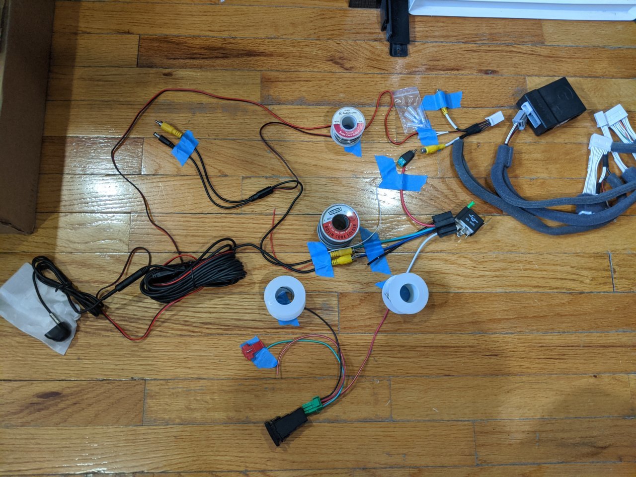

    Actually, I think I got it. I will tap off existing self added switch for switch power, and solder the ground to an existing ground as well. The rest will be as follows:
    Everywhere there is a spool will be a solder and heat shrink location. Anyone have any critiques?

    After cutting and splicing all the RCA camera cables and some testing with a 9V battery, it seems to work. Next step is to wait for the weekend so I can wire it all up in the truck for actual testing.

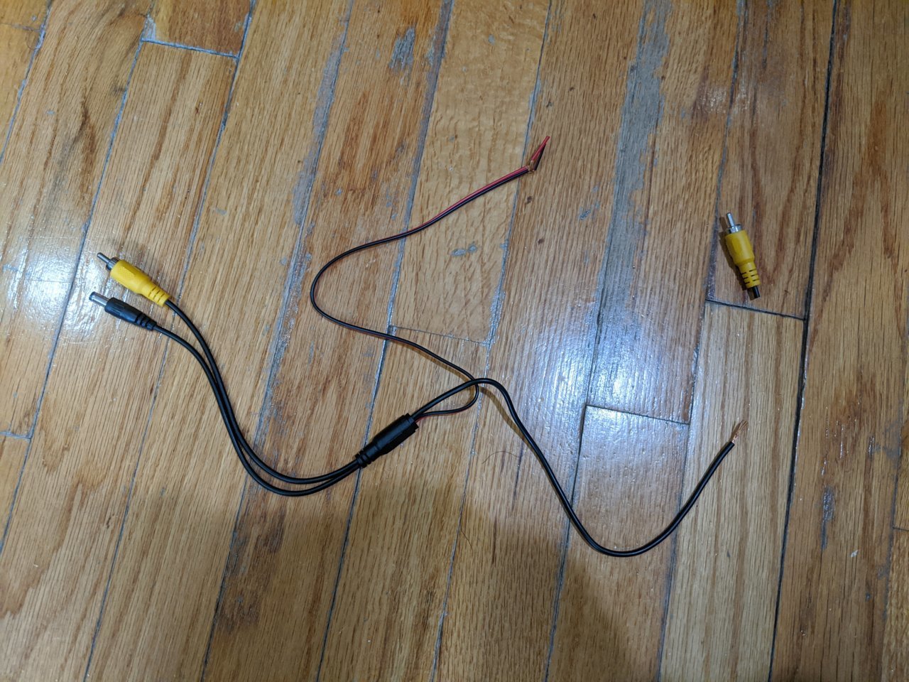

    Cutting apart an old RCA cable to see what it does.

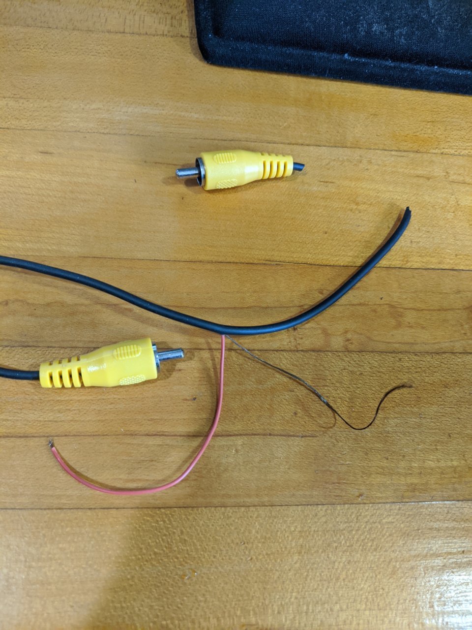

    Cutting apart the Echomaster wire

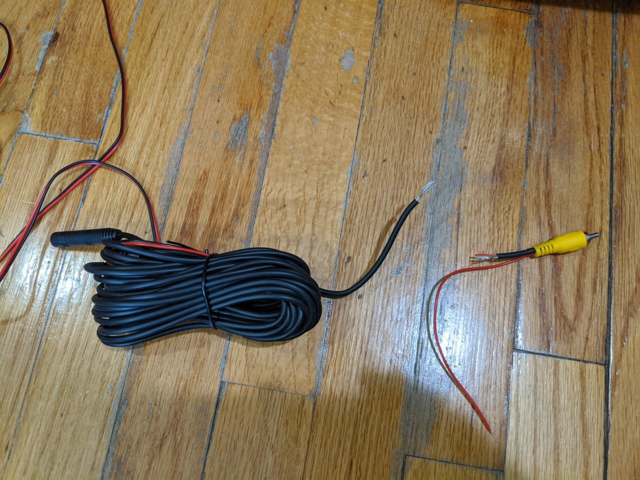

    Cutting apart the Natika wire

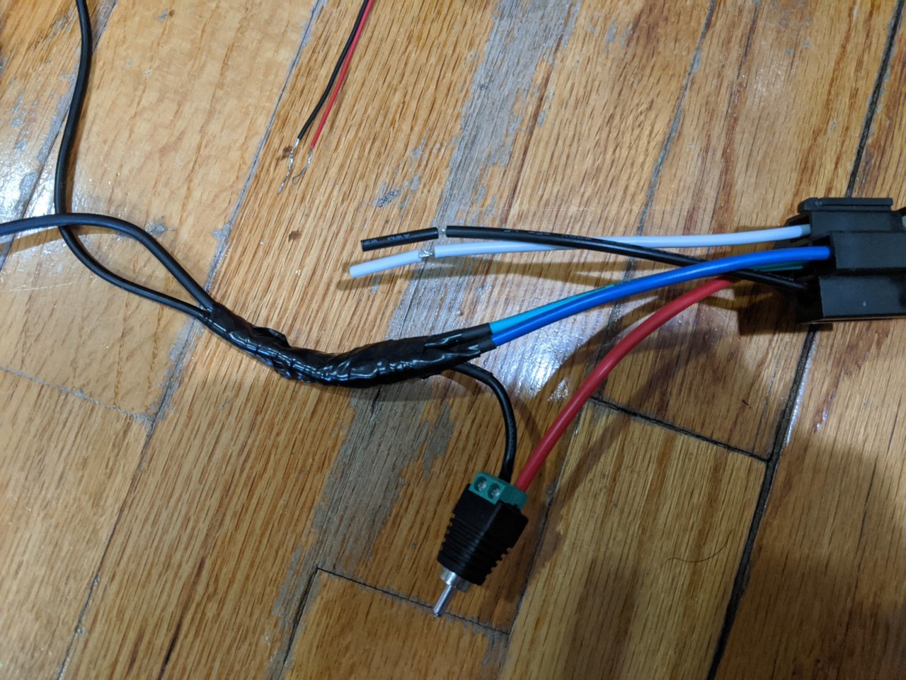

    Hooking up one of the RCA to the relay latches
    Hooked up both RCA signals to the relay latches and combined the ground/returns together. Did a connectivity test on the signal and returns with the relay on and off via 9V battery. All works so far.
    List of things remaining to do:
    -Hook up switch for relay (splice to existing non -OEM wire for power. Solder ground to existing non OEM wire. And switch to relay)
    -Ground relay (maybe solder to existing non OEM ground if I'm lazy)
    -Plug it all in and hope it works...
