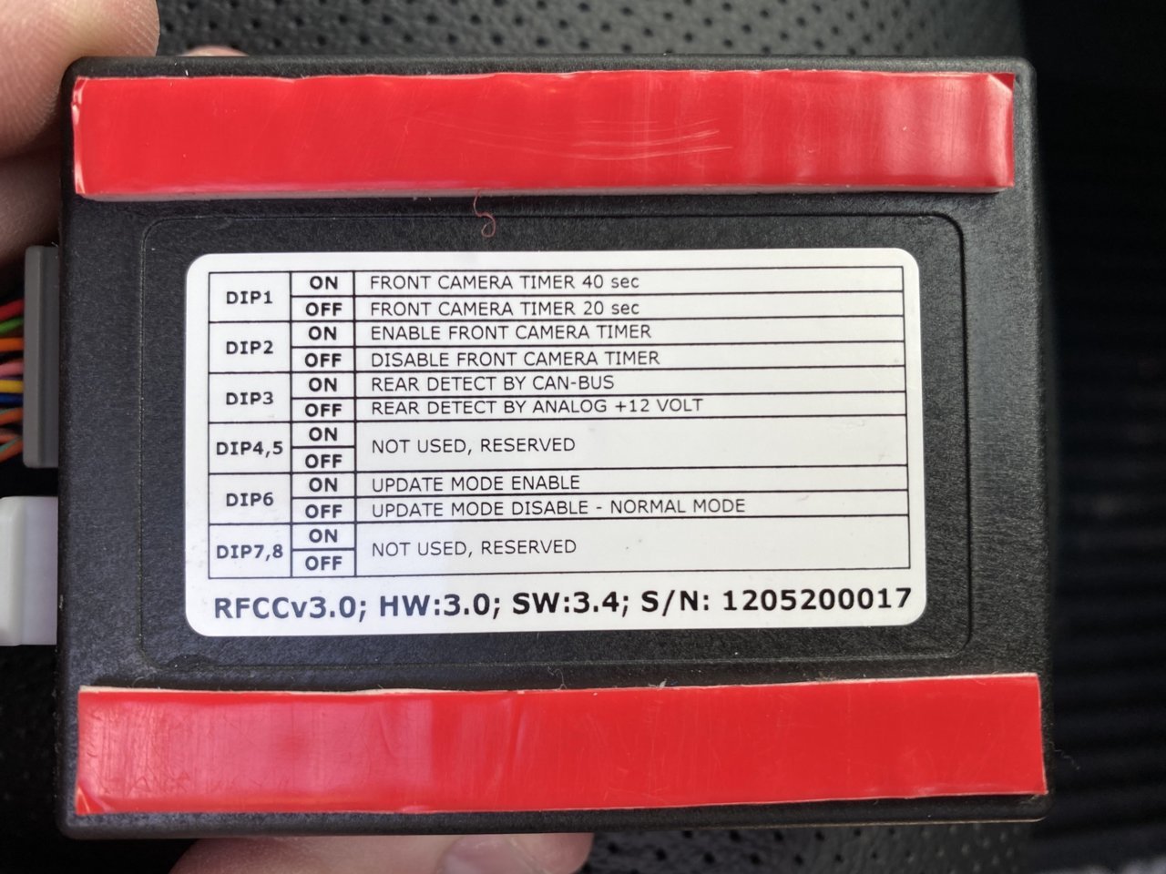

    Yes, with everything factory connected (germes box and cabling completely disconnected) the rear camera works fine. I emailed and texted The Taco Garage and they did respond to my email and said “Hi, Thanks for reaching out,

    Since you have a 2020... have you confirmed that the DIP switch settings are correct?

    I tried different switch settings with no success. If you have a specific switch configuration to try, I’ll try it. The only one that looked like it would have any effect was 3 and that made no difference. The rest are labeled not used for the most part. I would have to look again but if I recall only 1-4 actually had any purpose according to the sticker on the controller.

    AFAIK yes. I don't have any problems with the default DIP switch settings.
    This thing was plug and play for me. No knock on Taco guy or anything. I just bought the Germes right from the MFG.

    IIRC the first 2 dip switches are on, the last four are off.

    The way it shipped was first 3 switches on and the rest off. That is how I initially had the switches on first power up as well as many others. I just don’t see what other switch beyond 3 that would cause the rear camera not to display (I tried powering up with switch 3 in both positions). Since I have no camera image regardless of the position of switch 3, that makes me think the controller is just malfunctioning. I don’t even see the screen flash when I change inputs (placing the truck in drive, reverse or using the mode button). It’s as if the head unit does not see the controller at all.

    Your issue may not have anything to do with the switches. I simply asked the question since the switches are there on the device, and one or more could have been inadvertently changed. Aside from that if all of your connectors are firmly seated and you have no front or rear camera display, then the unit may well be defective. :annoyed:

    "Got installed. Works perfectly. Dip switch one and two on all the other switches off."

    I’m not sure if this “(I tried powering up with switch 3 in both positions)” was understood the way I meant it. I meant I had switches 1,2,3 all on and the rest off, and when that didn’t work, I set switches 1 & 2 on and all others off. Even disconnected the battery in between and still no luck. It’s not a huge deal. The Taco Garage seems to think it’s a bad unit, so I will wait for the return process to complete and try with the replacement unit. If I’m doing something stupid, it should reveal itself if I fail in the same way.

    Like you, my unit was sent to me with the first 3 dips set to the on position and all others to off. I initially set the 3rd to the off position and installed (with battery disconnected). All worked fine but I later set dip 1 to off, 40 secs was too long for me.

    I completely understood what you meant. But I also remembered seeing someone else's post with almost the exact same symptoms. I searched until I found @CP40's post. I recall as well that CP40 also thought he had a defective unit, but it turned out not to be the case.
    Why did your rear camera work intermittently and with lines through it? Maybe one of the connectors was not fully seated on the initial install, and then after you reseated the rear camera acted exactly like CP40's.
