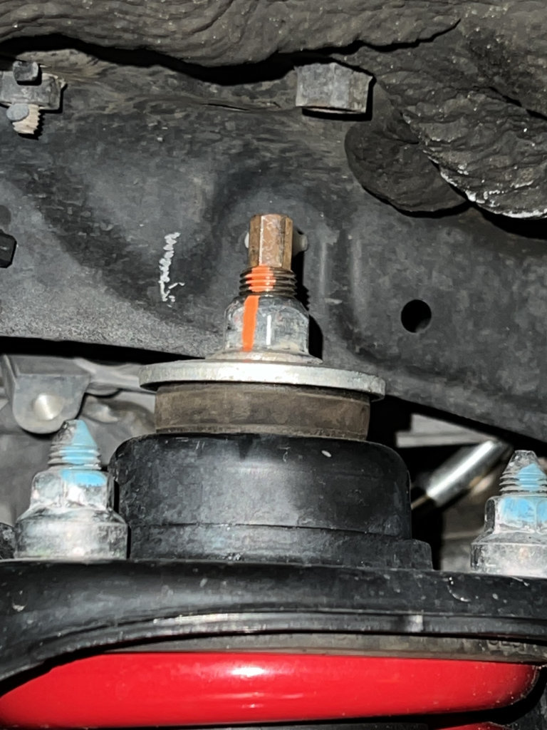

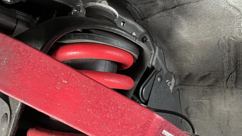

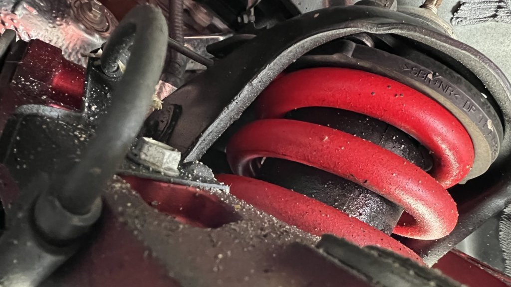

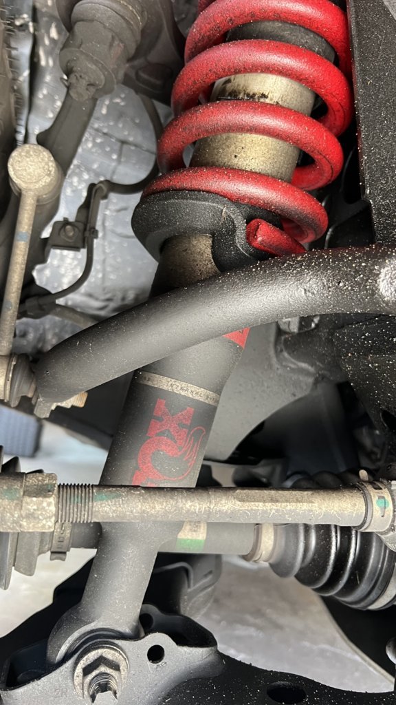

    Anyone else get a slight clunk in the front end while making a slow turn. Happens when the front suspension slightly drops/dips during the turn. I have a '23 Pro.

    Also, did you get the updated springs for the newer years? Apparently the original one's they released that didn't have the flat tops were causing noise/wear issues. They updated the springs which made the top of the spring flat and that apparently fixed the issue. If you have rounded spring tops, you most likely have the previous version which caused these types of issues. The only sound I get is from my quick disconnects as dfanonymous asked about.

    I’ll have to go and have the dealer look at them. Here are some pictures. I can’t tell just by looking.

    Check your CV boots, specially the outer, closer to the wheel hub.
    Listen when the clunk happens while making a left or right turn:
    When making a left turn, more load is on the right front.
    Right turn, more load on the left front.

    What's that oily looking substance on your strut/spring?

    Fluid film
