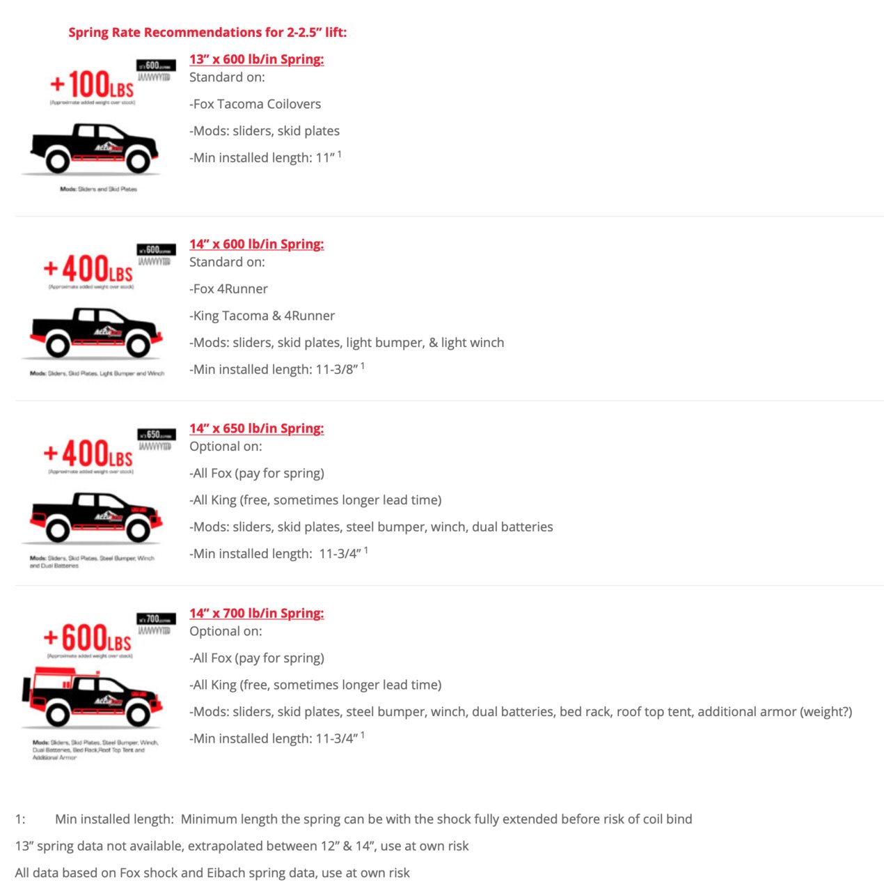

    Will PRO springs fit a stock OR? I may be interested in buying used PRO springs to reduce brake dive on my OR.
    Also, does anyone know what the OR and PRO are rated for? My guess is 600 - 650lbs for the OR and 700-750 lbs for the PRO.
  15. Jan 13, 2020 at 2:47 PM
    #175
    TuRDLYFE
    TuRDLYFE Well-Known Member
    Nov 9, 2019
    #310230
    1,501
    An over-taxed town, county, and state
    2020 AG TRD Pro 6MT
    No, they won't. Different suspension manufacturers. I feel like you've asked this before haha
    Nose Dive
    I can't find any stock ratings for 3rd gens, but the second gens are like 540# up front. The Eibach springs are like 600-620#. No visible stamped rating on my Fox.

    I've asked questions about springs, but not specifically whether they PROs would fit. Also never got an answer on the ratings :s
    Oh well. I'll have to look elsewhere. Thanks for the help!

    That make sense. I'll try to find some 700s and see what that gets me. I have so many little projects on the go with this truck. May start a build thread, but I'm too lazy to document stuff. lol

    I think this may be what you need, but not what you were asking for, per se.

    Our non-PRO spring that works with our shocks or Bilstein 5100's is 742lbs. Go with that. Eliminates all brake dive.
