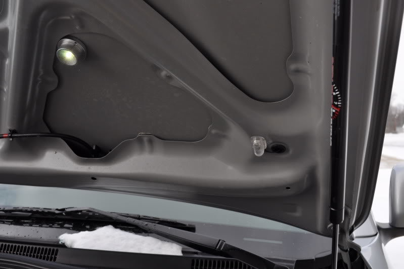

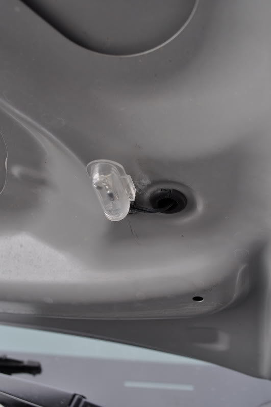

    How did you mount the LEDs to the hood? And where did you run the wires? Looks great! Adding the LEDs and hood struts to my ever-growing list...

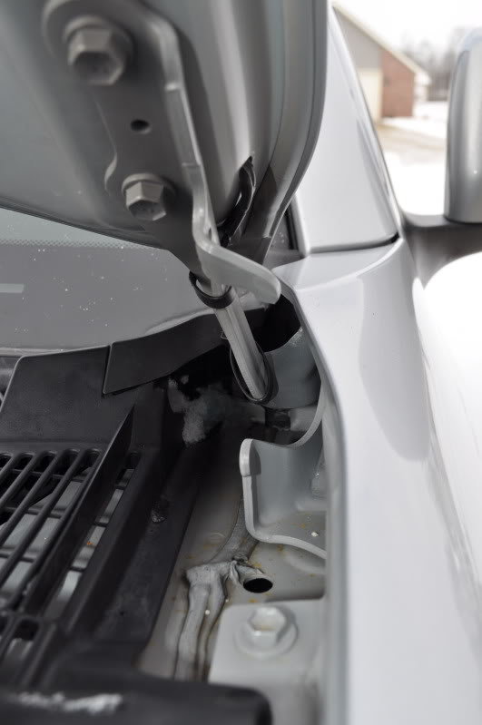

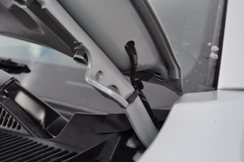

    ^ I used some good 3M double sided tape. The wires run through the supports on the bottom of the hood. I then drilled a small hose on the driver's side of the hood, so the wires can come out of the hood and run along the hinge into the engine bay. You just have to be careful not to allow the wires to get pinched when the hood is opened and closed.
    I recently picked up a mercury switch for the lights and will post up pictures once its installed.

    Finally got my mercury switch put in for the underhood lights.
    How the wires are run:

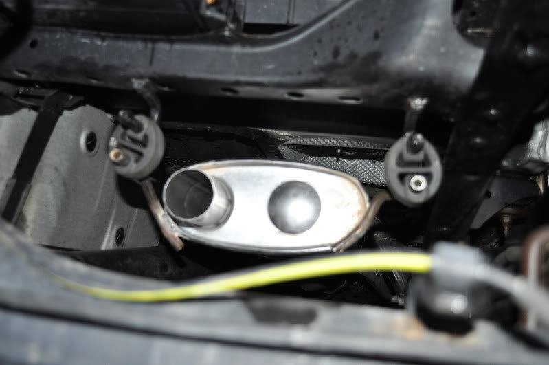

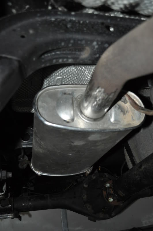

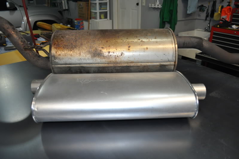

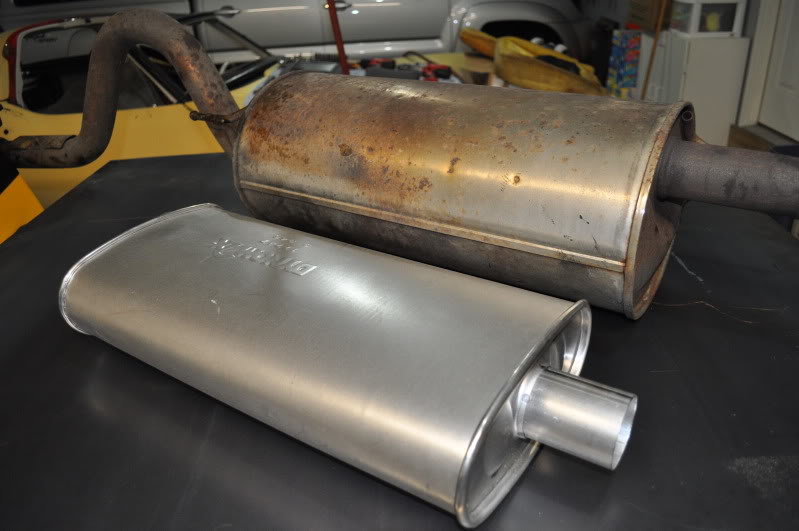

    Added a Dynomax muffler. Went with the 17747 and installed myself. Still need to put a turn down on it later. Overall, the sound is great. Definately not stock, but not too loud either. I'm satisfied.

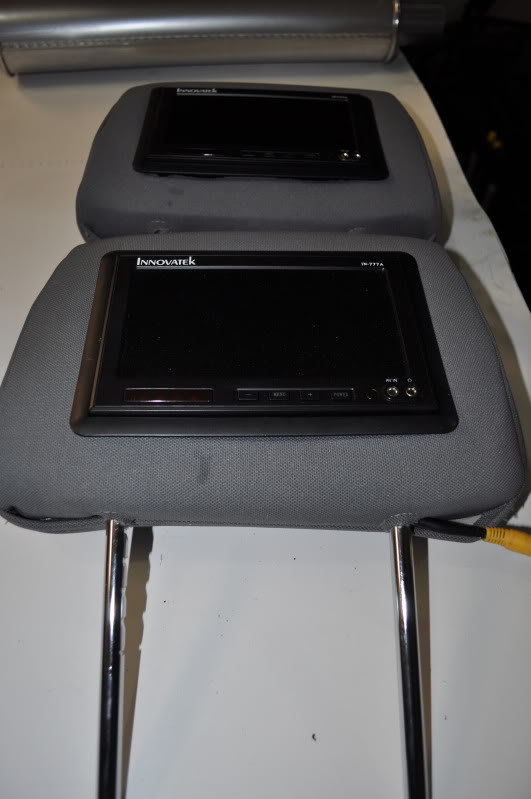

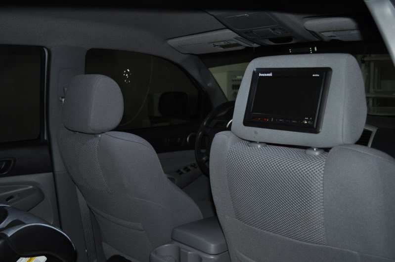

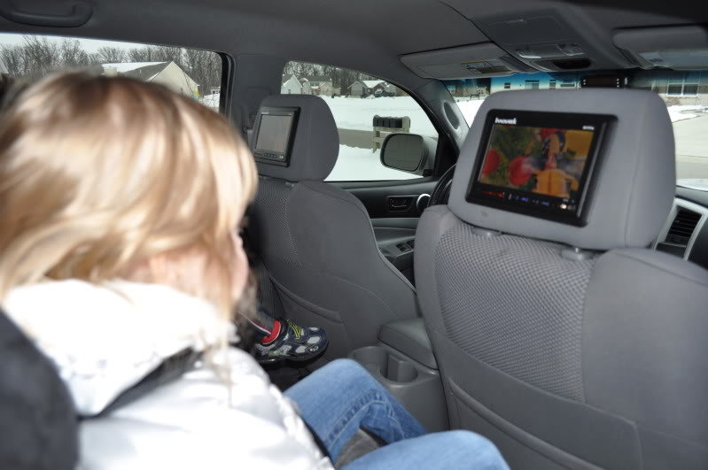

    I finally got a spare set of headrests (from a single cab) to hack into and put my old monitors to use. My only complaint is that the posts are so far to the back of the headrest that the bottoms of the monitors stick out slightly instead of sitting flush. Its not that noticeable once in the car and the seats are properly tilted back. And my kids didn't seem to care a bit. :) My little DIY write up can be found here:
    http://www.tacomaworld.com/forum/audio-video/75490-headrest-monitor-diy.html#post1434535

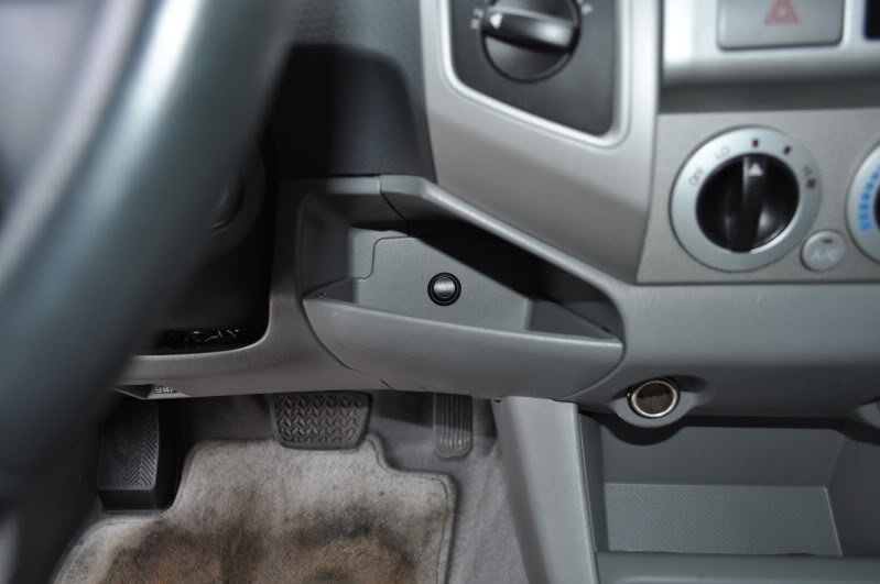

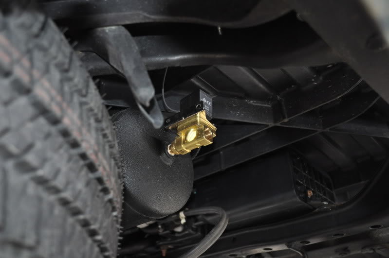

    I also added a solenoid valve and momentary switch for a future air horn . . . I wanted the switch to be somewhat hidden and I'm happy with my location. For now, its simply a way to blow down my tank and get that cool air ride sound. B)

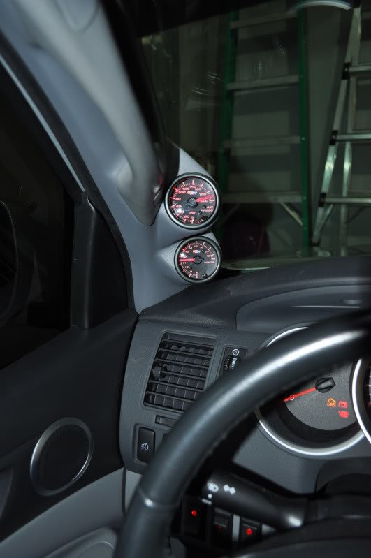

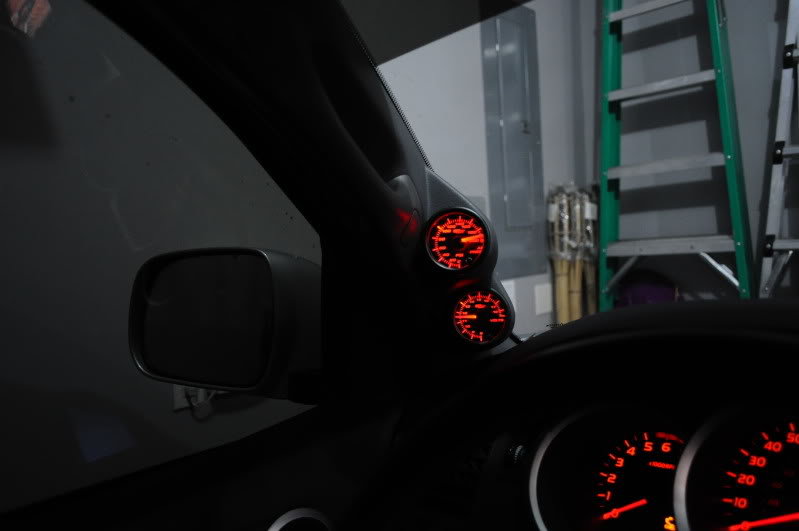

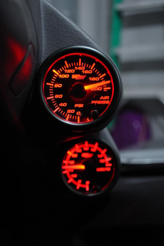

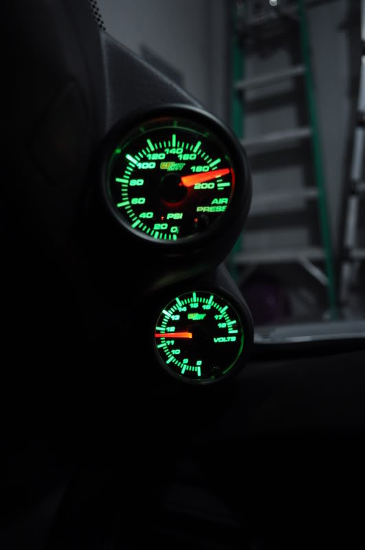

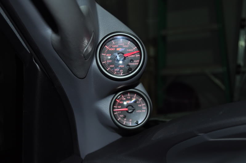

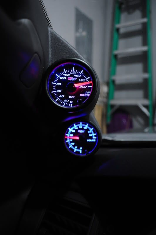

    I wasn't happy with the placement of my air pressure gauge so I decided on something different:
    and if you don't like red:

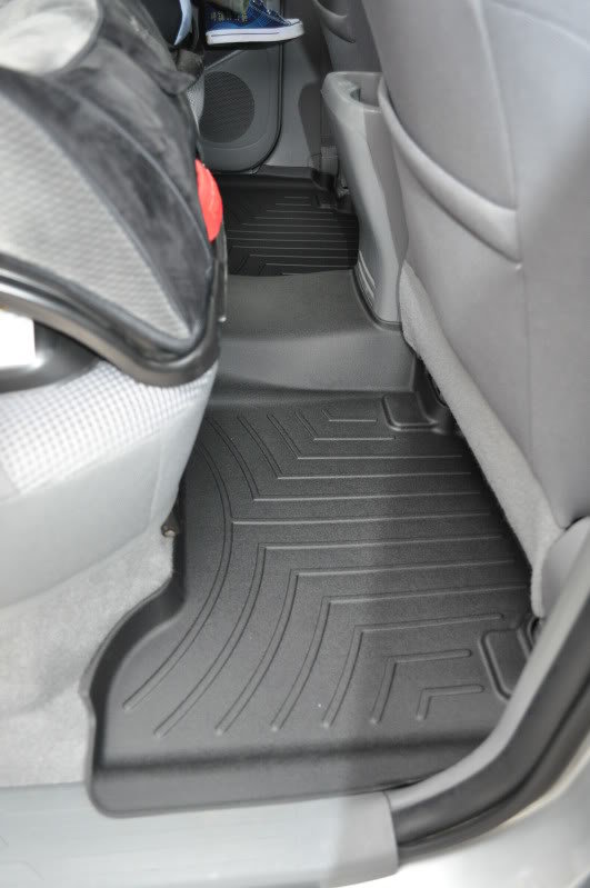

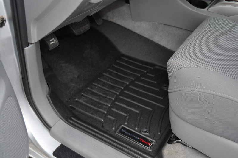

    Finally got my new mats:
    Love them! Now I just need some seat covers so I can keep the kid's footprints off of the backs of my seats.
