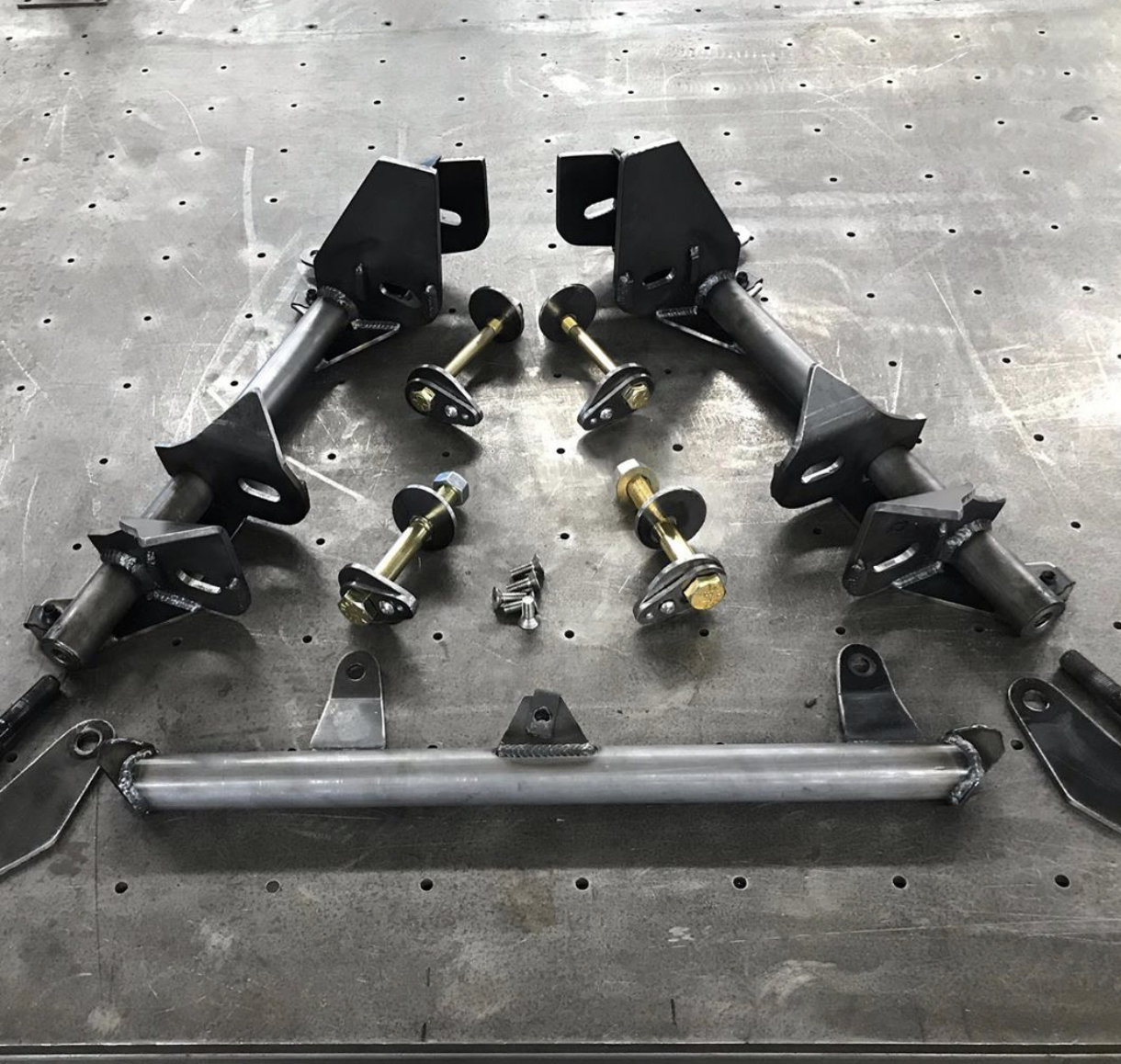

    When it comes to that I would go with the Marlin Crawler gussets as @jeff b mentioned or atleast go with the TC cam tabs. I personally have only had one tab do that on the inside of the LCA, but it wasn't even close to affecting my alignment. I just bent it back and haven't had a problem since.

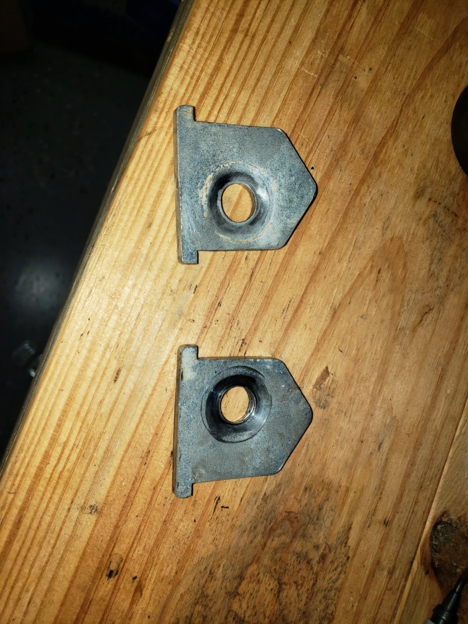

    I've had them for about 6 months. I have the front end apart to install my new clamshell and decided to check the torque all around.
    147ftlb is what the digital snap on torque wrench read for the driver rear. I back off the nut to disassemble and here's what I found.
    250ftlb might be a little much. I'm going to email poly performance. Only the driver rear is like this :notsure:

    I torque these cams to 175ft/lbs with no issues... 250 seems excessive

    In Progress
    What is that? Looks better than these tabs

    Anything over 100 ft lbs is excessive honestly. At this point when you have fixed alignment tabs the bolts aren't moving anywhere and the bolt down is simply clamping the control arm mounting tabs onto the bushings. Nothing is going anywhere so why torque them some godly amount like them?
    If you need to use more than excessive pressure to tighten them using a 1/2" 2.5' long breaker bar then you are overdoing it.
    That being said, I am SO glad I clicked on this thread. I had no idea these existed and will make a fantastic replacement for my current OE setup for my DK lower control arms. My OE alignment tabs are bent something ugly, still hold though. I wish I could install the Marlin Crawler stuff but my BAMF skid interferes. :(
