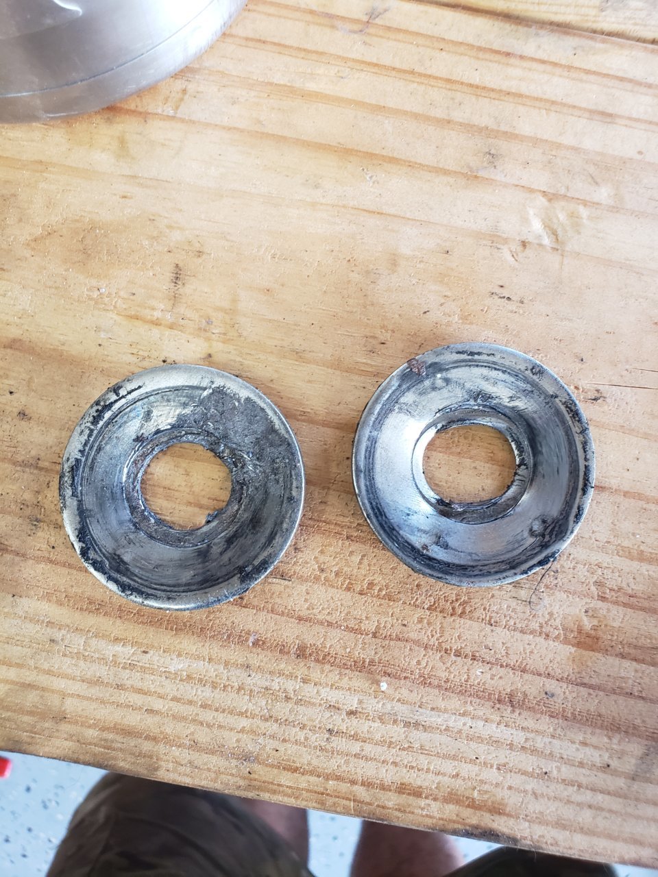

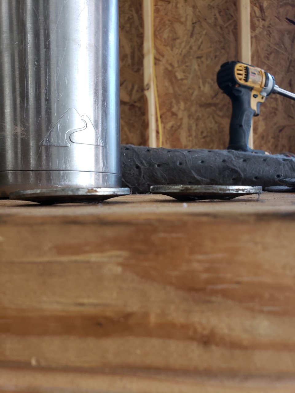

    Thats my suggestion. These never rotated out of place. Instructions say the front is 250ftlb. The rear is 110ftlb.
    THAT BEING SAID...here are my front washers at the correct 250ftlb
    I'm going to go buy better washers and whatnot and make this mo betta.

    Just spoke with a couple folks at Poly Performance. They said they had never heard of this kind of damage and that the torque specs were based off of OEM...SO, I referenced the torque spec guide and how its actually listed at 100ftlb front and rear, not 250 front, 110 rear. I sent pictures and I guess they are going to talk to the engineers. More to follow.

    I just spoke with James at Poly Performance again. The engineer(s) is out for the next couple days. I replaced all of the washers and 9/16 bolt. Torqued 150ftlb up front and 110 in the rear. Had to debur the tabs to make the bolts go through after the taco tabs had bent. If anyone here went to 250ftlb, I recommend you take them apart and check your washers.

    I'm in the middle of install. The driver side I torqued to 250. I just double checked, washers look fine but the bushing (whiteline) looks compressed. Definitely gonna back it off about 100 lbs.
