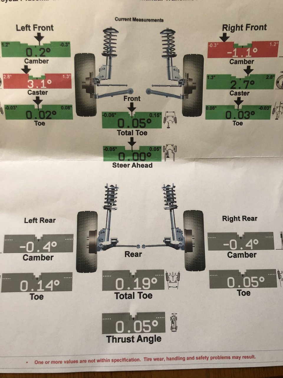

    Your camber/caster numbers are way better than mine! Here's what I've got (same tabs; Neutral Front, Max Rear)
    Based off of those numbers, @Andy@Poly or anyone else, do you think I should swap out the Passenger front tab to a Max setting to get my camber back closer to positive? If I'm reading the taco tabs instructions right, replacing it w/ a max tab should get me 3/4* more, hypothetically giving me about -0.4, correct?

    I think you should swap the front out for a max inward one. And when you say rear is max, you mean outward?

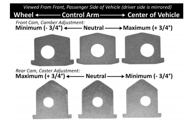

    Yea, when I say going to max for camber, I mean placing in the outward position. (Based off of this diagram on the instructions) Wouldn't going to an inward position up front give me more negative camber than the -1.1 already?

    Here's the way I understand it. When you make the LCA longer, you're making camber more negative because the lower ball joint is further outward than the upper ball joint. So in your case, your LCA is too 'long' and you want to suck it inward to get more neutral. I could be off base here, but messing around with my poly tabs, this is how I understand it.
    edit: their instructions are saying what I'm saying. It says the orientation are viewed from the front of the truck. So going inward would get you more positive camber.

    Moving the front inward will lean the tire out at the top. (More positive camber) that will also increase the caster, which will be good in your case. Do it.

    Yea, I think you're right and looking at their diagram, it appears the "camber" and "Caster" tab's max and min settings are reversed from one another, so Max "camber" setting is actually the Inward position up front.

    If you plan on getting your alignment checked again after, I would be curious to see how much the numbers changed based on that one change.

    Yes, definitely going to get it back on the alignment rack to see how it changes things. The alignment was relatively inexpensive anyway and he also said if I make any changes w/in a few months to just come back and he'll hook it up.

    Very true. However, moving the rear cam is also going to decrease caster, which could put it quite a bit below the left side. Since you only get 3 choices per cam, you’re definitely going to have to settle for less than ideal. Has the ride height been checked? If the left side is lower than the right, that would cause the numbers you have.
