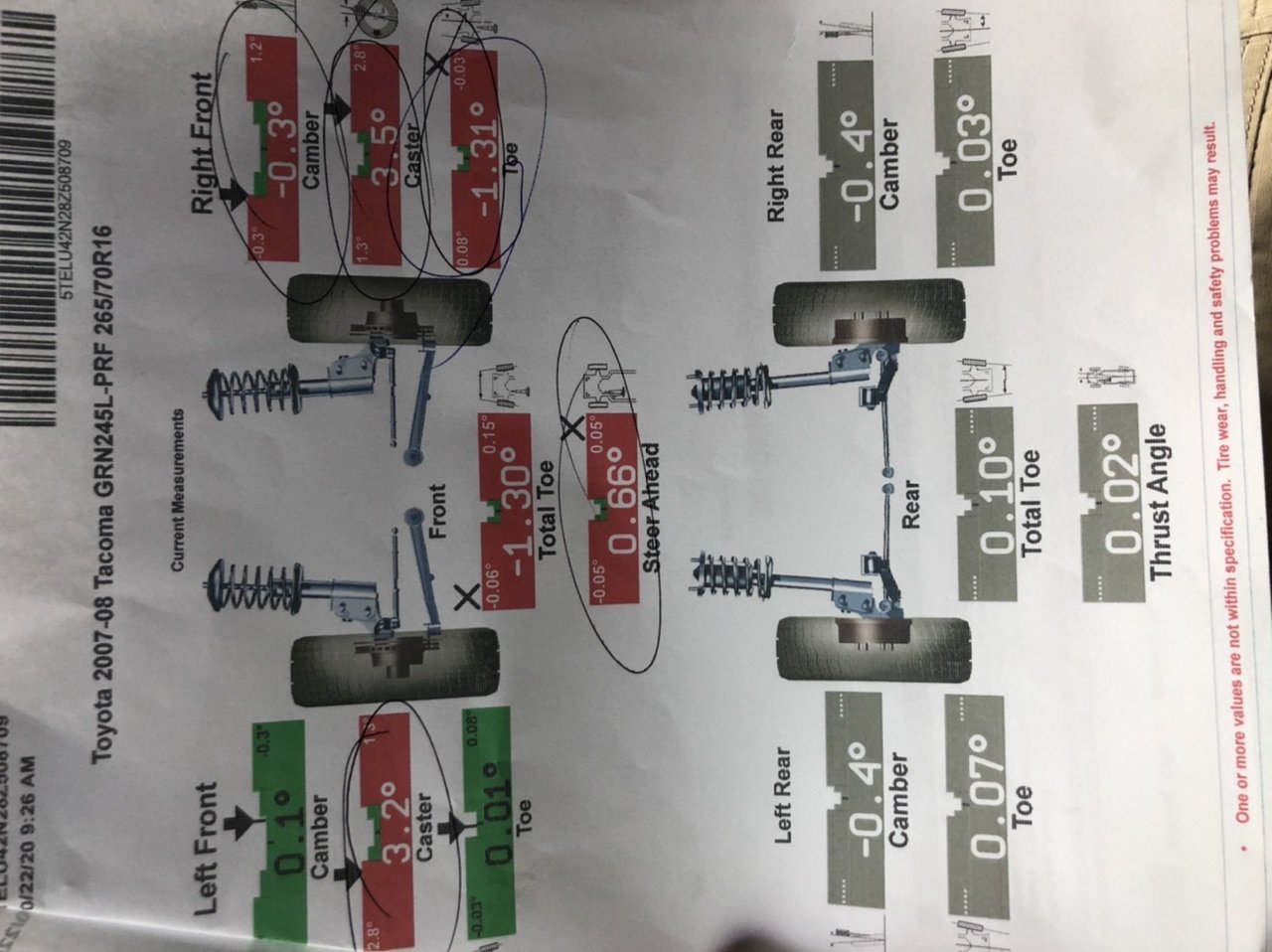

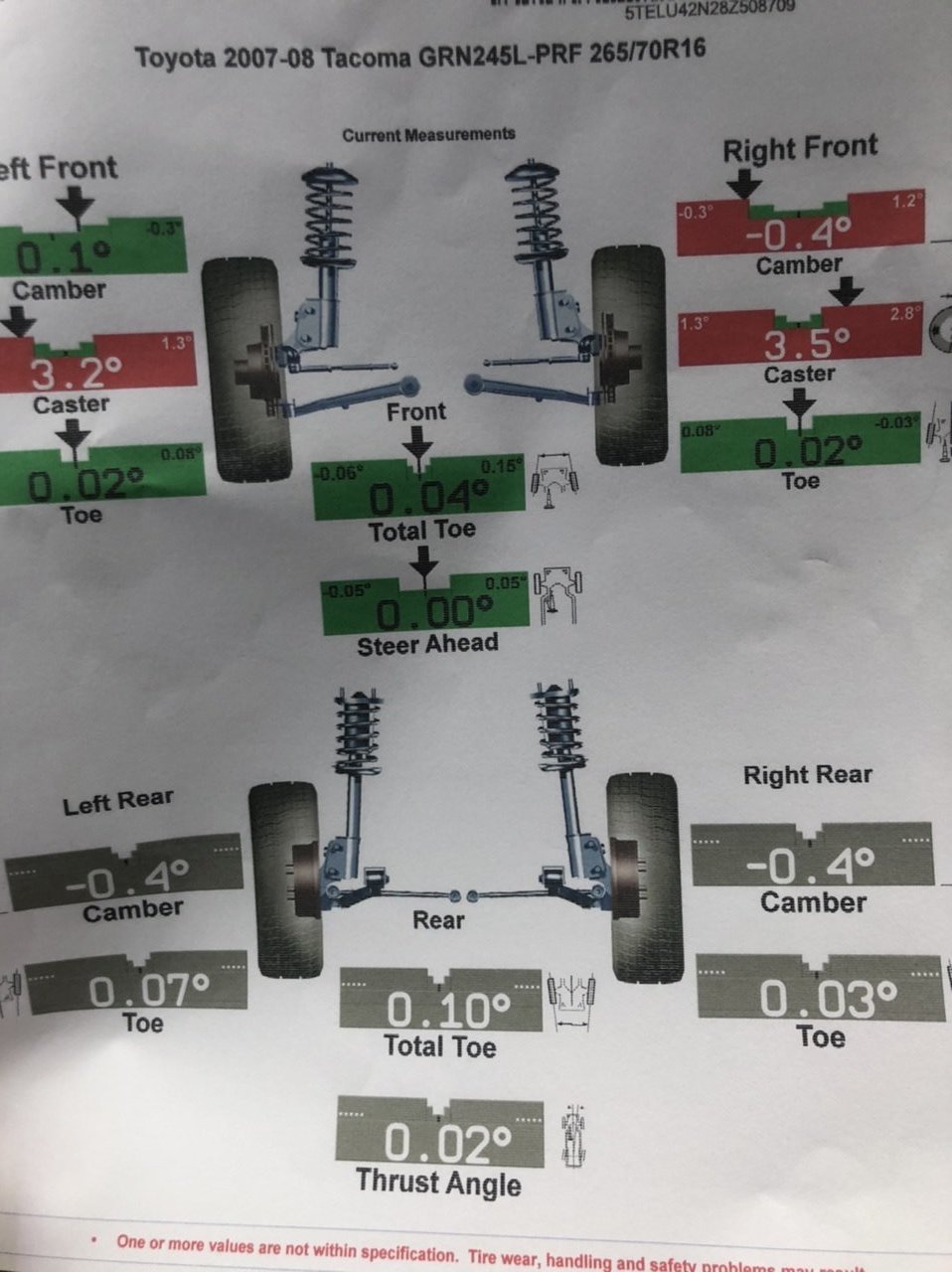

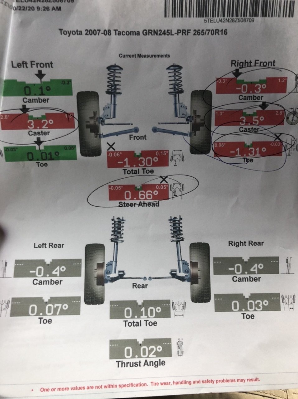

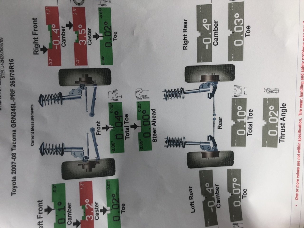

    Here’s the new numbers. Before and after the toe adjustment. Pretty much as they claim, in terms of degrees of adjustment between tabs.

  12. Oct 22, 2020 at 9:47 AM
    #112
    EatSleepTacos
    Mar 24, 2015
    #151688
    59,835
    Randy
    West Valley, AZ
    2017 4Runner
    For those that don't want to break their neck lol

    Are you just going to leave it at this point? Looks like pretty good numbers. Could always bring the rear bolt to neutral and get more positive camber and lower your caster a little but may not be worth the effort.

    7,489
    That’s not too bad. It may have a little more pull to the left than ideal, but that should only be a slight issue when you’re driving on the left side of the road. You made no mention of whether you adjusted the coilovers. Assuming you didn’t, adjusting them to level out the truck would make the alignment really nice. Of coarse, you’ll have to reset the toe in afterwards.

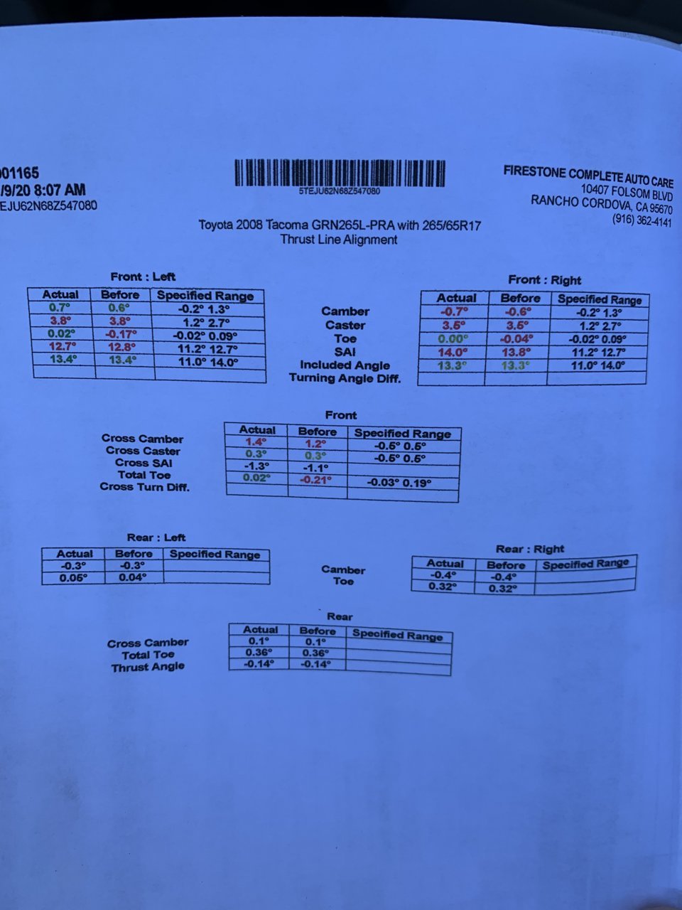

    Installed mine a few weeks ago and finally got around to getting an alignment. It pulls right a bit. Thinking of lowering passenger /increasing driver camber tabs. Thoughts?

    According to the printout, it should be pulling to the left fairly hard.

    which is why I’m asking hah!. It pulls to the right. I have cooper ST Maxx’s which are hit or miss pulling right so idk where to start.

    swap the front tires side to side and see what happens.
