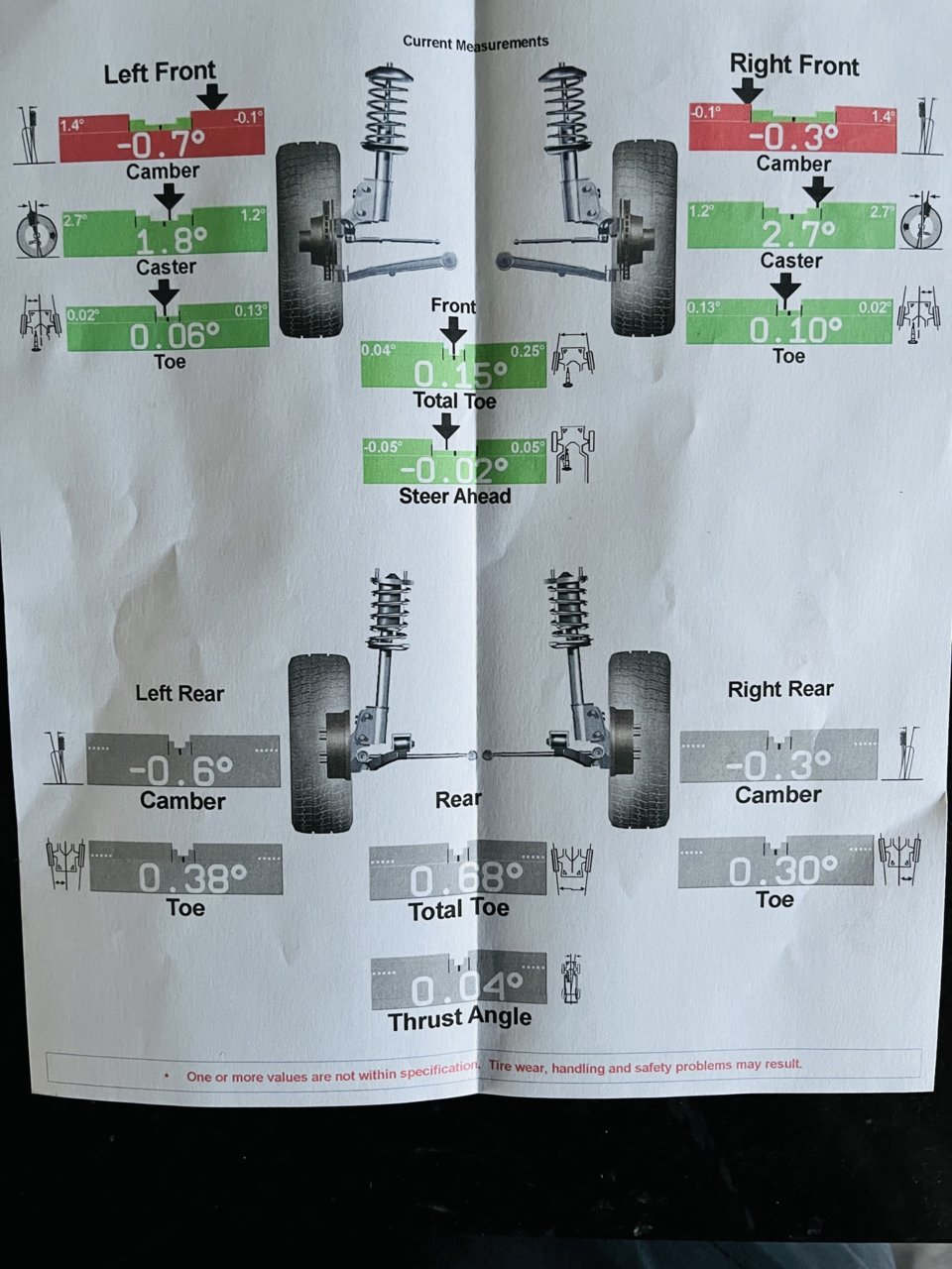

    Sasquatch3153
    Sasquatch3153 Sassy Squatch
    Oct 5, 2018
    #268376
    7,630
    Josh
    Illinois
    2010 ACLB OR

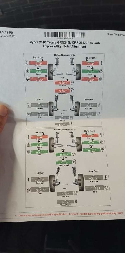

    I've got the taco tabs and these are my alignment results. I've got TC uppers. This was after wheeling and driving with a bad alignment for a couple of monthsreceived_524100312205995.jpg

  6. Aug 1, 2021 at 7:12 PM
    #146
    montijo505
    montijo505 Moon soon?
    May 31, 2014
    #131003
    2,368
    Rio Rancho, New Mexico
    08 4Runner SR5/ AKA The Great White Pig
    Looks like you need the outboard setting for the camber also, I’d try it at least if it’s neutral now.
  7. Aug 1, 2021 at 9:43 PM
    #147
    Sasquatch3153
    Oct 5, 2018
    #268376
    7,630
    Josh
    Illinois
    2010 ACLB OR
    Truck drove great after the alignment. Still slowly pulls to the right but it's not super noticeable, but that's either a Tacoma thing or because the roads are crowned a little
  8. Aug 1, 2021 at 10:09 PM
    #148
    jamesepoop
    jamesepoop Well-Known Member
    Feb 22, 2017
    #211394
    1,117
    California
    2007 Fj Cruiser
    It's a caster thing. Not sure if your lower control arm bushings are worn. If you fix the half a degree that's off, should drive straight as an arrow.
  9. Aug 2, 2021 at 2:52 AM
    #149
    Sasquatch3153
    Oct 5, 2018
    #268376
    7,630
    Josh
    Illinois
    2010 ACLB OR
    It probably is the bushings considering they're my factory originals. I'll probably replace them this coming winter so I have something to do

    Unless I'm missing something you may have said it does not appear that they aligned your truck at all but gave it the 'ole a toe-and-go treatment.
    My guess is that your LCA cams are seized and they gave up, or did not try. Did they say anything about not being able to turn the cams? Anyway, the alignment sheet would suggest to me a pull to the right due to overwhelming negative camber on the LF.

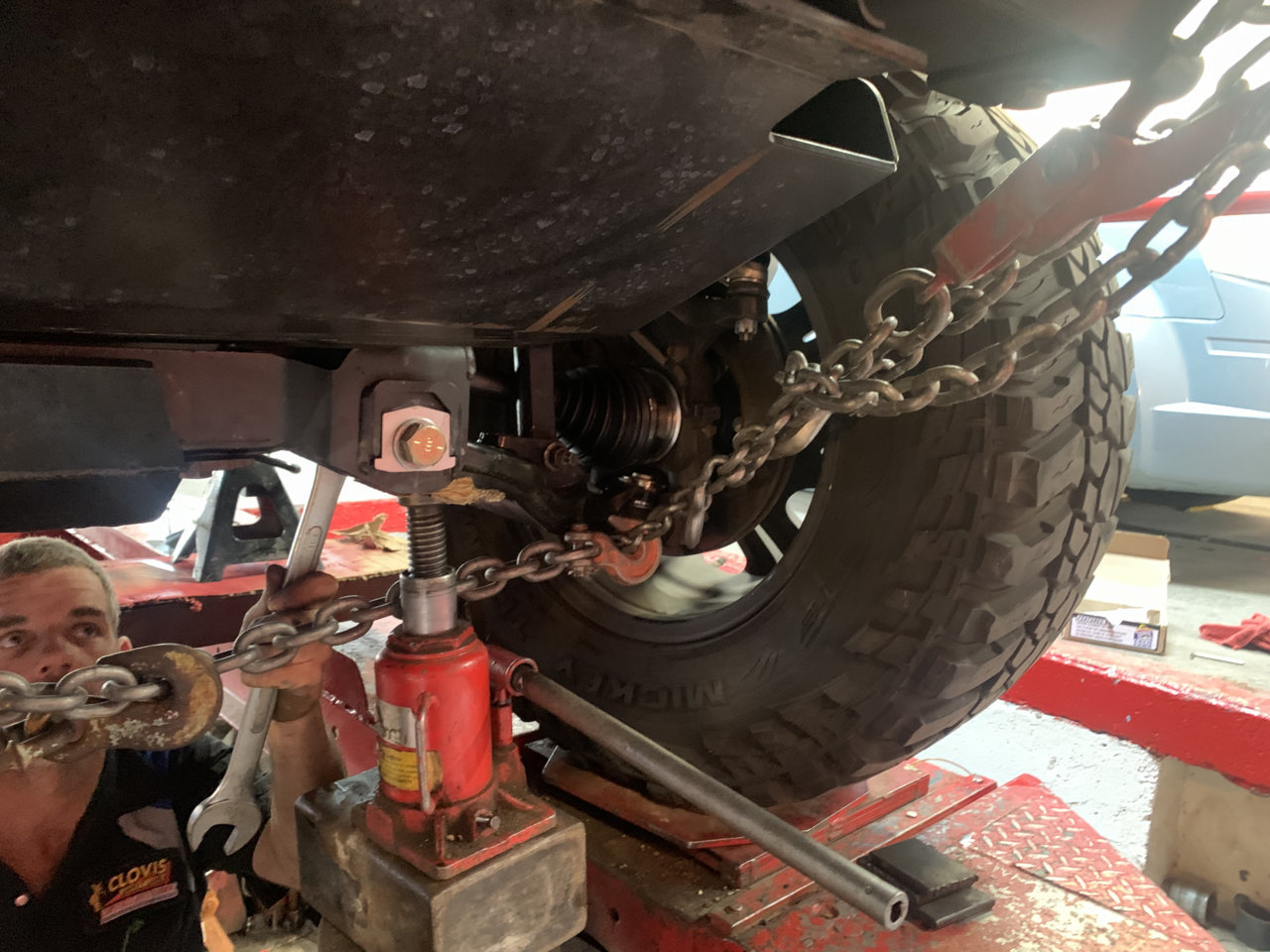

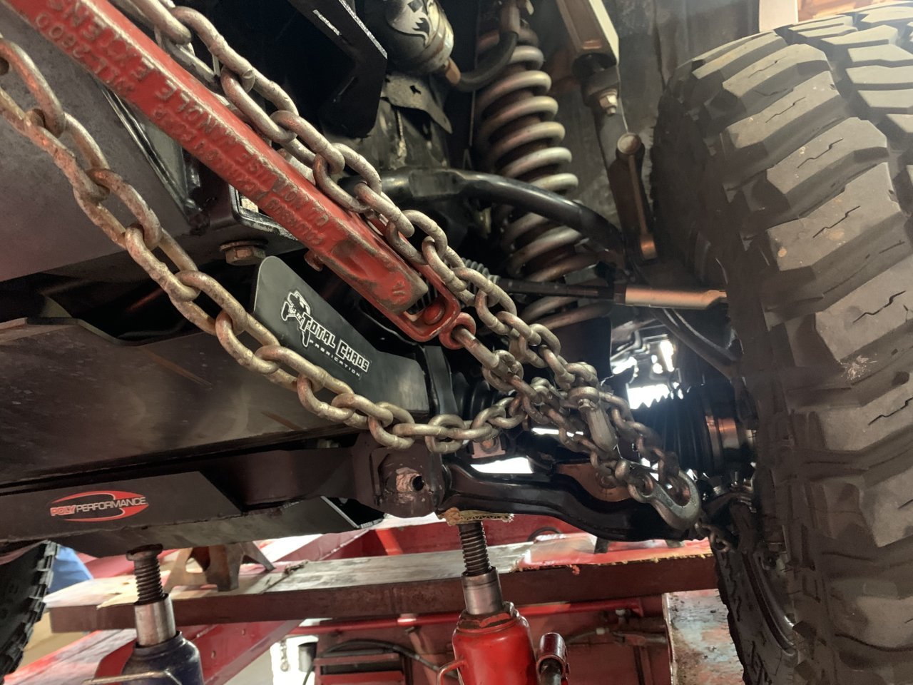

    complete front end rebuild (Steering rack w/ ES Poly bushings), new OEM LCA's adding Whiteline Poly Bushings, going to ES taco Tab alignment kit to replace factory cam bolts:
    UPDATE- Front end rebuild complete.
    used taco tabs (Max Caster , neutral Camber - fine tuned using the Icon Billet UCA’s.
  16. Aug 6, 2021 at 4:26 PM
    #156
    dpf88101
    dpf88101 Well-Known Member
    Sep 21, 2020
    #341518
    359
    used some come alongs with some creative rigging so we didn’t have to disassemble everything. Was able to get the “neutral” tabs in the camber slots. Already had the “Max” Caster tab in the back. Everything aligned much better dialing in the final adjustments with the Icon billet UCAs
    Acutune off-road is building me a new set of Fox 2.5 CO w/DSC and eibach 14” 650lb coils.
    Will go 2.5’ s in the rear with DSC Resi’s. Complete revalved and tuned for the truck hope to have them next month
    9111B041-BBA8-416A-90E2-B6A61795E631.jpg F16BB1C8-34D6-4001-A29A-B5E01C7E8906.jpg

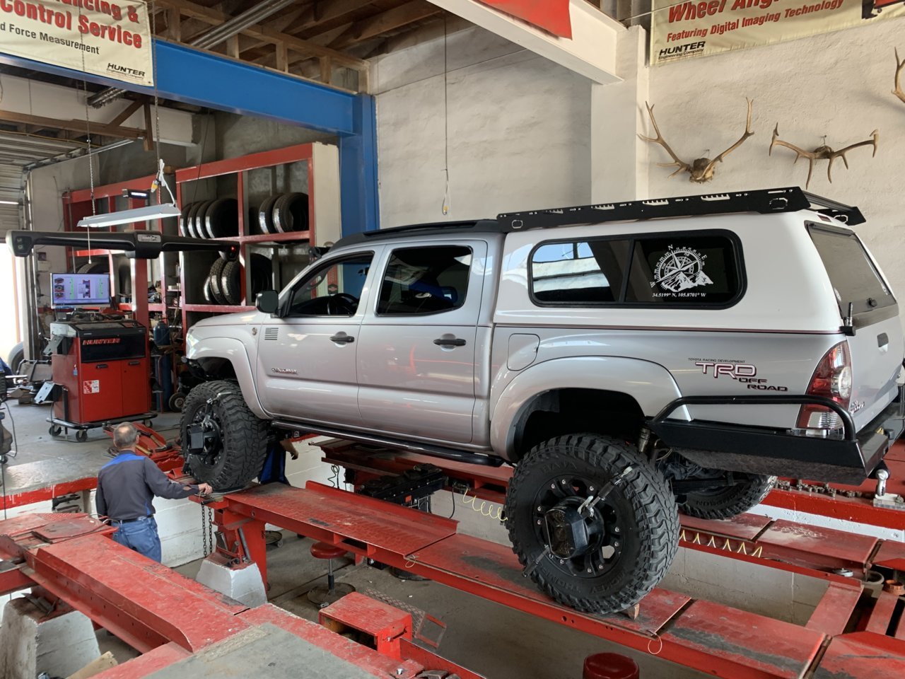

    Just installed these to help with keeping my alignment in check when wheeling and to also try and gain some clearance for my 35s. Maxed out the rear for max caster and am running the neutral tabs up front. Definitely seemed to gain clearance at the firewall.. but may be rubbing the frame a bit more than I used to. I can't remember tbh. Wondering if I should try the Min or Max tabs for the front. My main concern is clearance at the firewall. We'll see what the numbers come back as tomorrow and I'll go from there.
    Edit: came out pretty good and drives pretty good. Think im going to leave it for now.

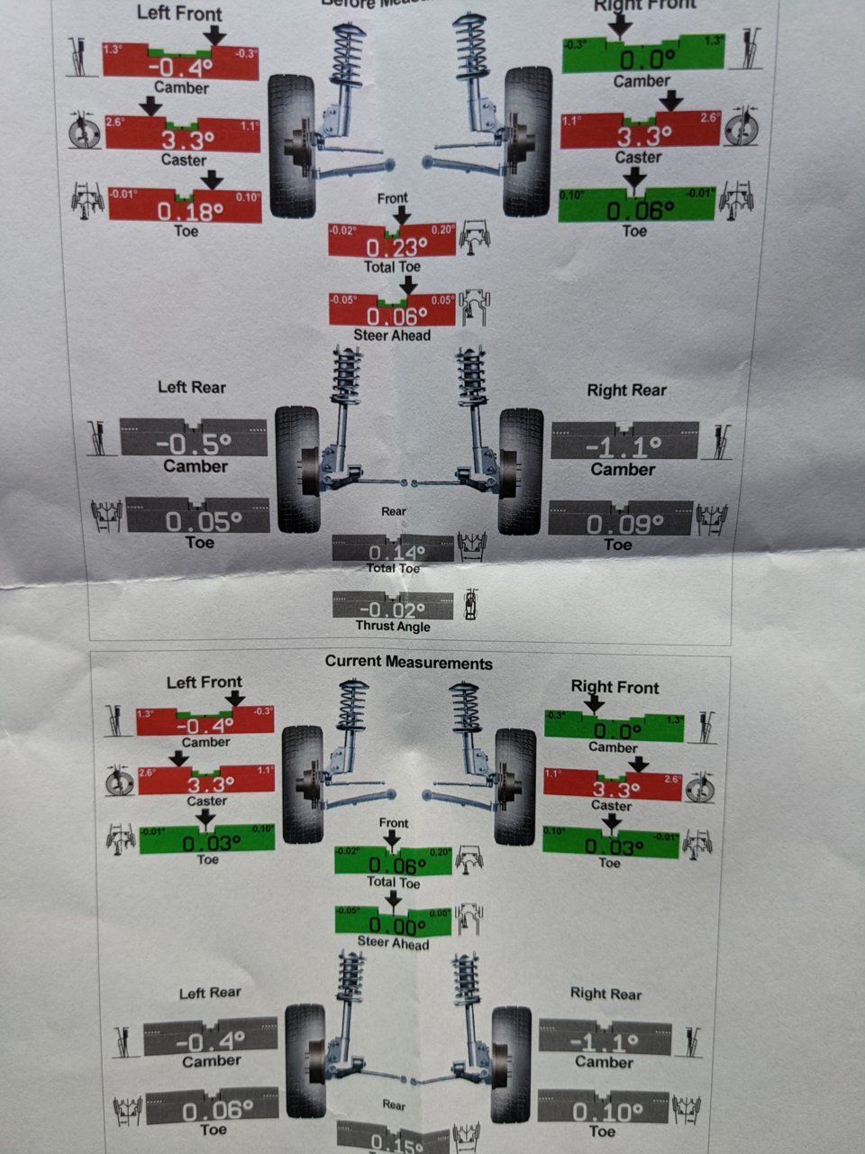

  20. Mar 18, 2023 at 7:48 AM
    #160
    geekhouse23
    geekhouse23 The "Liftman" - @DrFunker
    Jul 14, 2013
    #108251
    15,708
    2GMGMDCSB4WDTRDFTMFW!! TL;DR
    mostly stock, grocery gettin' Prius

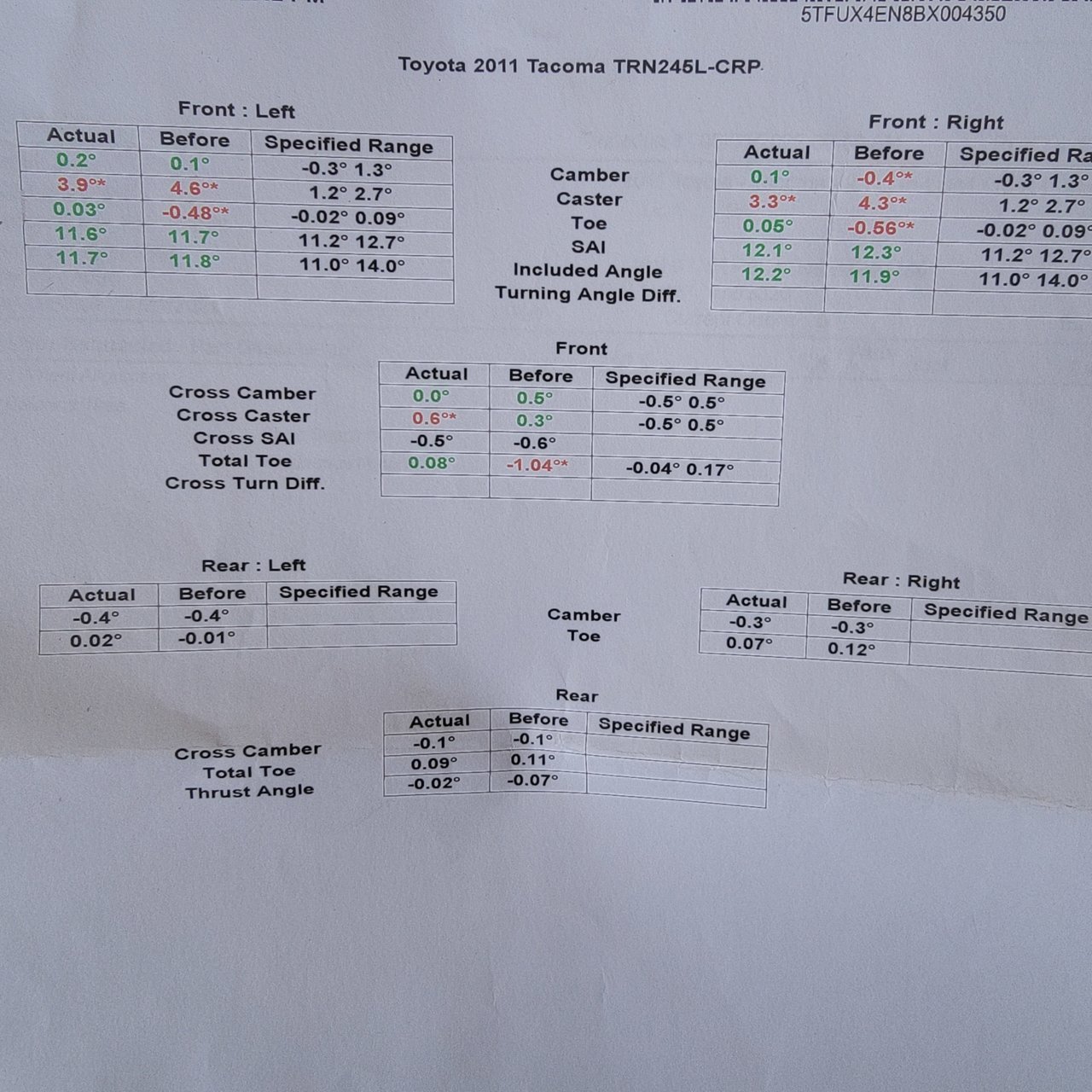

    Looking for some advice/guidance.
    I'm going to be getting the total chaos cam tab gusset kit installed next weekend. I have the taco tabs ready to go as well. I went to get an alignment about 2 weeks ago.
    My concern is that when I go to install the TC gusset kit, my alignment will be out of wack until I can get it to an alignment rack the week after.
    Below are my alignment specs from about 2 weeks ago. My question is can I install the taco tabs get when getting the TC kit installed and which plates should I install?
    I'm not as concerned about camber since I'll have the alignment shop adjust that.
    Is there something that I am missing?
