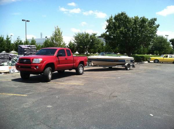

    I tow my 18' SeaRay ski boat with my 2.7 auto. Weighs around 3000lbs loaded up. Acceleration is snail-like but it pulls at 60 on the freeway and up moderate hills fine, but bogs down on steep grades. Launches & pulls the boat out without spinning and I don't have any kind of diff lock. The 2.7 is adequate, just don't expect to get anywhere in a hurry.
