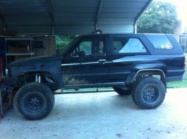

    Can you tell me about the front and rear suspension setups on that black runner?
  7. Feb 26, 2012 at 8:32 PM
    #47
    Taco76087
    Taco76087 [OP] Well-Known Member
    Jan 16, 2010
    #29458
    4,023
    Robert
    Weatherford,Texas
    04 Tacoma prerunner TRD SR5
    Rockford Fosgate p2 10'', Q-Logic Enclosure, JVC KD-PDR30 Ipod Connection, Rockford p200.2 Amp, Clear Corners, KING Coilovers, Rancho Rear shocks FJ TRD Trail Teams Wheels with 285/75/16 Duratracs
    It's got ~3" springs in the front with 8" shackles
    And 4" springs in the back with 6" shackles

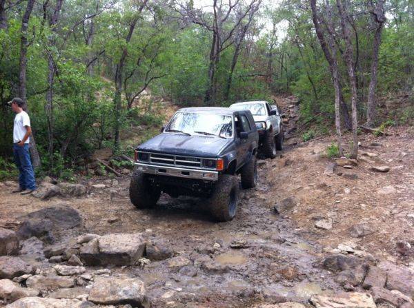

    Picked up an E-locker for the front just need gears.
  17. Nov 19, 2012 at 4:56 PM
    #57
    ajohnson
    ajohnson Glamour Shot
    Apr 19, 2009
    #16145
    8,495
    Andy
    Charlotte, NC
    07 DCLB TRD Sport Prerunner 4x4
    Things and stuff and such
    :thumbsup: Still wanting 4:88 gears?
  18. Nov 19, 2012 at 5:26 PM
    #58
    Taco76087
    Jan 16, 2010
    #29458
    4,023
    Robert
    Weatherford,Texas
    Looking at 4:88 but may just stick with 4:10 for $$ sake.
    Went out to a huge offroad park this past weekend and while it did great, a locker for the front would have made it 100 times easier. The only thing was my ground clearance of some of the large rock faces, I crushed the gas tank skid pretty good. Looking into building one out of plate, and making my own diff armor.
