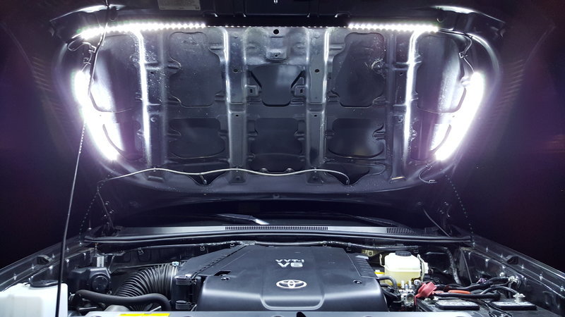

    Finally got my Taco Dane lights installed.

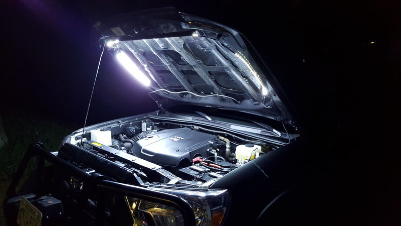

    Hood lights - neutral white:

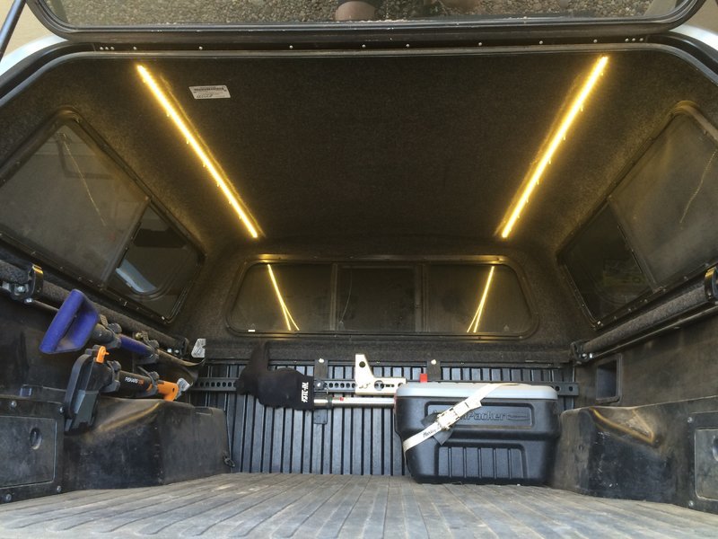

    Camper shell lights - warm white:

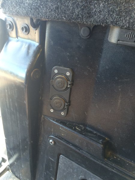

    On-off switch for the camper shell lighting. I ran 10g wiring to the rear of the bed so I could install 12V outlets as well.

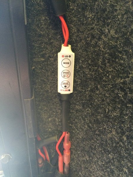

    Since I might do some truck camping, I wanted to be able to dim the camper shell lights. I found this switch at Super Bright LEDs:
    It was cheap, but so far so good. It has dimming of course, and a handful of "disco" blinking modes as well :) not that I see myself using them.

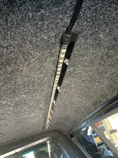

    Well, that's partly why the installation took so long :)
    I knew I wanted a roof rack on the camper shell, so rather than using washers on the inside, I bought 2 x 48" strips of 1" aluminum, that I drilled to match up with the roof rail mounting holes. When I mounted the roof rails I ran the bolts through the aluminum strips so that they clamped the roof from the inside. I had offset the holes in the aluminum strips to one side so I had room to stick the LED strips to the aluminum. Worked out perfectly.

    Well that's some great thinking right there! Better assurance for the strips to stick.

    Here's a shot of the LED strips on the aluminum strap. I used 3:1 adhesive lined shrink tubing to further secure the ends of the LED strips to the aluminum:

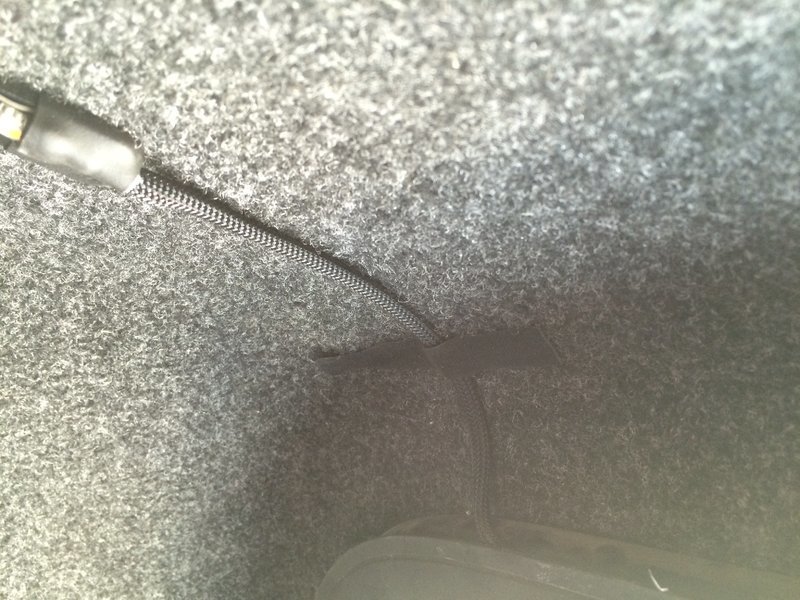

    I used the hook-side of velcro straps to secure the wiring to the carpet lining of the camper shell:

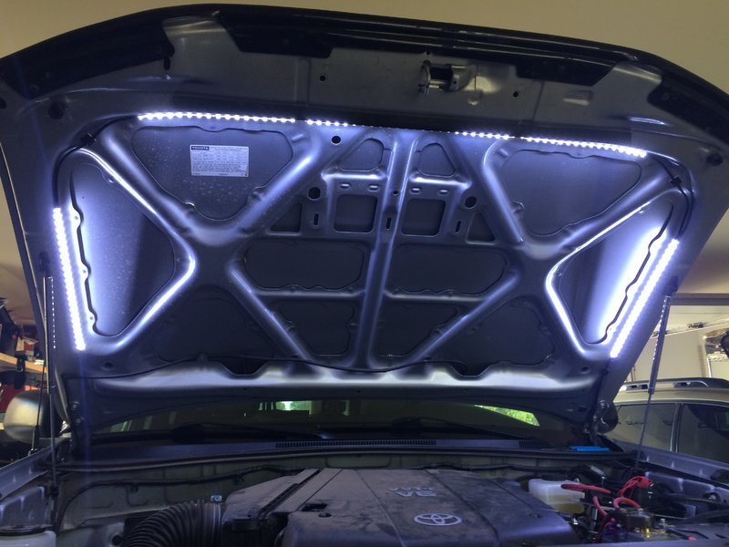

    Kits arrived today as promised. Installed in about 30 minutes and couldn't be happier with the way it turned out.
    These LED strips throw a ton of light and they stick to bare metal really well. I wiped down the mounting spots with some wet rags.
    You can tell from the picture that I need a relay with all the other stuff plopped onto the terminals, so i will likely do that next.

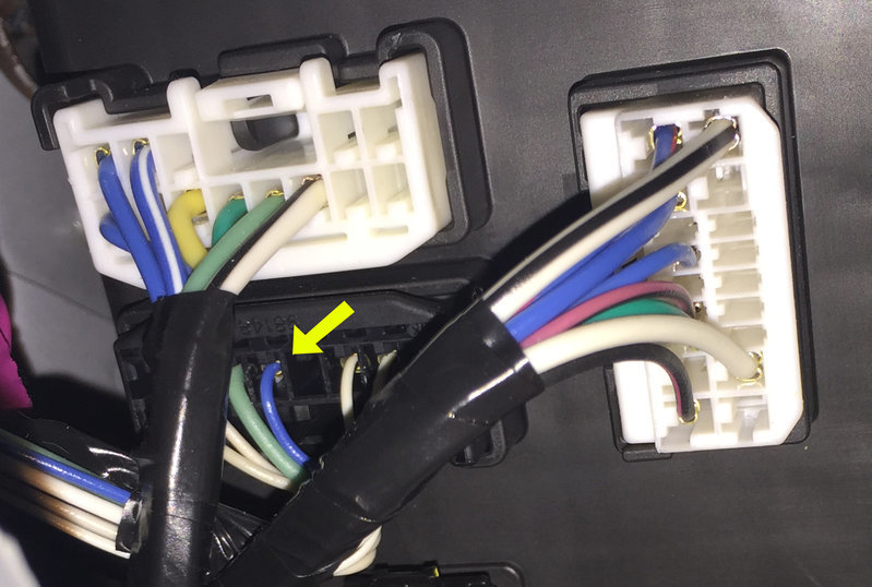

    Help a dummy! Is this the blue ground wire for the dome lights?
