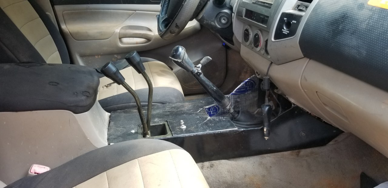

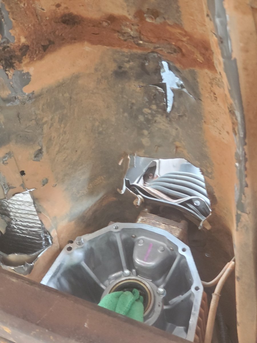

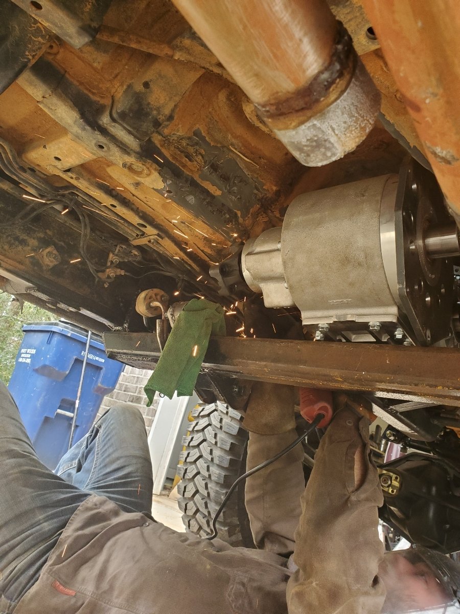

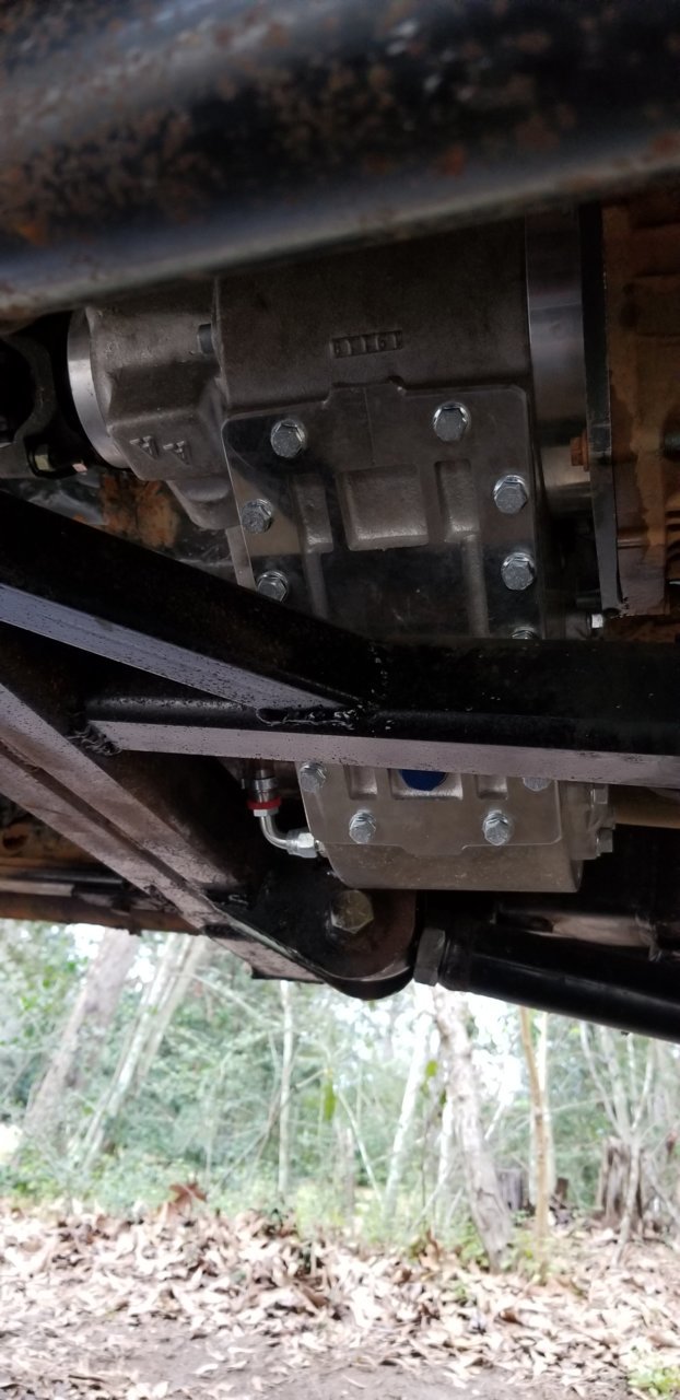

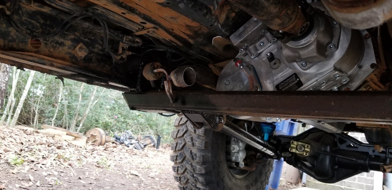

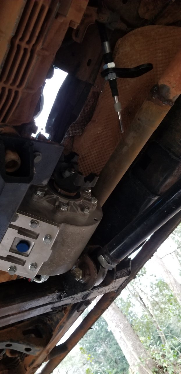

    Actually made some big changes this past weekend. I pulled the twin sticked fj case out and installed an atlas 2 speed case in it. Still need to cable it up. I'll get some pics up tomorrow if I get some daylight.
    The steering arms are super stout. 1.5"x.25" dom tubing. Got all the parts from barnes4wd
    Got some pics of the install, the install is not for the faint of heart. Had to cut up the floor of the truck pretty good to get it to go in and have room for the cable shifter. Will need to do some body work once I get the shifter installed. Could not have done this without the help of @Overkill07 & @mfer

    Awesome, just start cutting things out for more room for activities.:thumbsup:

    Sure made filling the transmission back up really painless.

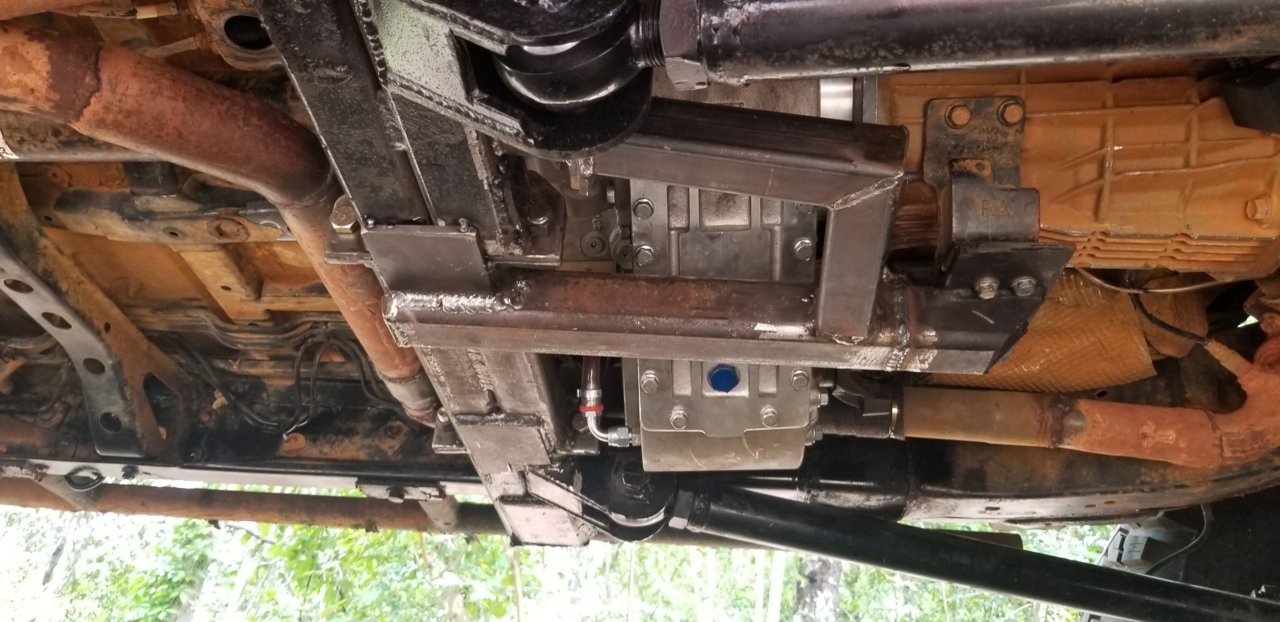

    Pics of it installed, it's hard to tell but we managed to clock it up just above the bottom of the crossmember. The cable shifter is all hooked up, now to build up the center console around it and patch up my floor.

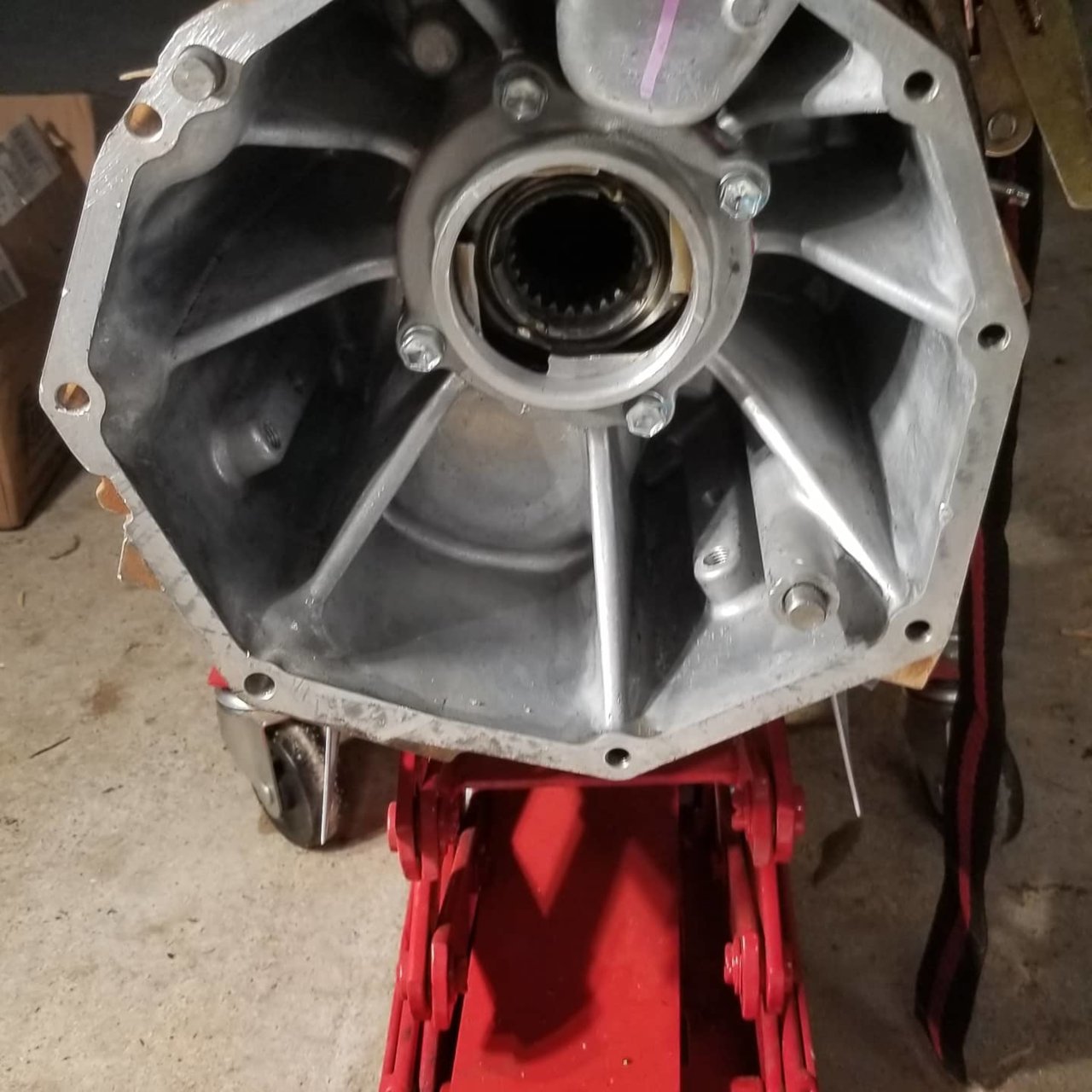

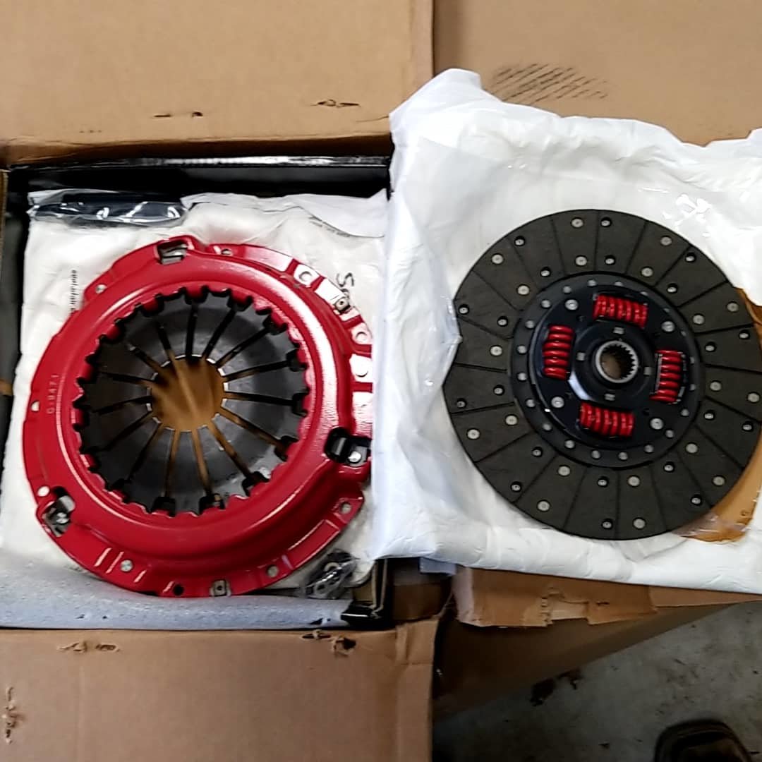

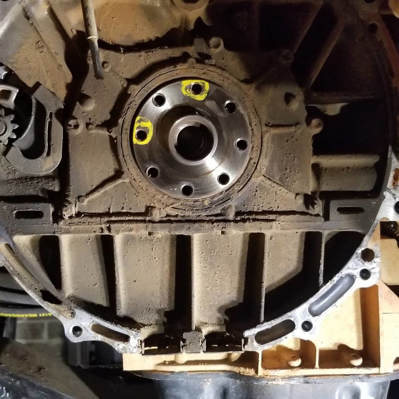

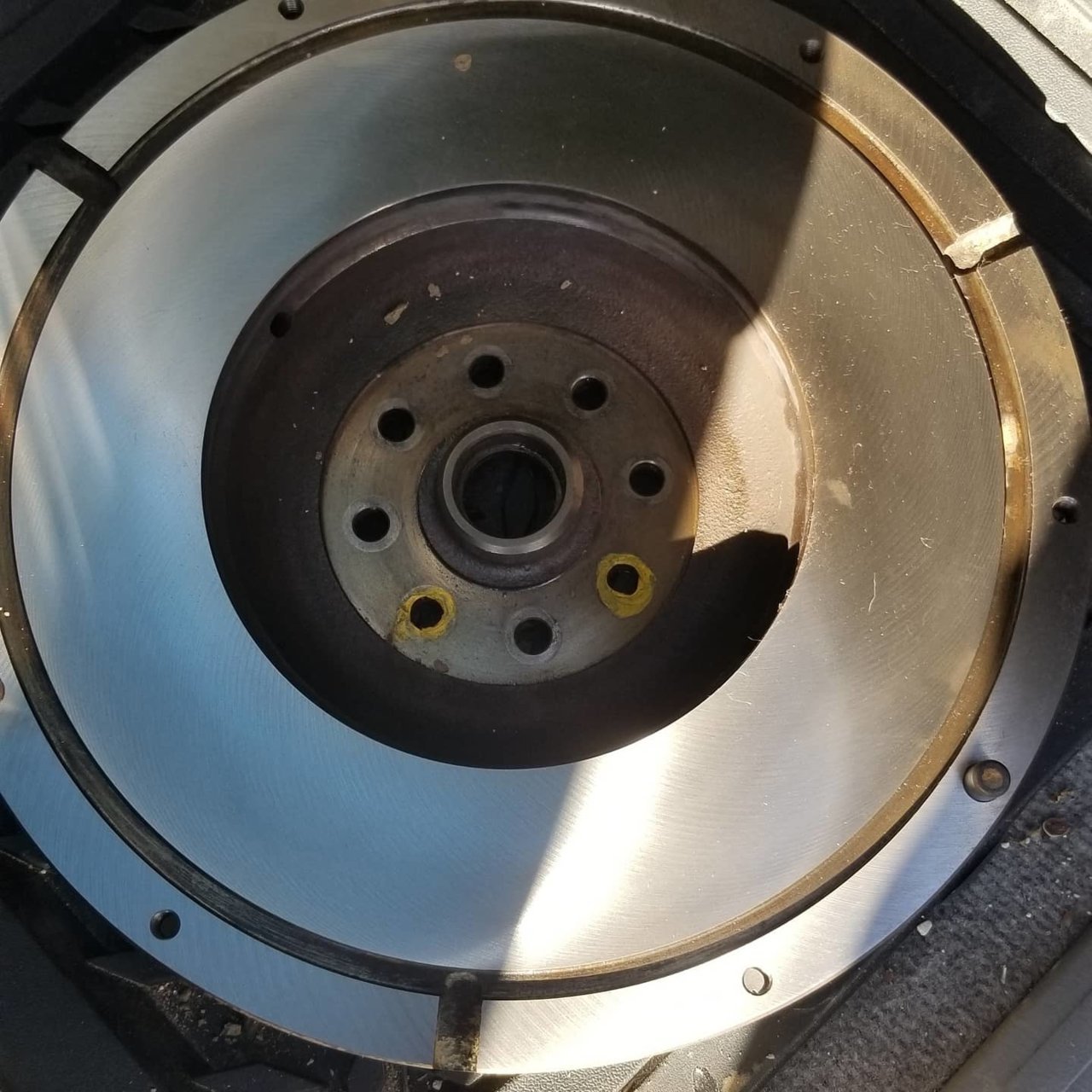

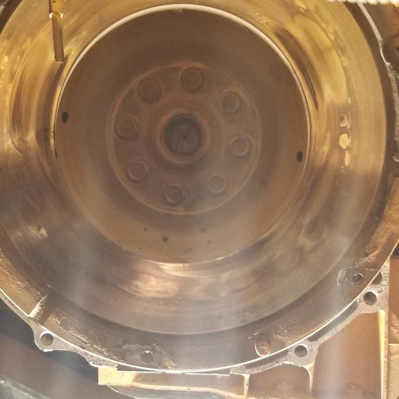

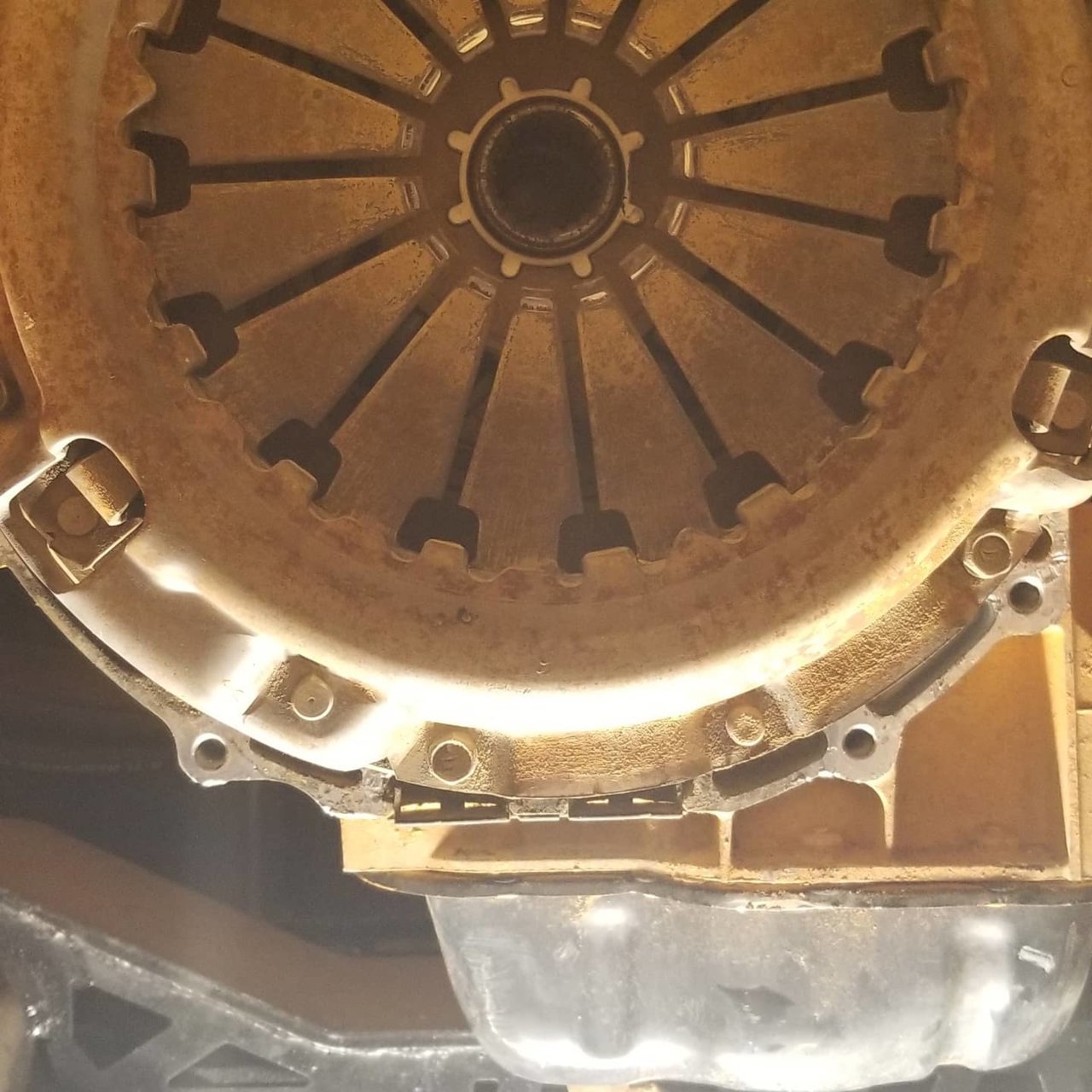

    Alot of work done in the last weeks with all this free time. Ended up pulling the tranny out, replaced the clutch/pressure plate and throwout bearing with the state 2 kit from URD, also put a new seal in fornthe atlas stub adapter. I butchered the first one and it was leaking like a sob. Also got rid of the clutch accumulator, made up a line straight from the slave to the clutch. The whole thing drives like a new truck.

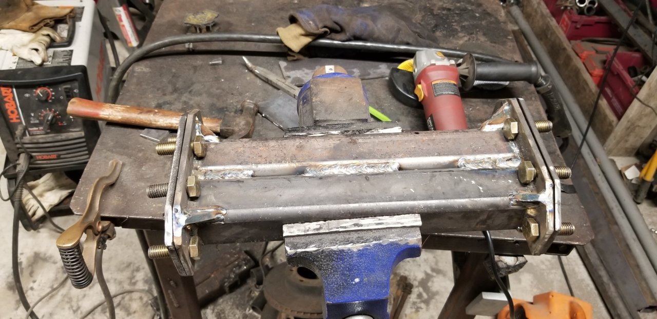

    I also went ahead and redid the crossmember to make the center section removable, should have done this from the start...oh well. Redid the mount for the tranny & atlas. This atlas is amazing, love the 5.1 low range in it. Still need to make up a front drive shaft and itll be good to go.

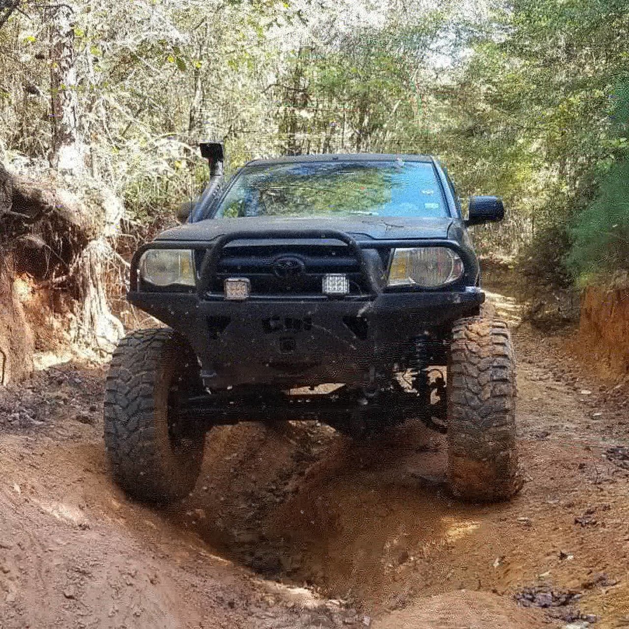

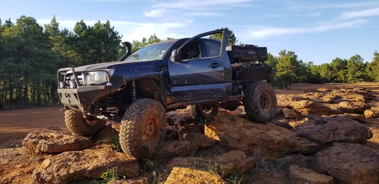

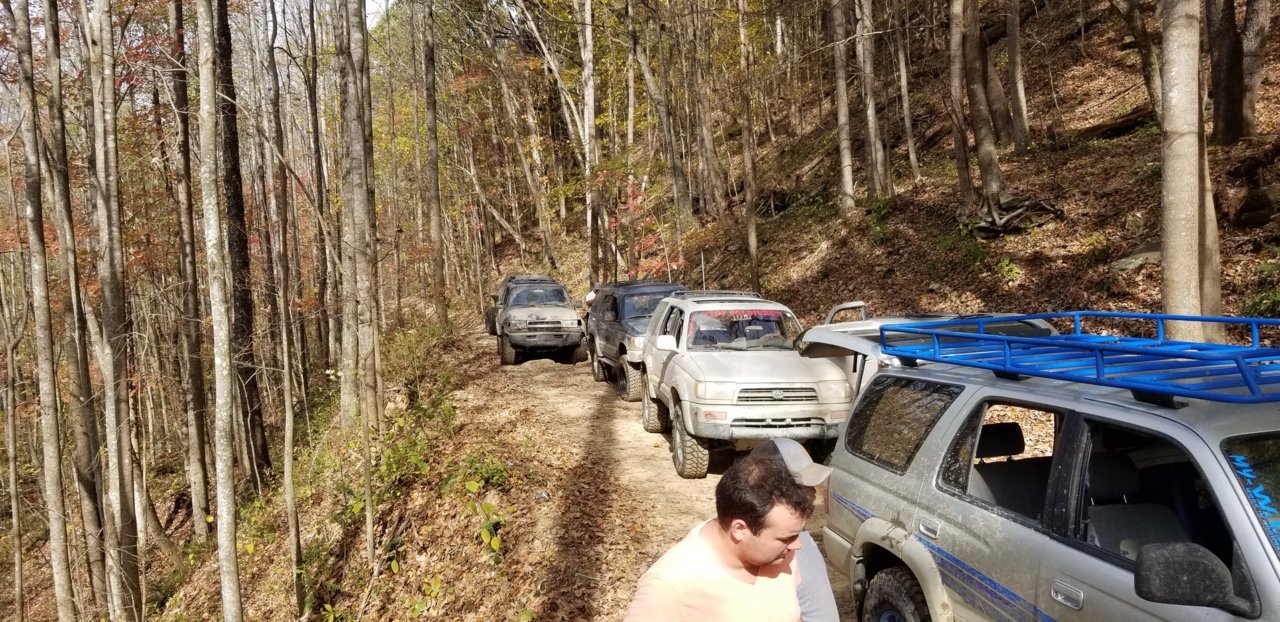

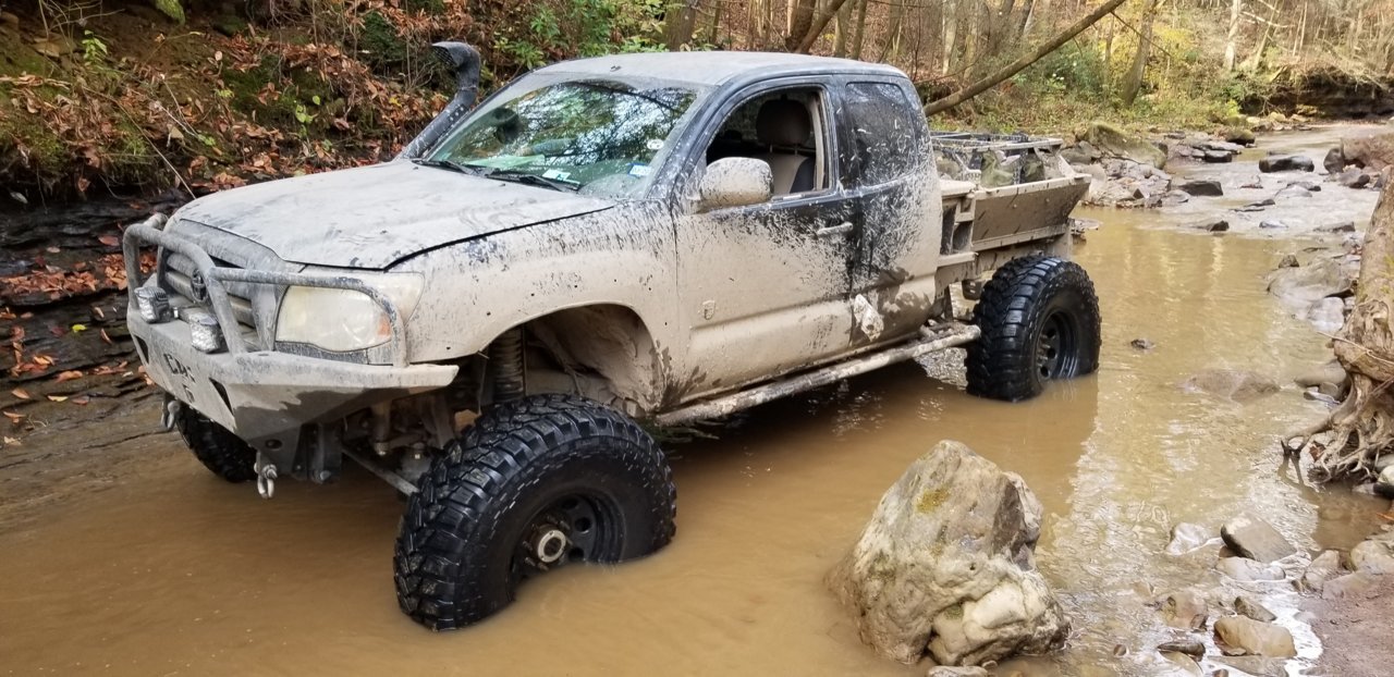

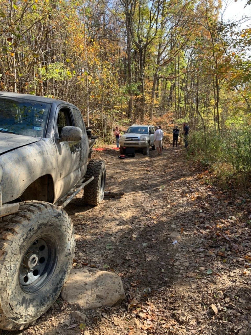

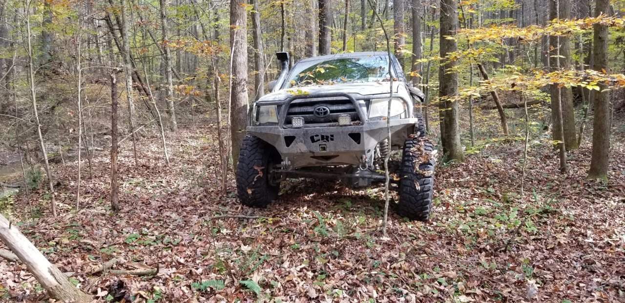

  14. Dec 27, 2020 at 7:11 PM
    #34
    Tacodriver08
    Tacodriver08 [OP] To have faith, is to trust yourself to the water
    Mar 3, 2011
    #52270
    1,990
    Texas
    05 X-Cab 4x4
    Too many to list
    Been long time since I've posted in here, truck is finished now with the SAS, needs a tranny rebuild soon and I need different weight front springs, but other than that she has went wherever I pointed her. Received some decent body damage at Windrock, lost a mirror too. Getting use to the width and the driveablitly of the rig took a short time, definitely like driving awhile new truck.
    Scattered pics from Barnwell Mt, Tx and Windrock Park TN.
    Yota X, slander, malburg114 and 2 others like this.

    How doable is it to clock Atlas for a flat belly?
  16. Jan 1, 2021 at 12:17 PM
    #36
    Tacodriver08
    Mar 3, 2011
    #52270
    1,990
    Texas
    05 X-Cab 4x4
    Too many to list
    All depends on how much you want to cut and beat with a hammer. I had to cut my floor up a bit to clock it further up.
