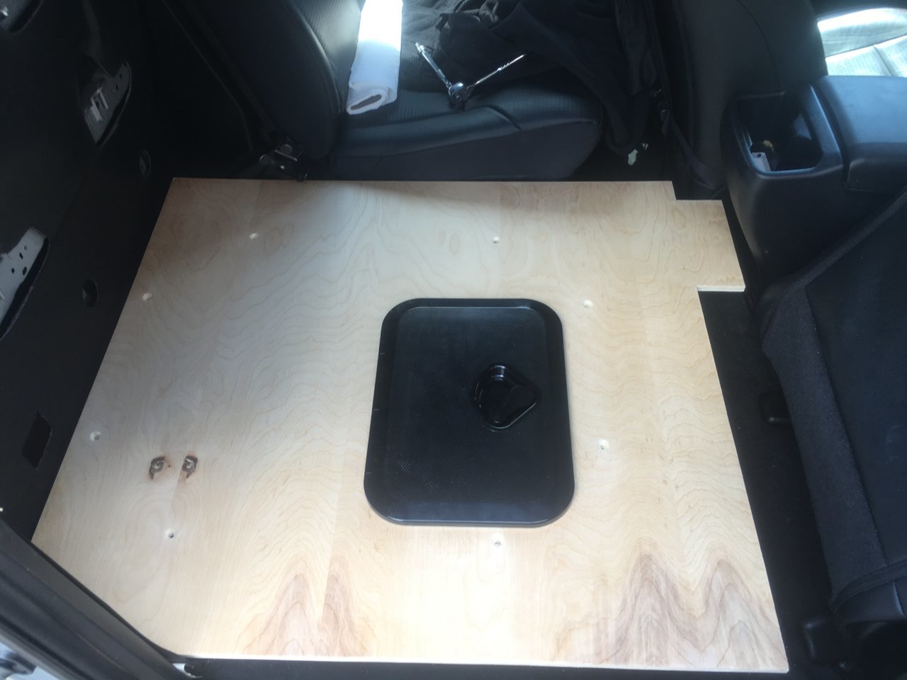

    Started work on the Rear seat 60% rear seat delete.
    Need to bedliner and add carpet and finish mounting then build the back wall.
    Parts list is as follows
    https://www.amazon.com/gp/product/B00FDSEOWY/ref=ppx_yo_dt_b_asin_title_o02_s00?ie=UTF8&psc=1
    2 of https://www.amazon.com/gp/product/B001F0I3BC/ref=ppx_yo_dt_b_asin_title_o04_s00?ie=UTF8&psc=1
    https://www.amazon.com/gp/product/B00FPP9IDK/ref=ppx_yo_dt_b_asin_title_o04_s00?ie=UTF8&psc=1
    https://www.amazon.com/gp/product/B07Q887FF9/ref=ppx_yo_dt_b_asin_title_o05_s00?ie=UTF8&psc=1
    Some lock washers, sheet metal screws and a 1/2" by 4' by 8' sheet of baltic birch plywood. 1/4-20 by 5/8" countersunk bolts to fasten the plywood to the aluminum. bedliner and carpet and carpet adhesive for the next step with a staple gun.
    We cut the aluminum in (2) 28" pieces using the remaining 19 15/16" pieces and built a rectangle with the brackets. The rectangle is roughly 22" by 28". I'll dig up dimensions on the wood.

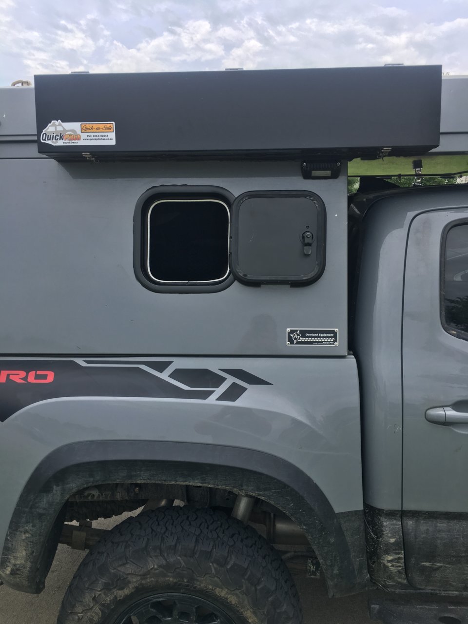

    Added a new hatch to the passenger side Another Tern Overland hatch 300 by 300 this time to store dry clothes during showers, keep TP handy for the bathroom, and to provide access to the back corner area of the habitat 0657B8C4-3D92-478B-86D0-3F5AC50C47FE.jpg 773259DC-0AE7-40A0-9F67-70354057FAA7.jpg 40D81722-FDBA-4A55-85EF-5AEE6D716195.jpg 05E798BC-9A31-4F99-8591-541092437161.jpg
    Also finally remembered to take a pic of the full panel I use on the habitat.

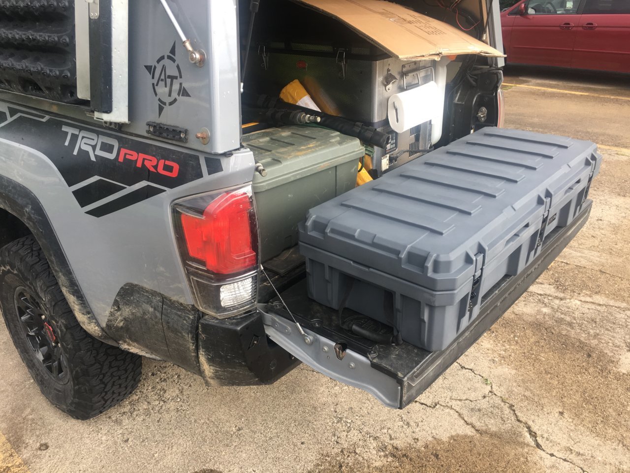

    Thanks, Ive had a lot of fun with this build. Both are good racks, prinsu is less expensive and easy to do on your own. Just need some torx bits and silicone and the punch below to cut the weather stripping. The equipo rack mounts a light bar below, the prinsu rack has a fairing on front to reduce wind noise. To each their own, I think the prinsu is solid and fairly customizable.
    Gaosi Tools Professional DIY Leathercraft Tools,The Heavy Duty and Bigger Size Black Carbon Steel Changeable Hole Punch (22mm) https://www.amazon.com/dp/B01HRI41C0/ref=cm_sw_r_cp_api_i_3aycDbSY4F4D8

    How did you mount it? Drill through the bottom??
    Glad you are okay! That must’ve been a heck on an impact!

    Drilled through the bottom. You can seal with some silicone.
