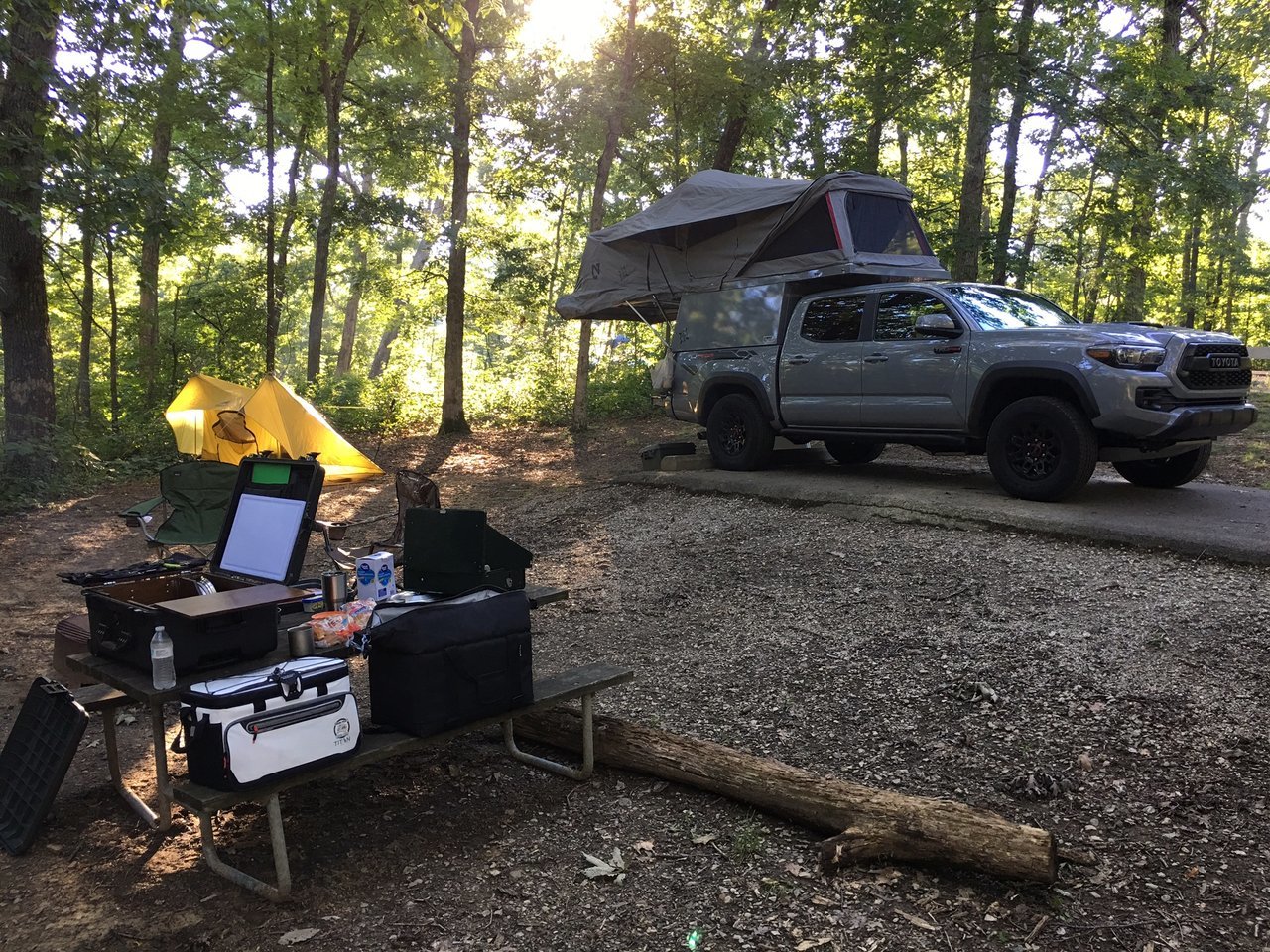

    Successful quick overnight at Lake Hope State Park last Saturday.

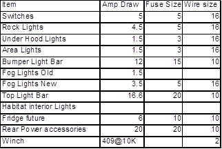

    Electrical Plan currently to be installed. The goal will be to make the addition of a dual battery system fairly painless.

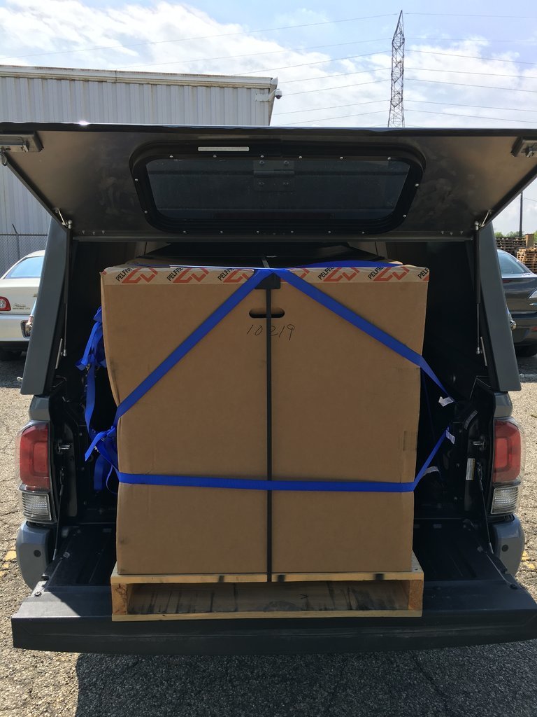

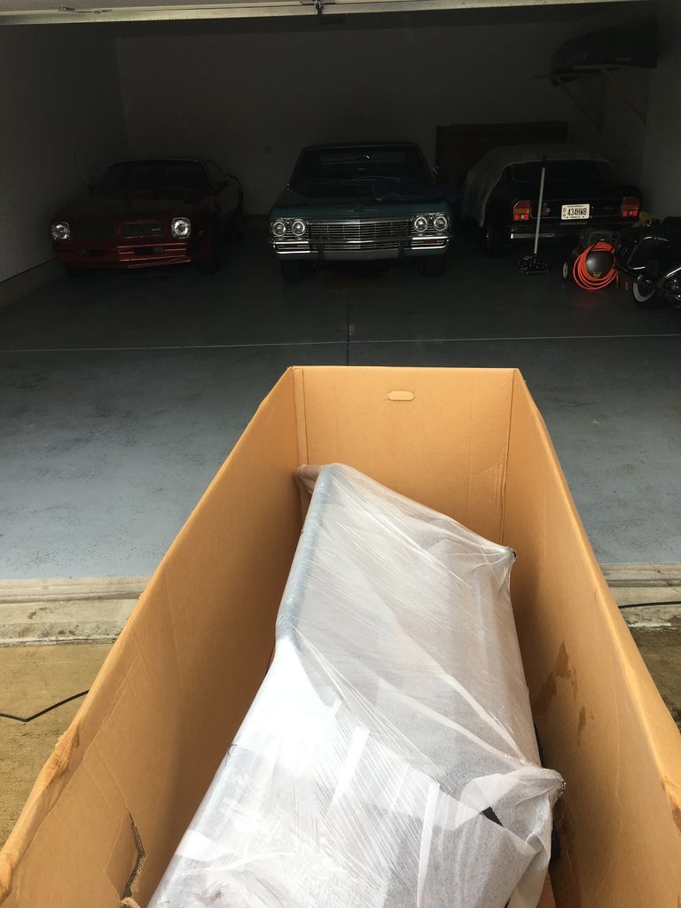

    Big old box for my Pelfreybilt front bumper to install this weekend. :bananadance::bananadance::bananadance::bananadance::bananadance:

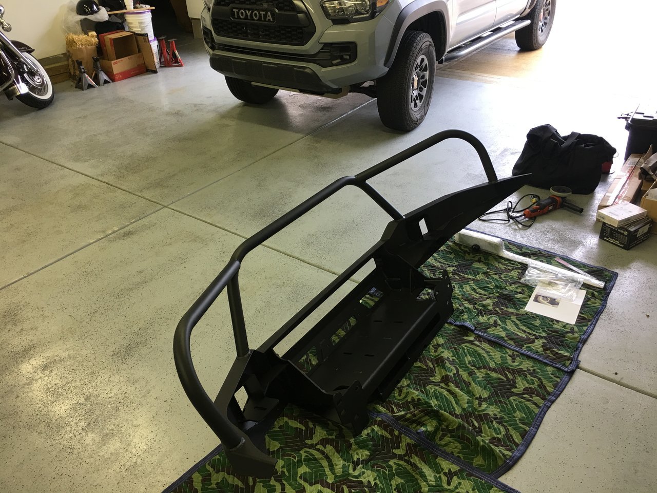

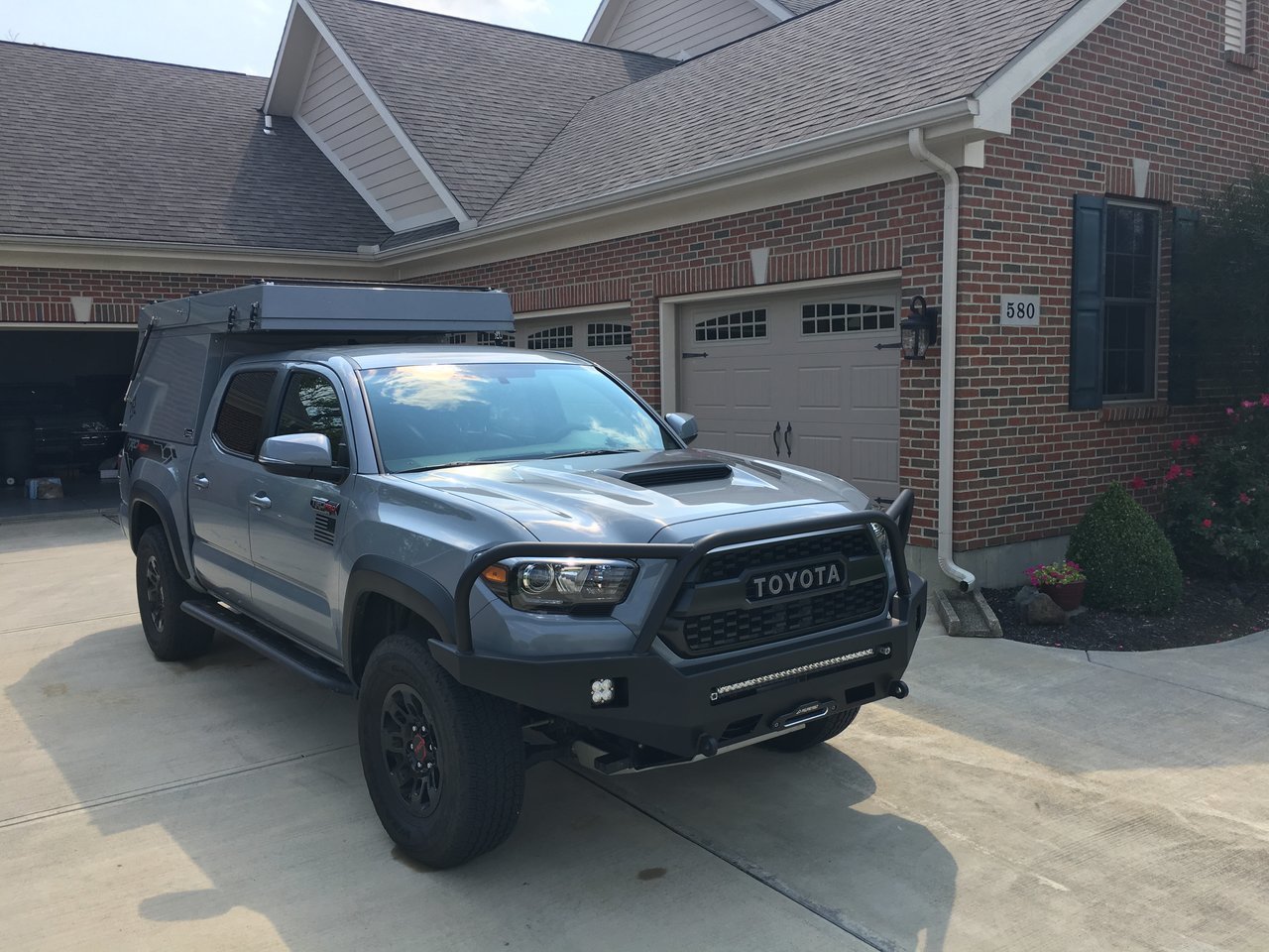

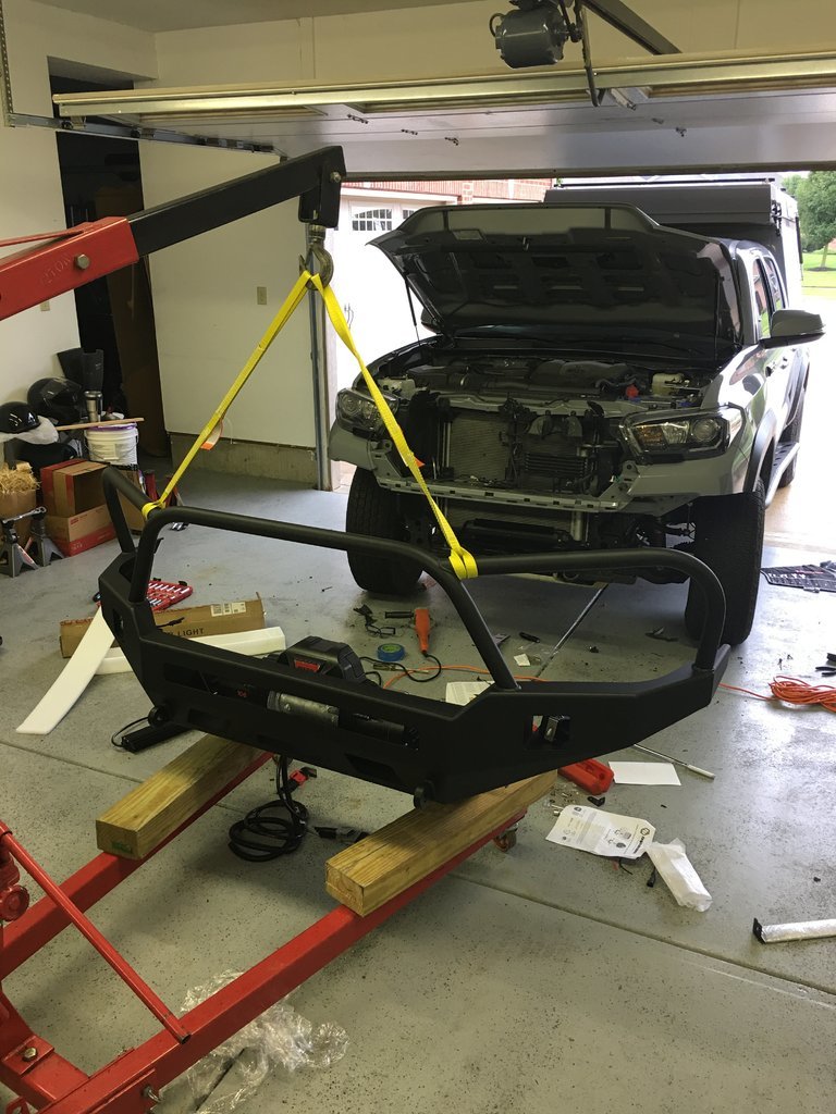

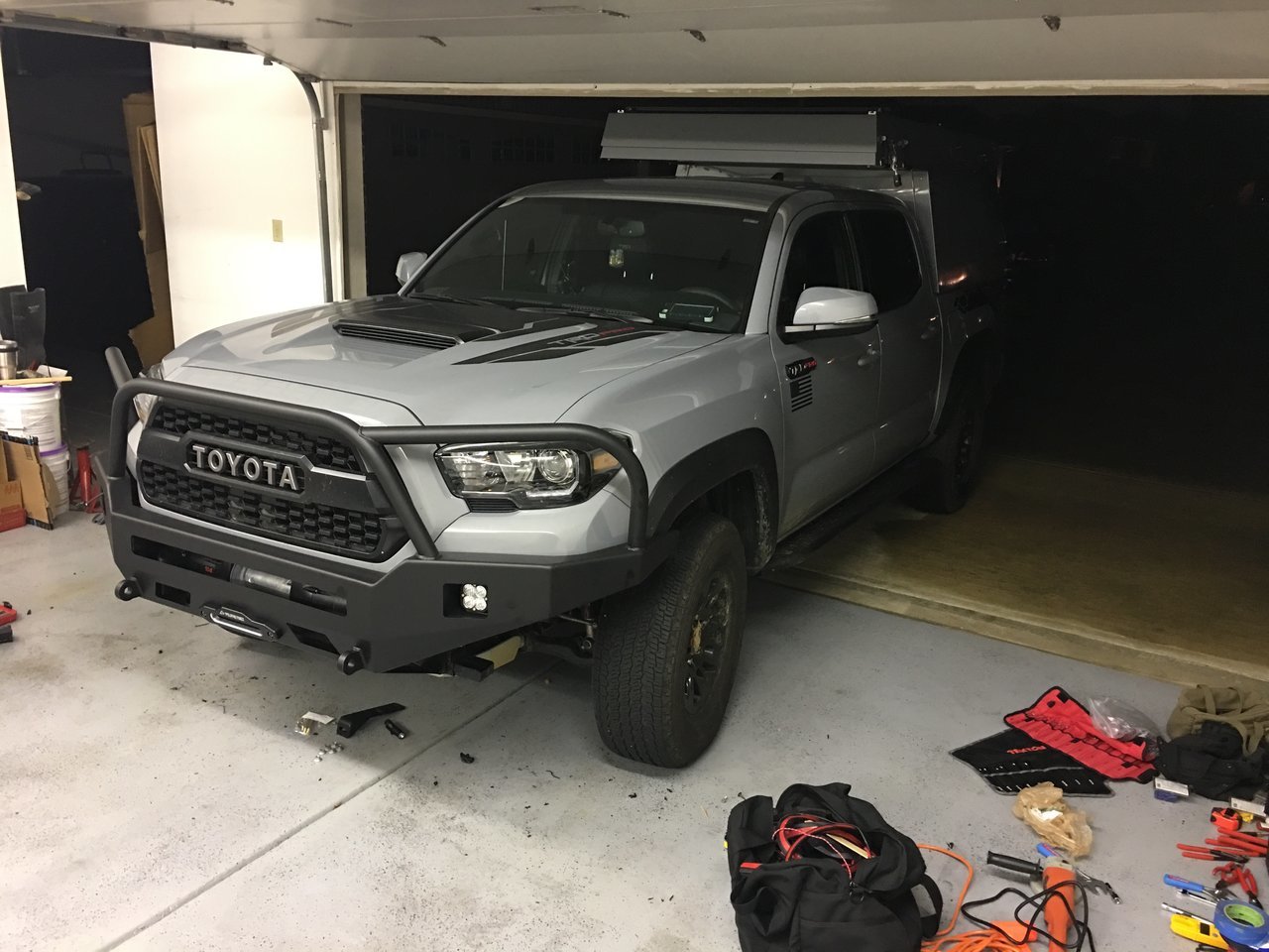

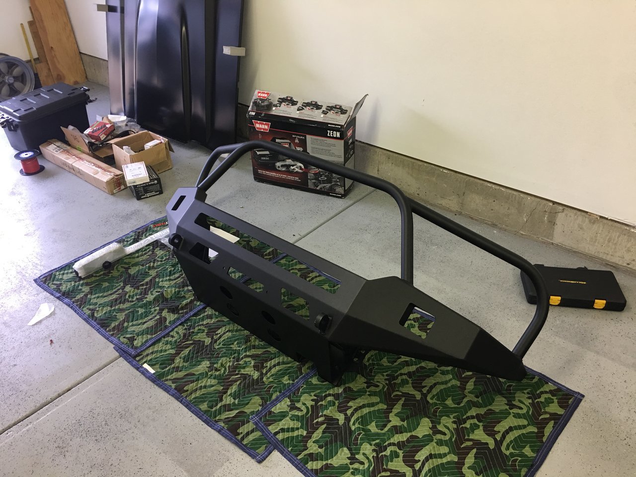

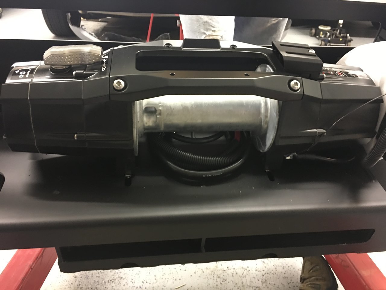

    Spent some time this past weekend visiting the folks and installing a Pelfreybilt Front Bumper. Still have some wiring to finish up as well as waiting on the Warn relocation kit for the control unit, but I'm pretty happy with the progress.

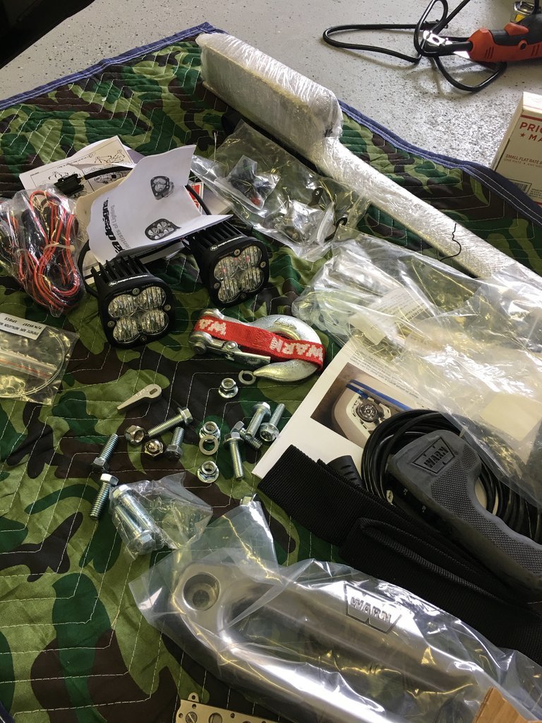

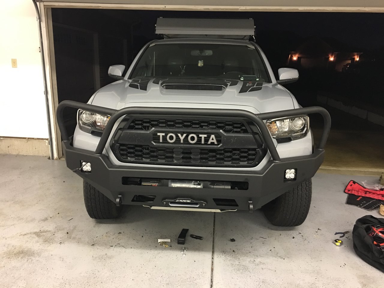

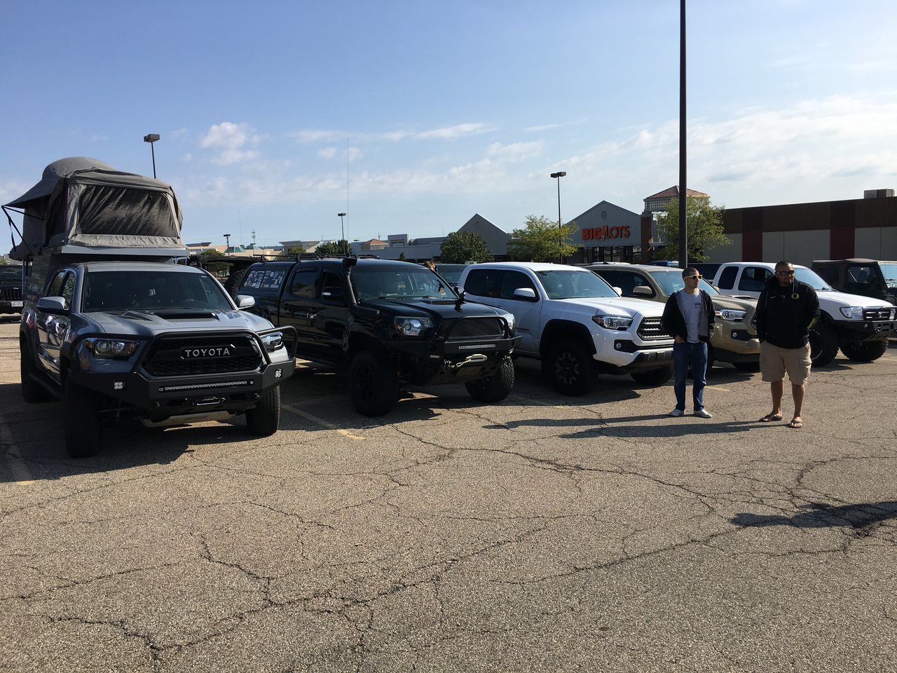

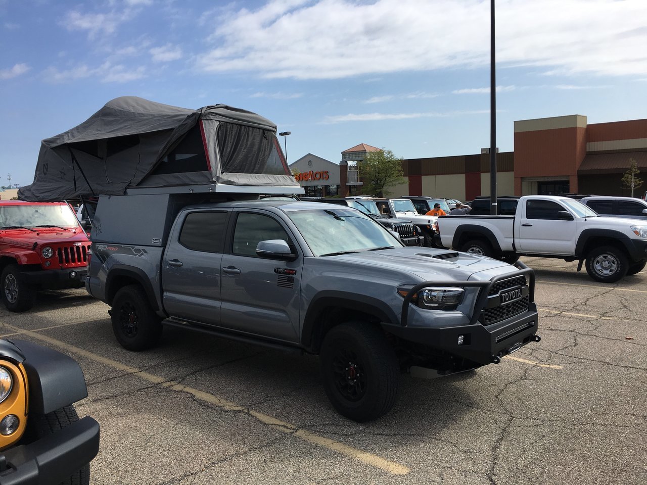

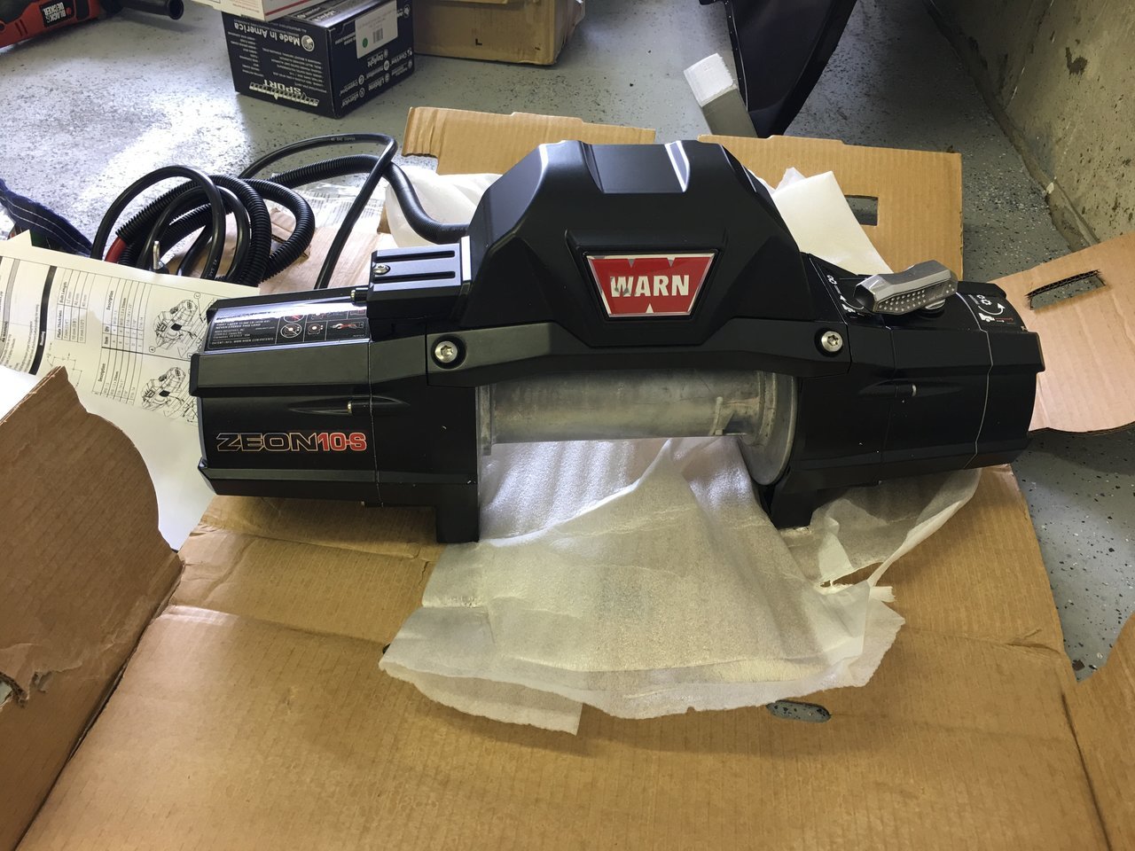

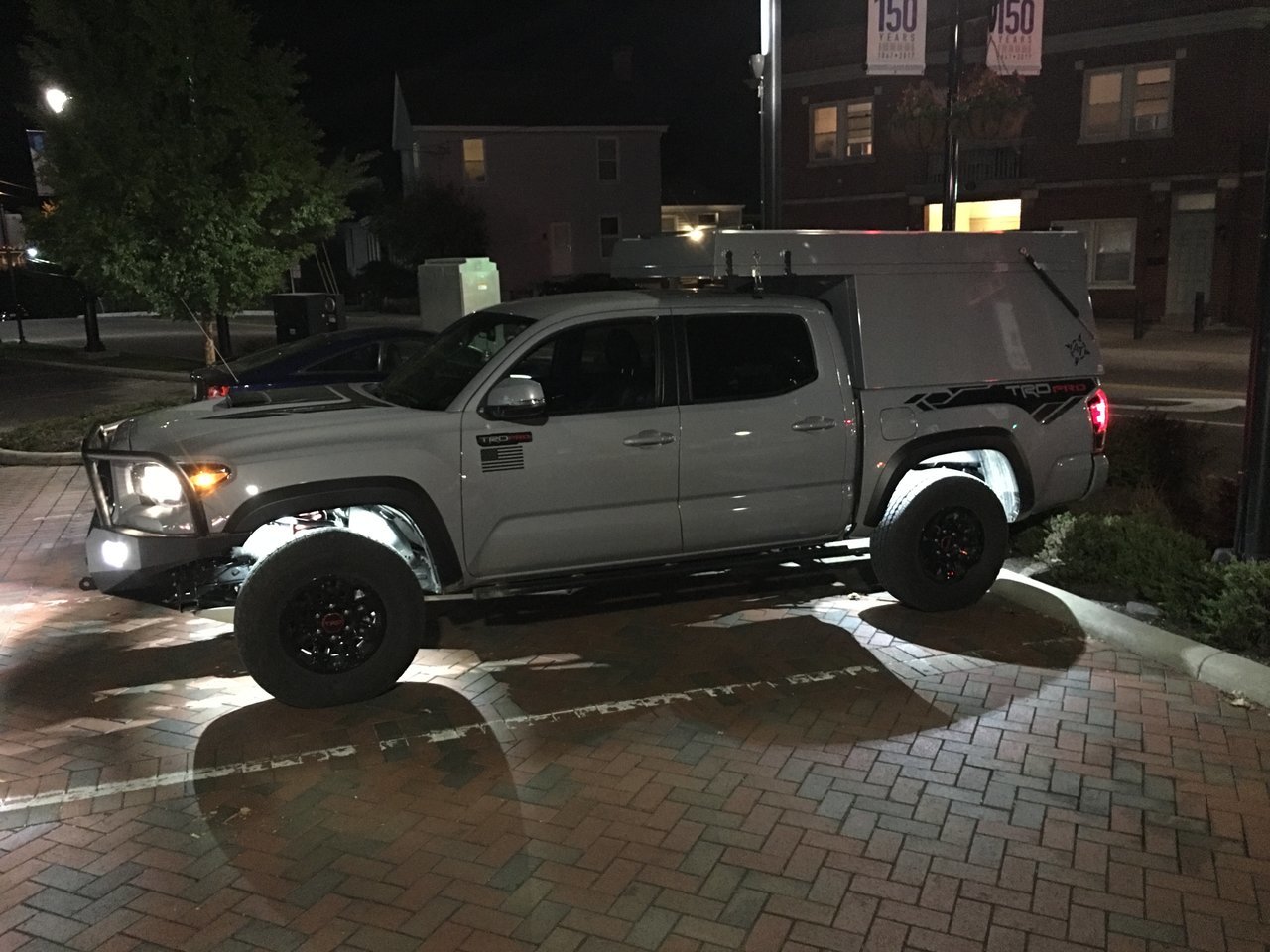

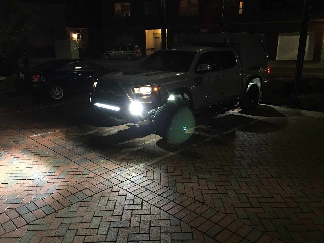

    A few pics from the tacomas at 4wheelparts opening, and my lights complete and winch spooled. Good weekend overall, great to meet everybody.

    Need brighter headlights. :rofl::bananadance::burnrubber::cheers::oldglory::yes::brianr:
