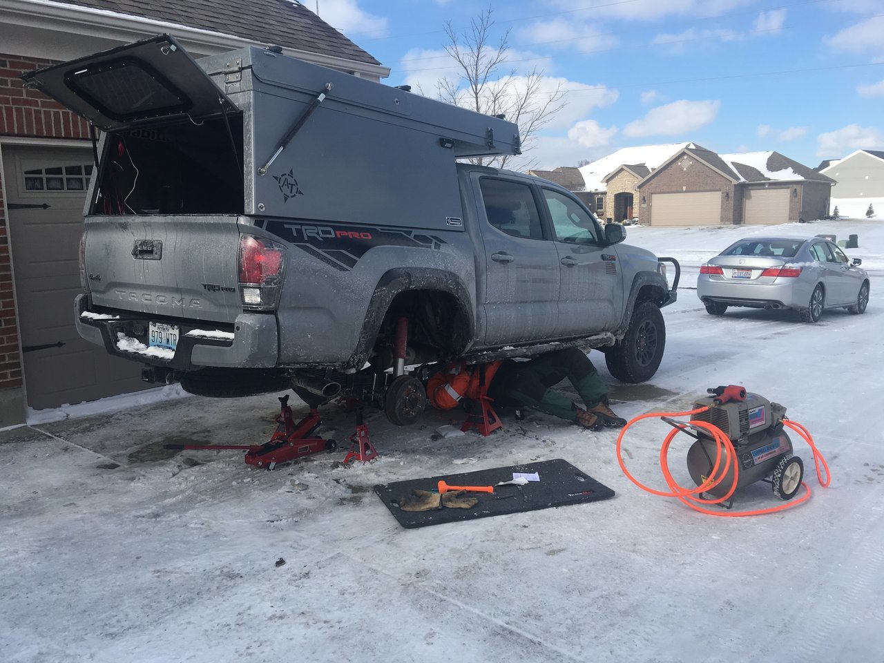

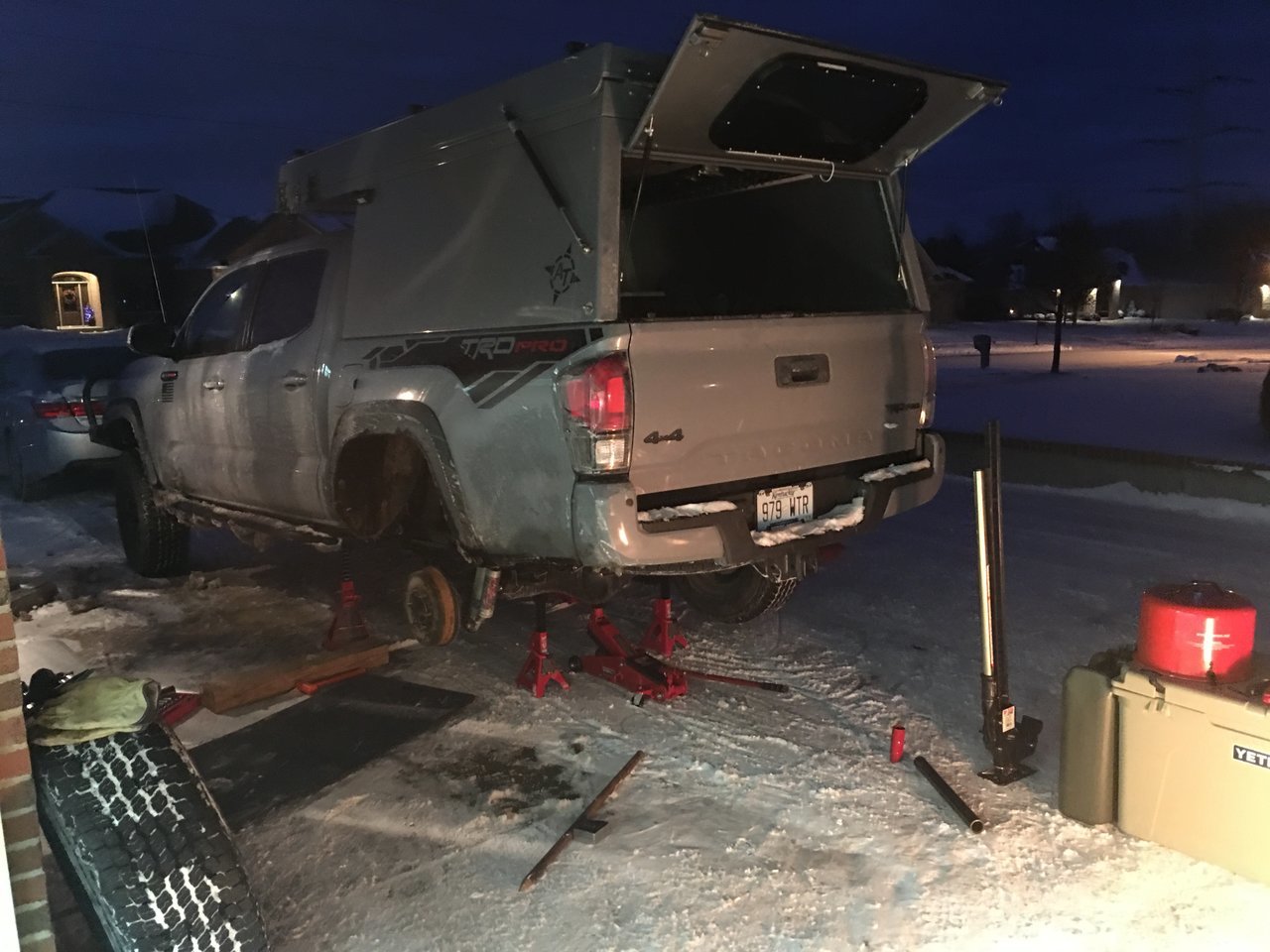

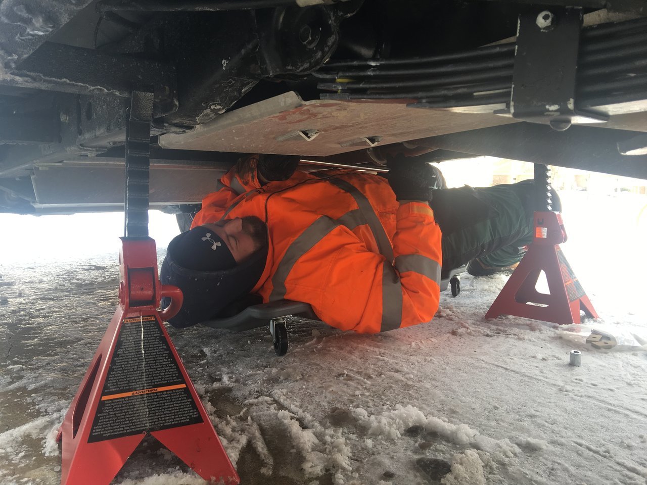

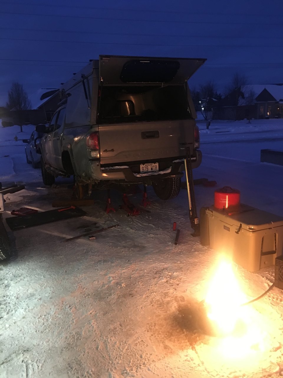

    Not all things go according to plan. I spent some time, did some research, watch videos, all the usual preparation to try to make sure we were prepared for the rear leaf spring install, but as always, something throws a curve ball.
    So drive to my parents and have my stepdad give me a hand in the frigid weather conditions to perform the install. We begin by assembling the leaf packs with the additional leafs and new center pins and press fit the bushings in place. No problem. Test fit the Superbump bump stops and trim the center pin slightly for clearance. Then all the indoor work is spent. Granted keep in mind we took a break to warm up inside every so often as it was butt cold outside.
    We go to jack up the truck. First attempt with the jack is on the side below the frame and can't get the truck high enough with my Stepdad's jack to lift the tires off the ground. Second attempt was from the rear below the center of the rear diff. Lifted the truck. Used 3T Torin jack stands on the side of the frames, no dice. We tried using some 4 by 6"s to prop up the jack stands, but they were digging in and didn't look safe. The wheels were still on the ground. Tried the hi lift, but it was starting to kick out. (Will look at attaching the Hi Lift to a bigger base for future stuff. ) So we decide a run to Menards is in order.
    At Menards, we purchase a taller jack and jack stands. New procedure is use the taller jack on the low setting, jack below the rear diff high enough to get rear axle on jack stands, lower jack, insert post extension for jack, jack up higher, install 6 Ton jack stands on either frame rail. Use jack below center of rear diff to adjust axle up and down as needed, with the small jack stands below the axle to prevent an unwanted drop whenever lowering the rear axle. Install went smoothly after that save the wind and cold.
    If you have access to a lift to do this job, please use it. It would have been much easier. Definitely requires 2 people to do the rear springs. They are heavy and awkward to hold at extension.
    I'll get some pics later this week once I hose it off in warm weather. Still need to replace with longer struts before offroading, but she has a crazy rake right now. the front will have to be done soon.

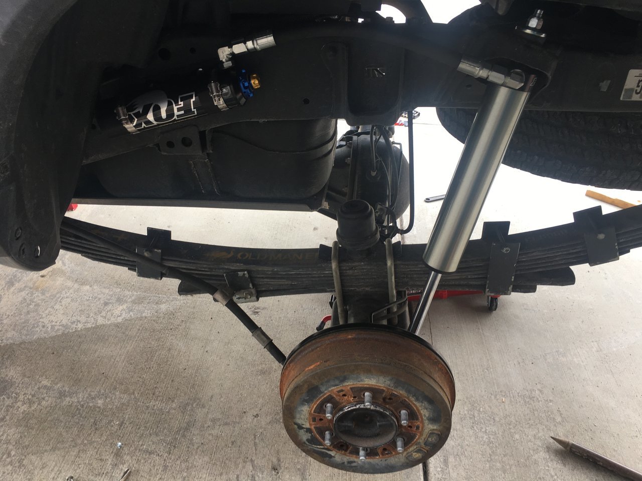

    Added super bumps to the front and installed 2.5 fox shocks with remote reservoirs and dsc adjusters on the rear. Looks glorious. F7B4AB6F-45B4-4C6C-9754-8655A4628547.jpgF3EF45CE-C2E4-451E-911D-AA55B7347D44.jpg

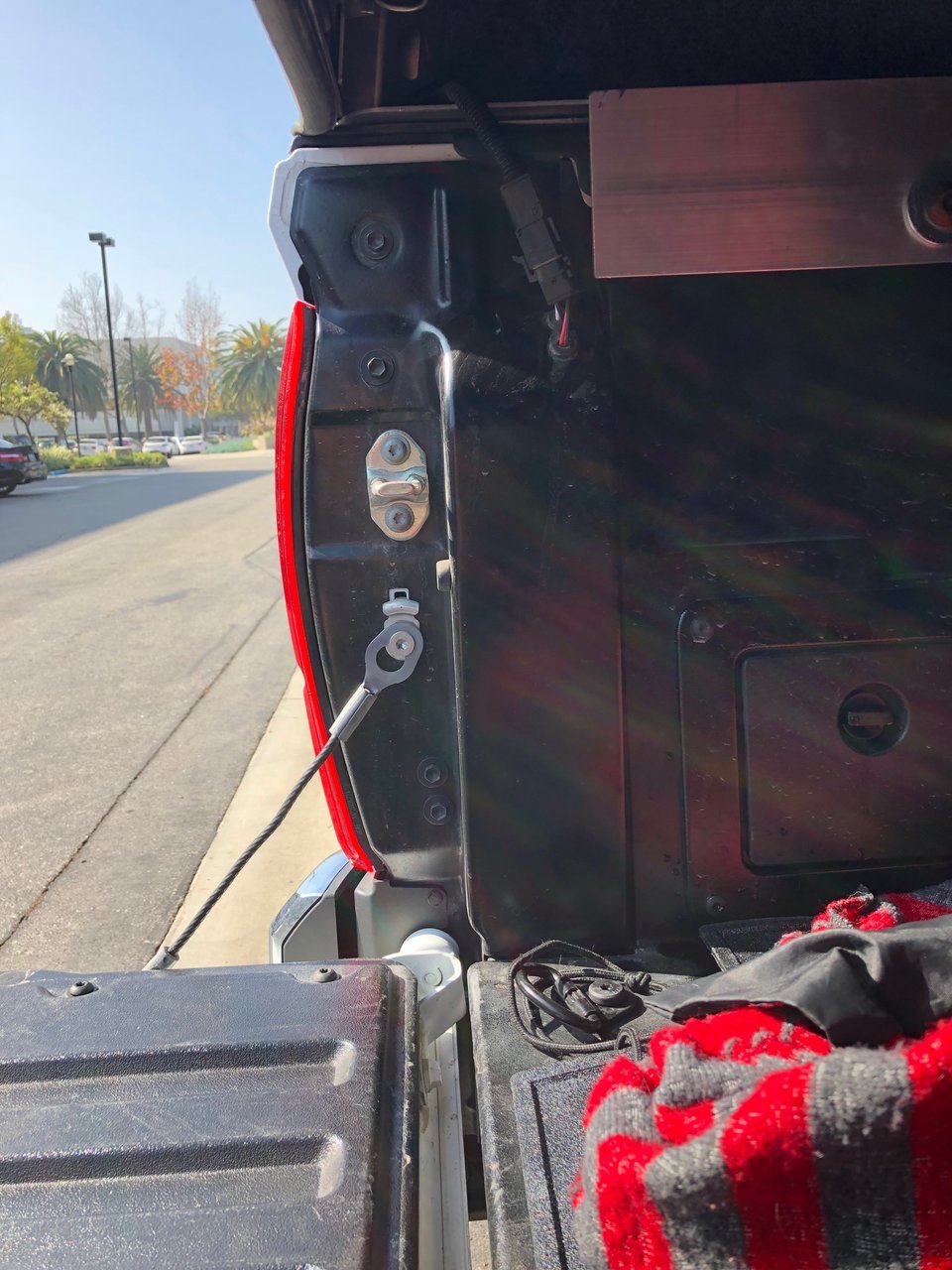

    I installed the stiffeners prior, so they didn't interfere. I also installed the Habitat myself with a friend and a forklift, so thats a different story, but honestly, all you have to do if it does interfere is rewire it. Super easy. Just remove the tail light on that side, unwire what was previously installed, drill a new hole, install grommet, rewire.
    I'll grab some pictures tonight. Though I've added a few other holes for wires to pass through there. In the middle of finishing my wiring for the back.
