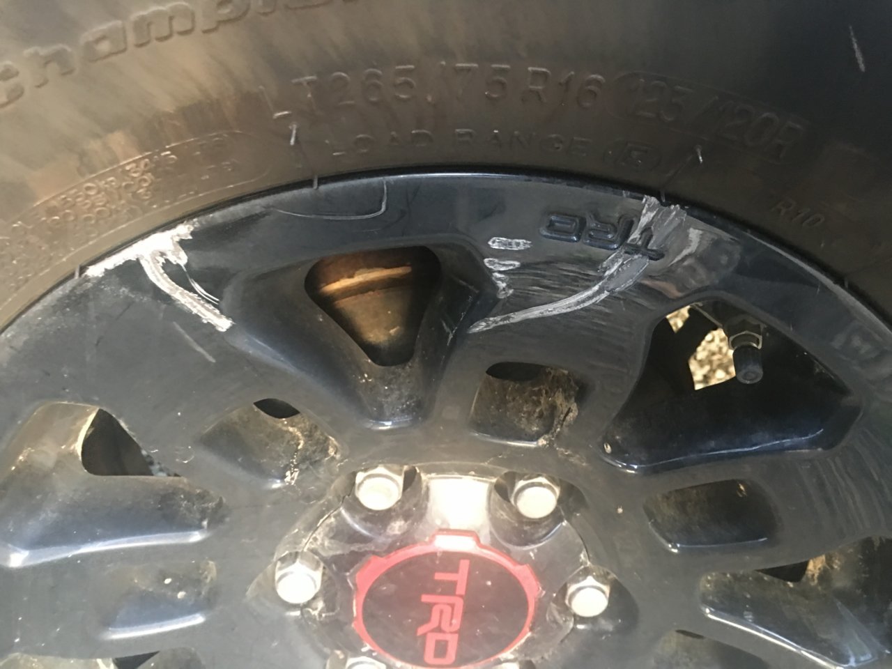

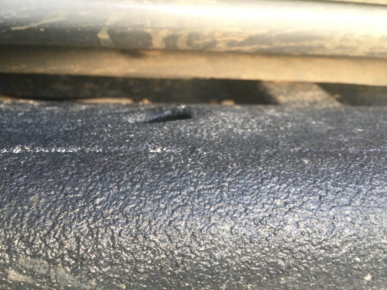

    Hit some gnarly rocks at SMORALLY when I was off-roading last. Found some trail damage. Nothing big thanks to armor, but scratched wheel and the plate on the passenger slider got bent upward a touch. Armor is so critical. I will do it again. 48F737E2-F3EA-4069-86E8-65418B8CE8C2.jpg313E3C34-755D-427E-8FB2-591EB06B8D75.jpg

    That’s a nasty scratch/gouge.

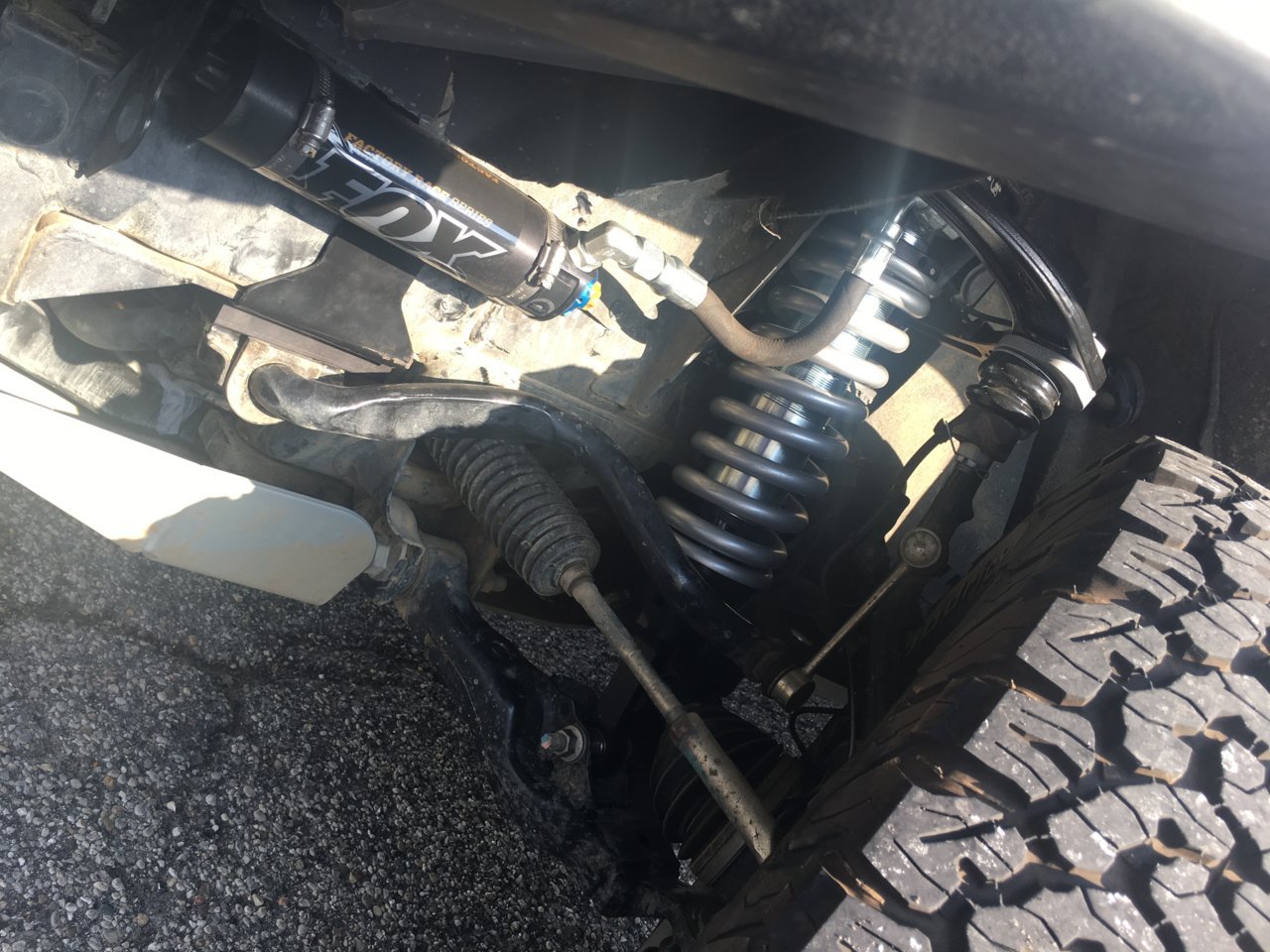

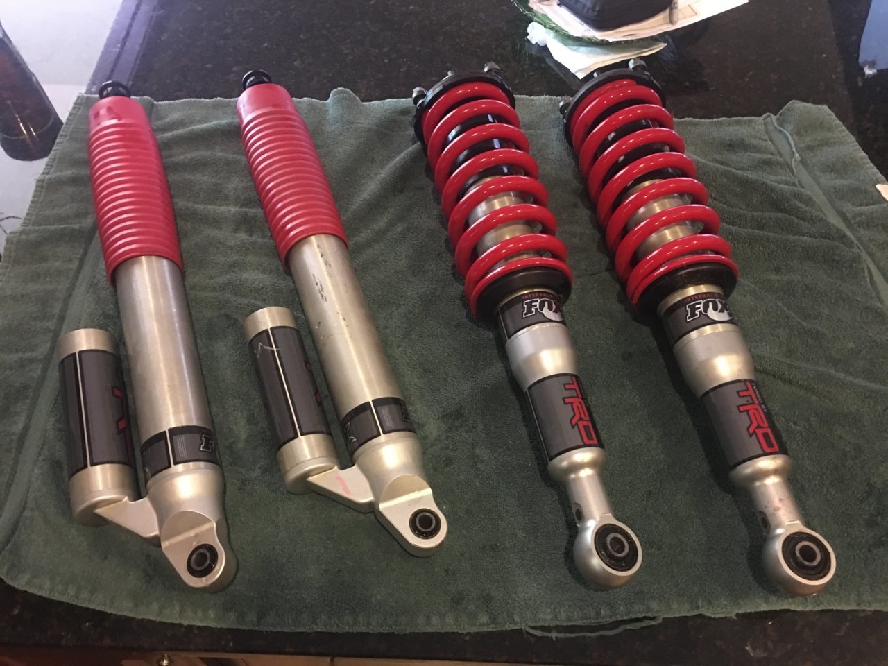

    Fox 2.5 extended travel with Remote reservoirs, DSC Adjusters and 700# springs installed. SPC Light Racing UCAs installed as well. I'll get more pics, took none during the install for some reason, but snagged a couple this morning. Just glad it's done. Rides really well, still need to do something with the sway bar interference, and getting an alignment tonight. Glad that nose isn't diving down anymore.

    TRD PRO suspension for sale. Local pickup only. PM for price Cincinnati OH area/Northern Kentucky
    20000 miles on rears 25000 on front. Mostly highway driving. a few minor scratches on the rears, but in great condition otherwise.

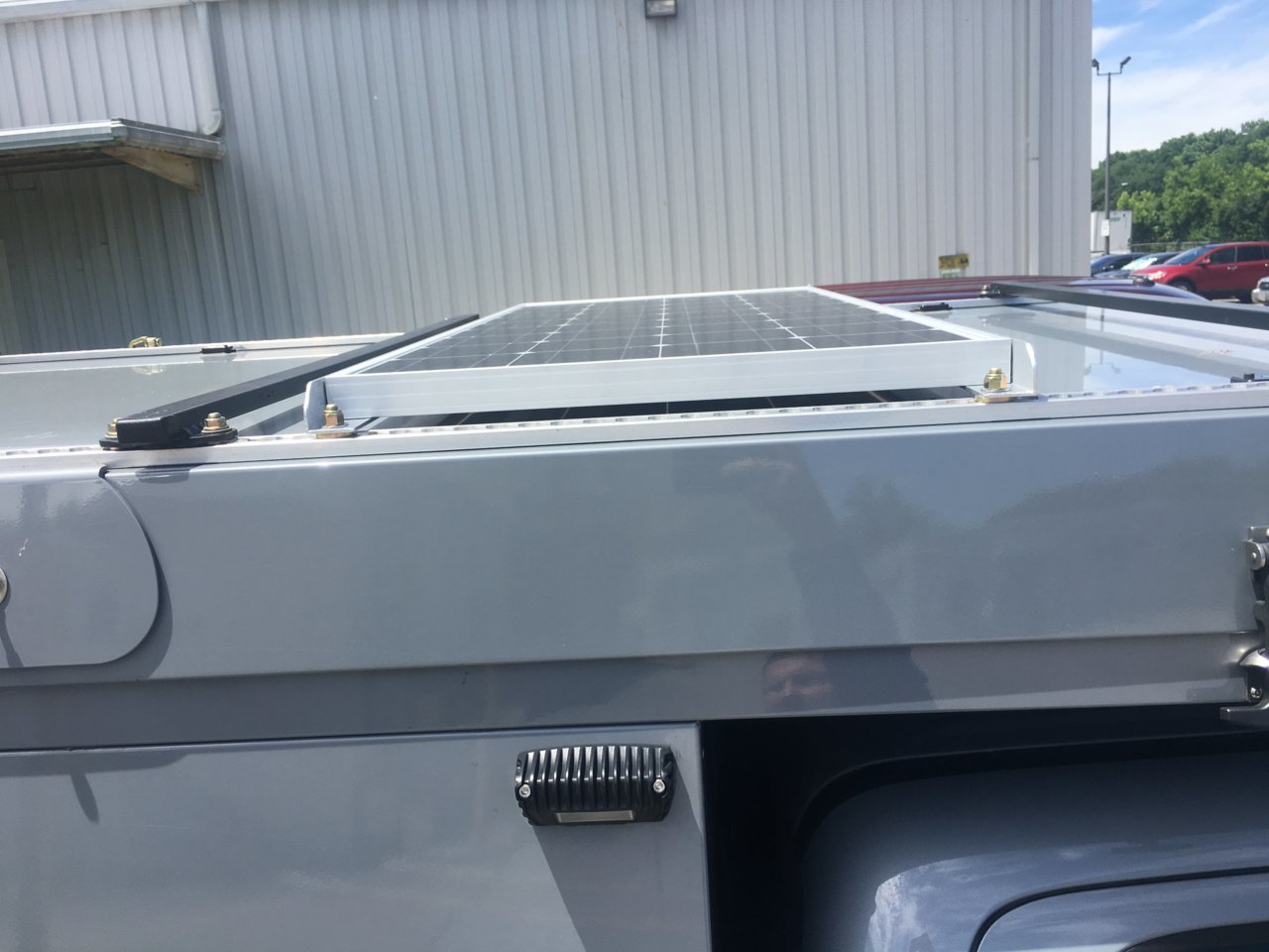

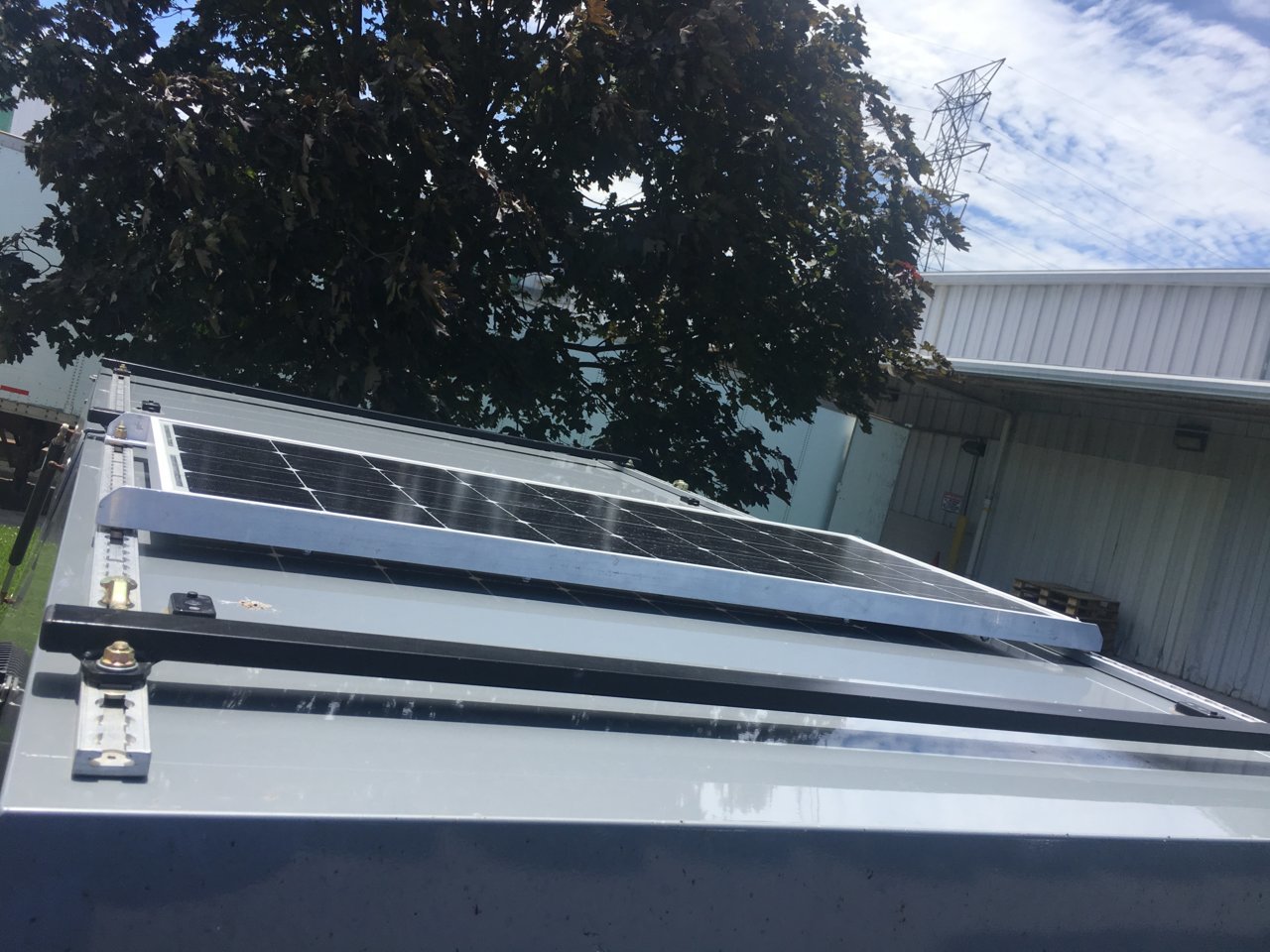

    Had a busy day Saturday. Smoked 4 pork butts and made the mounts for the solar panel and test fit the panel. Still needs to be wired, but that involves silicone and drilling holes in the lid of the habitat, which is best done with 2 people in dry weather. Happy with how the panel turned out. I Could mount a second one if needed, but we are going to see if 1 panel will be sufficient. I will likely paint the aluminum black , but this worked for now while it was being test fit. The L track and fittings are super easy to work with and install.

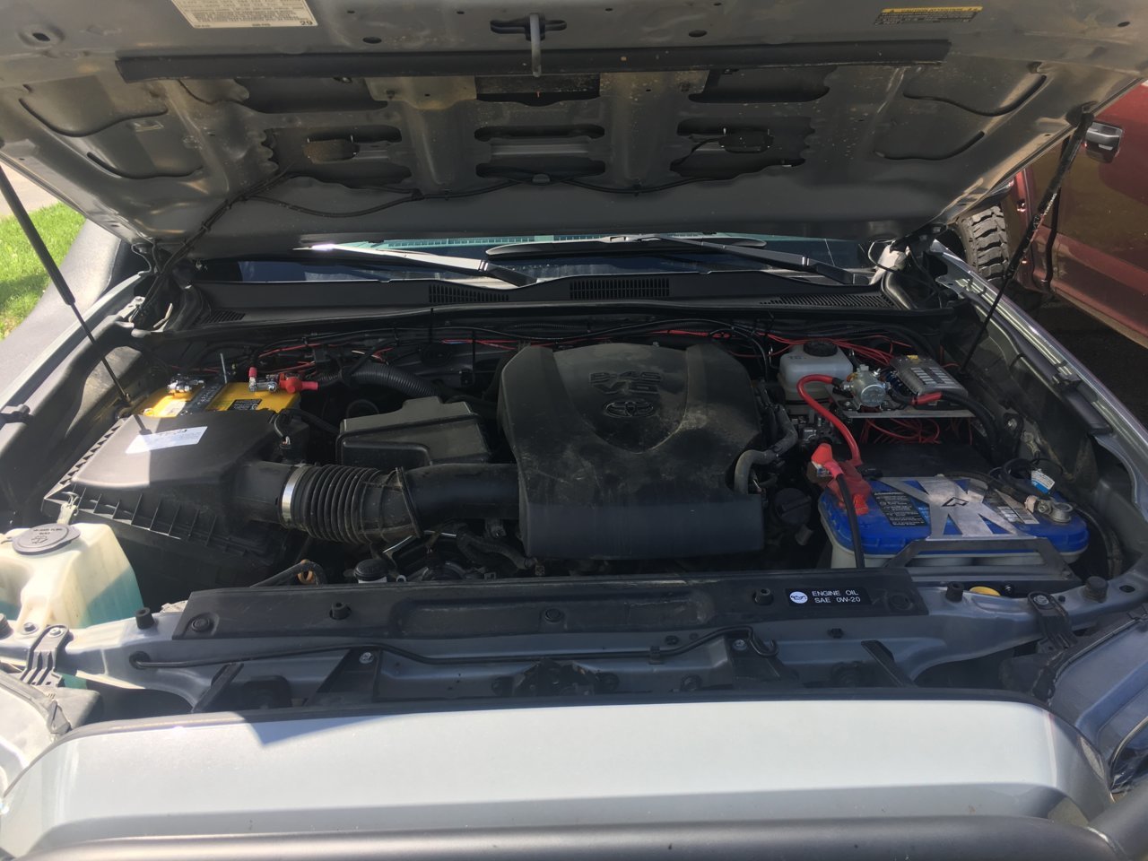

    I also finished the wiring for the dual battery system and tested the ML-ACR with all of my stuff. I have relocated the power for my added fuse block to come from the auxiliary battery. Went really well and happy with the installation.
    This should have me ready for installation of the fridge, wiring for the solar panel, mounting of the charge controller, and some power monitoring things I have had planned. All of this is to happen this upcoming weekend. Should be a good one.
