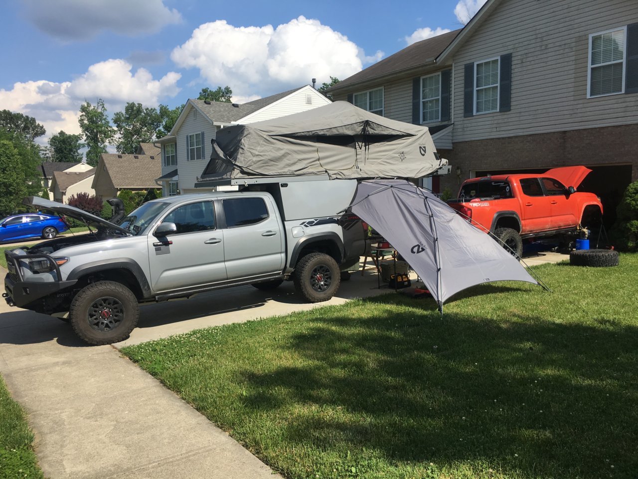

    Spent Saturday morning recovering and hanging out with a buddy planning the next phase of mods. Wandered over to @Jibbs to bs and grind on his truck for a bit as he swapped UCAs and hang out. Mostly just prepped wires for routing on Sunday. Played with my new Adventure Trailers Nemo awning to try and get some shade in the heat of the day. Josh was a great host and thanks again for letting us come out.
    While we were out there, we spotted a rare siting. We were visited by the capless mud duck and @mwc273. IMG_2521.jpg

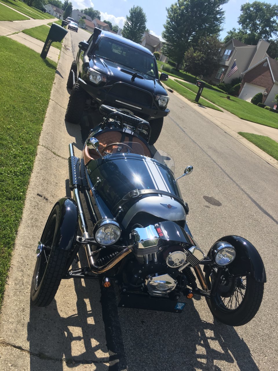

    Also, one of Josh's friends brought over a slick little toy. A Morgan.
    Good time all around. Lots of laughs.
    On Sunday, wandered over to my buddy's place and continued the work.

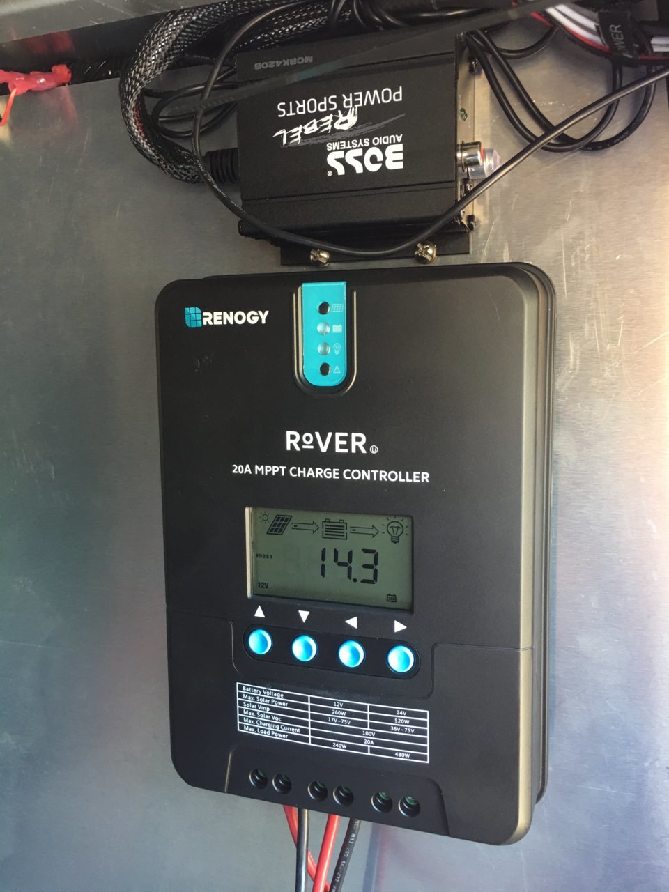

    Got the solar panel mounted and wired in. Also started work on the bluetooth speakers.

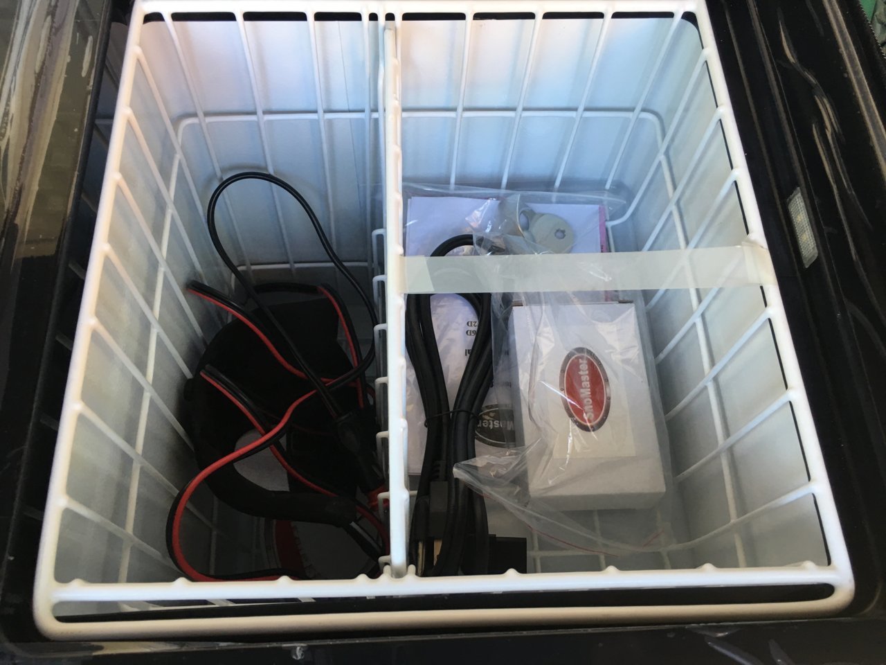

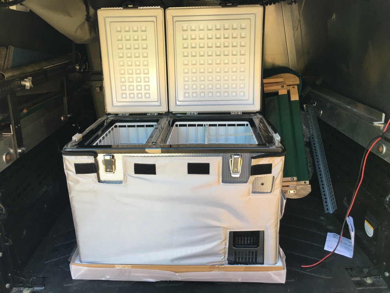

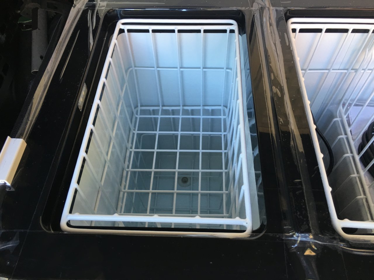

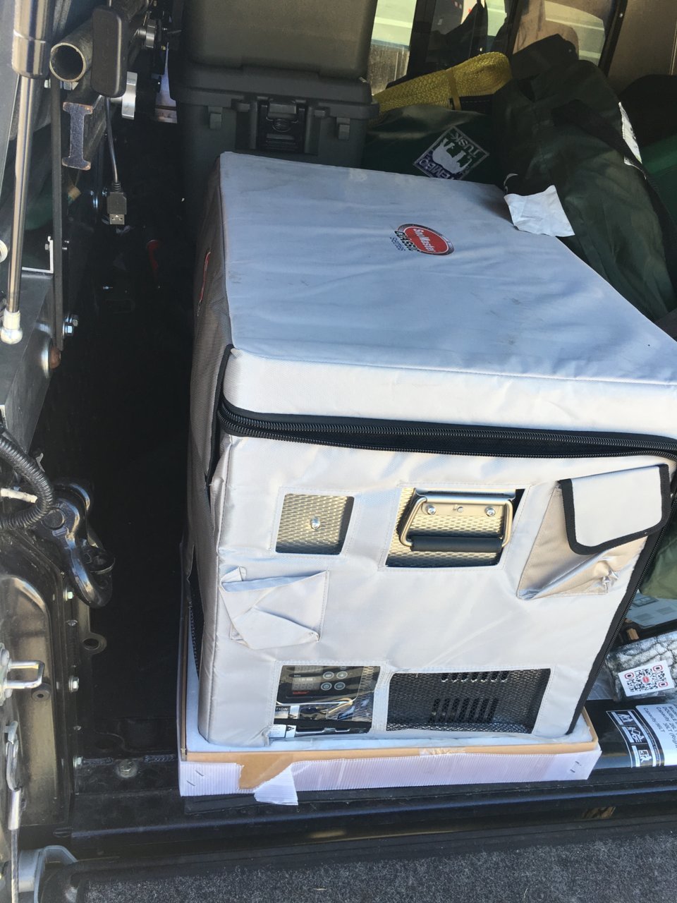

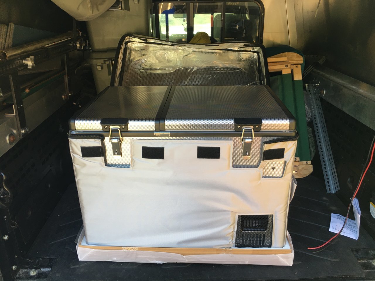

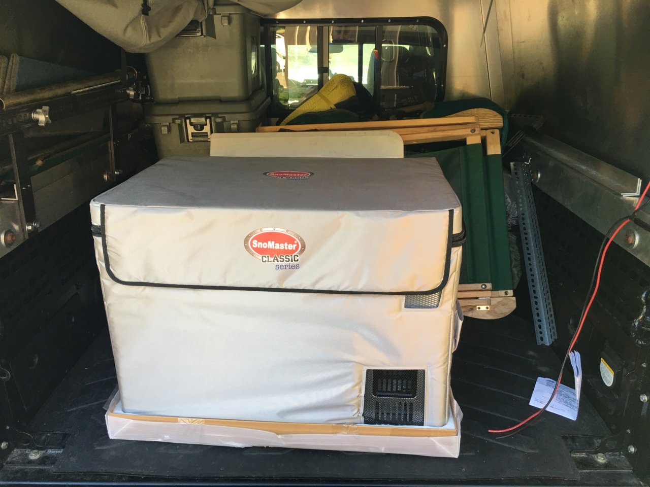

    Monday after work, picked up my new fridge freezer Snomaster CL56D. Very excited and wired it up yesterday. Still doing plenty of testing. IMG_2528.jpg IMG_2529.jpg IMG_2530.jpg IMG_2531.jpg IMG_2532.jpg IMG_2533.jpg IMG_2534.jpg IMG_2535.jpg

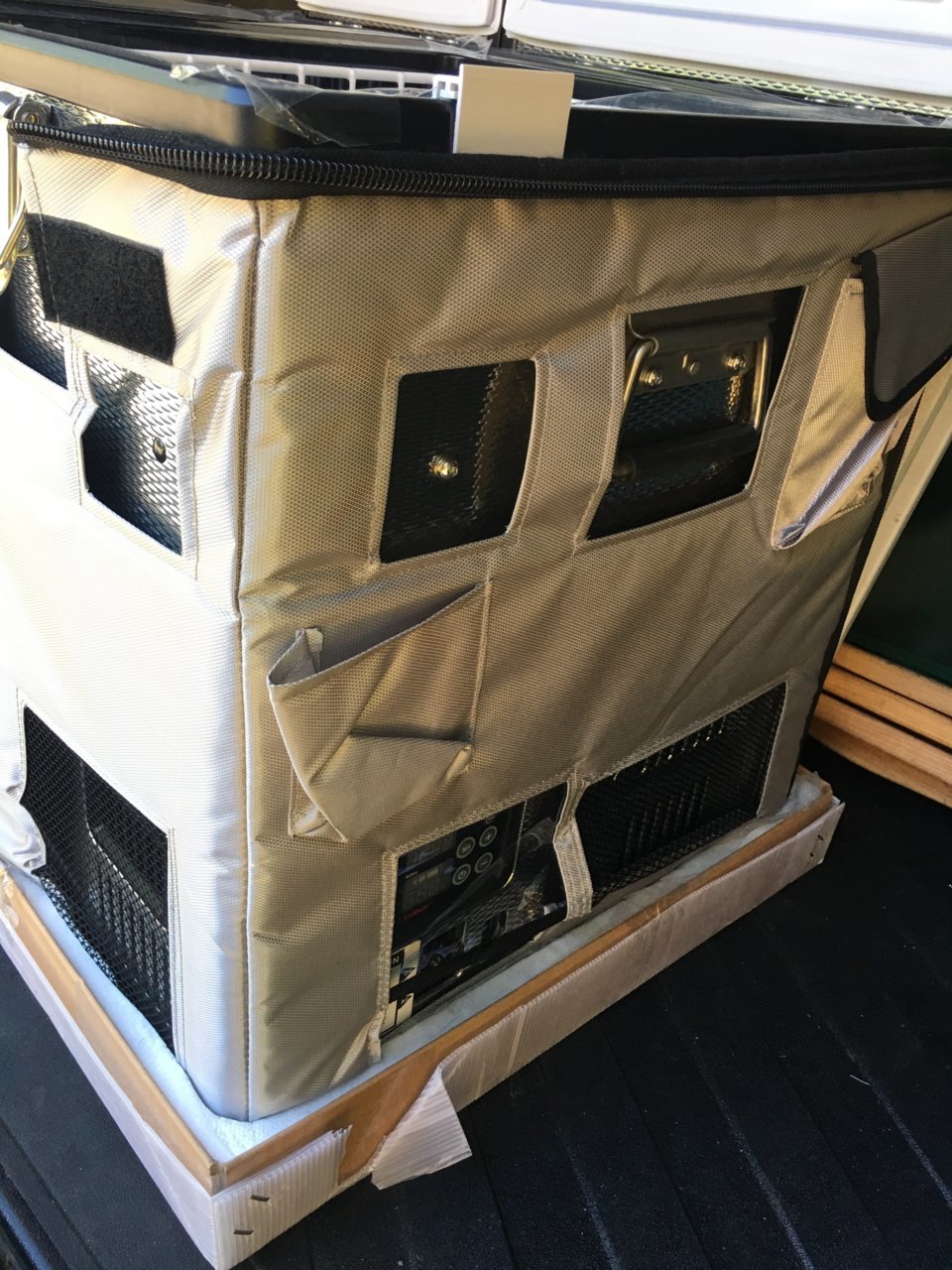

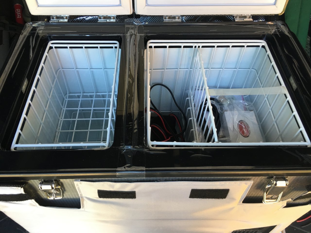

    So I've been doing some fridge testing. I was surprised to learn there are a few important things to realize about these things in vehicles. I knew our stock alternator needed help which will be a later topic, but for now I have a Optima Bluetop group 31M battery as my primary, an optima group 34 yellowtop for my house battery. Unfortunately, 75AH and 55AH may not be enough depending on how I manage it. Before any trip I will load the fridge with cold stuff and be sure the fridge is cold having been on AC power. This is super important. My first test was a 24 pack of 500mL water bottles just bought from the store. 12 liters or more than 3 gallons of water at room temperature to bring down to temperature. The power system had no chance. The critical thing to know is that these systems will cool, but are really better at maintaining temperature as opposed to chilling warm things.
    I believe what I'm trying to say is that vehicle fridge management is more important/difficult than cooler or home fridge management. My goal is to be able to safely refrigerate and store items for more than a day with no intervention by myself or the alternator. Cold beer anywhere, anytime.
    The end result will hopefully be a system that works year round and doesn't require too much fuss. I plan to expand first the battery systems and install a 200AH AGM battery in the bed. This will allow for a level of reliability in the system. I will also install an additional 100 W panel to fully provide the needs for the system. This should allow for multiple days and still safely charge everything. Here's the battery.

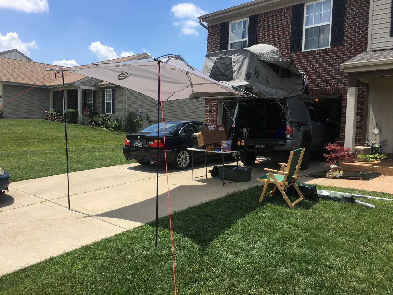

    Also, for the awning, it came with some channel for mounting onto the truck. I'm choosing to use L track instead. I will be mounting these all over the place. I can use these clips to attach pretty much anything to.

    I can, but it provides an instantaneous number as opposed to a totalized amount. Other than that, I'm very happy with the menu and clarity of the charge controller. I'd definitely recommend Renogy panels and their Rover controller, though, give me a year to solidify that.
    I have a 66W compressor on my fridge that in theory needs to run 50% of the time, so this ends up being it will require 66 amp hours a day to maintain cool. My batteries isolate and my 55AH battery won't provide 66AH. Batteries should never lose more than 50% charge, so I require a minimum of 132 amp hours, add a few LED lights and such and round up a bit and I figure a 200AH battery is just about perfect.
    For pulling the initial heat out, keep some water bottles in the freezer at home, chuck them in everywhere, should help.

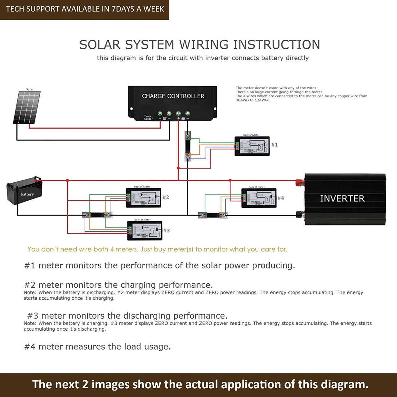

    There are some great measuring tools on the market for a pretty decent price. Adding a shunt and monitor, you can track your systems input and output.
    100A Current Shunt
    As far as panels, I will probably be going with Renogy as well. I wanted to do the Panasonic HID panels, but the voltage output is too high for the solar charing system I have.

    No worries. Well the ML-ACR is pretty straight forward. Run a heavy duty cable (minimum of 4 AWG, I used 2 AWG welding cable between the batteries) to connect (-) to (-) or ground to ground. Then off of my primary battery all of mine are AGM, you should only connect batteries of the same type together. I ran a fuse block and 200 amp from the (+) side of each battery with the same size cable to either side of the ML-ACR(doesn't matter which side). You'll want to heat shrink and crimp all of the cable ends onto the lugs of course. terminate the ground for the ML-ACR. hope this helps.

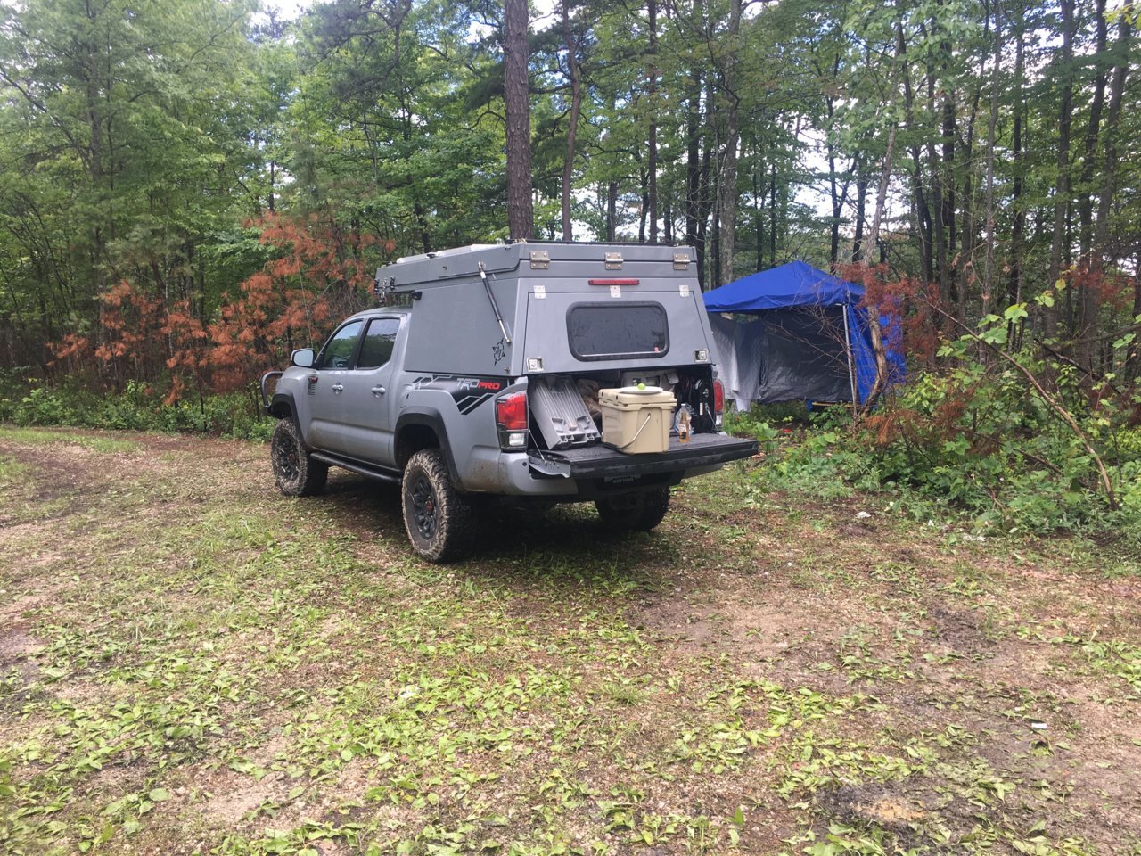

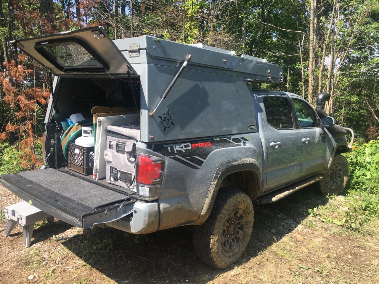

    Quick update from the RRG trip two weekends ago. Finally getting around to it.
    First things first, time for a Corona.
    The camp was basically on top of this hill at the dead end of a road with great access for all manner of camping, but well hidden with a decent view all the way around. I was pretty impressed overall.
    Random camp pictures. Most people were setup in hammocks or ground tents for this trip and the EZup city was already constructed.

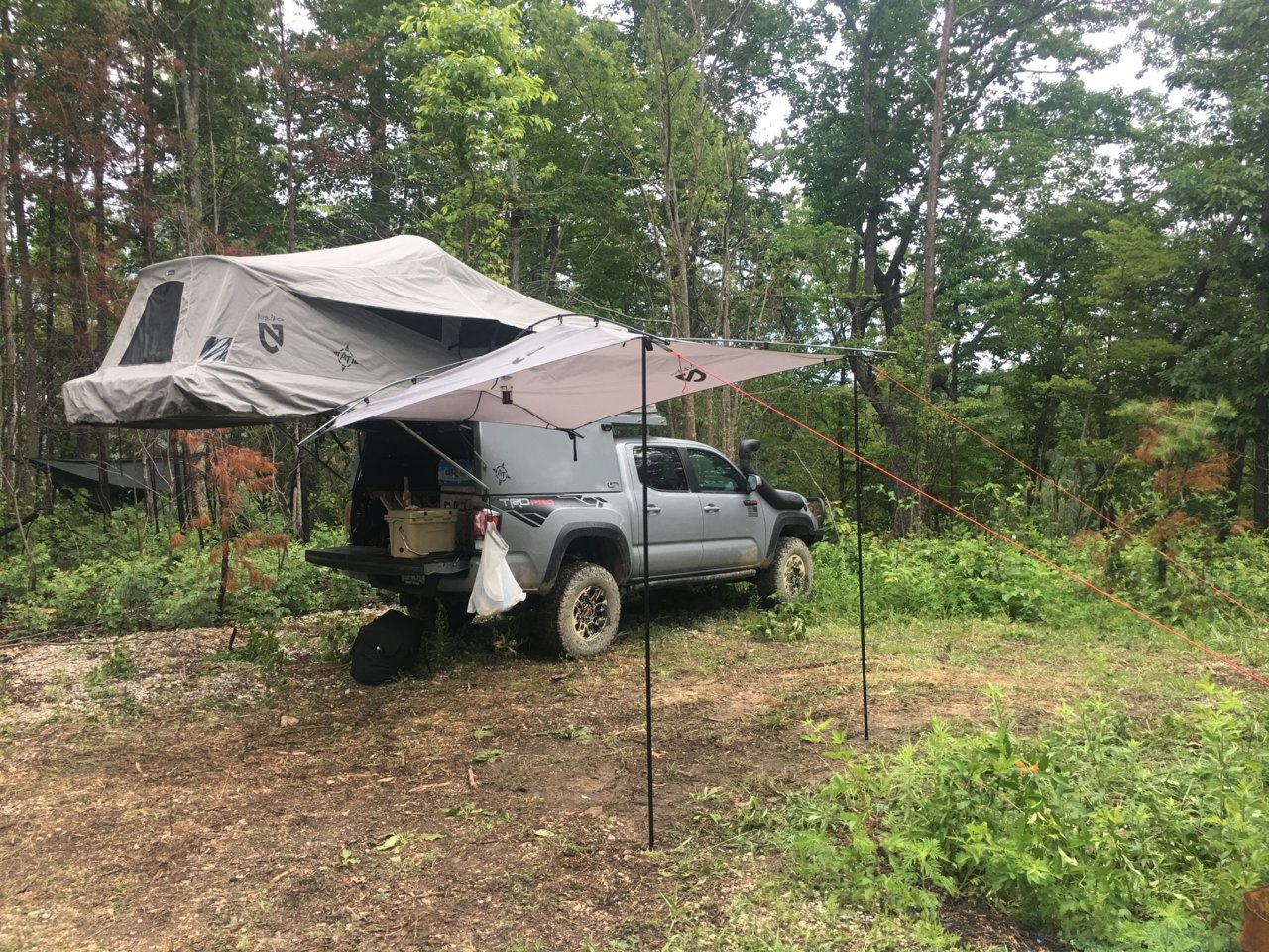

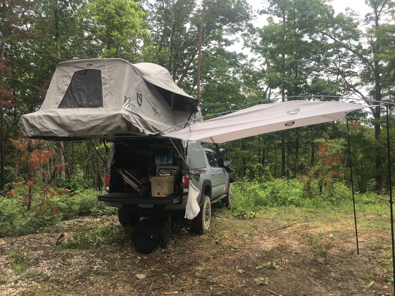

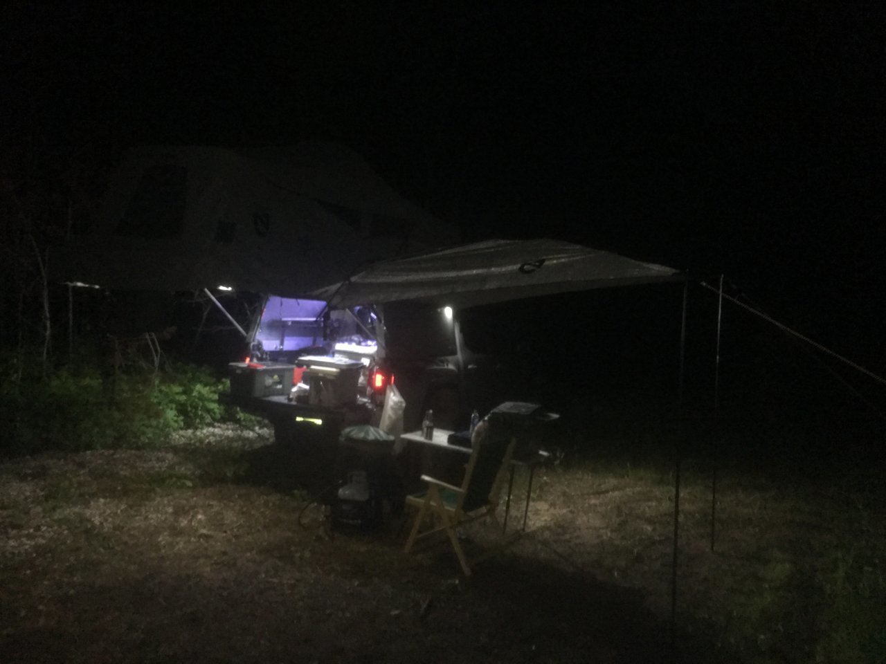

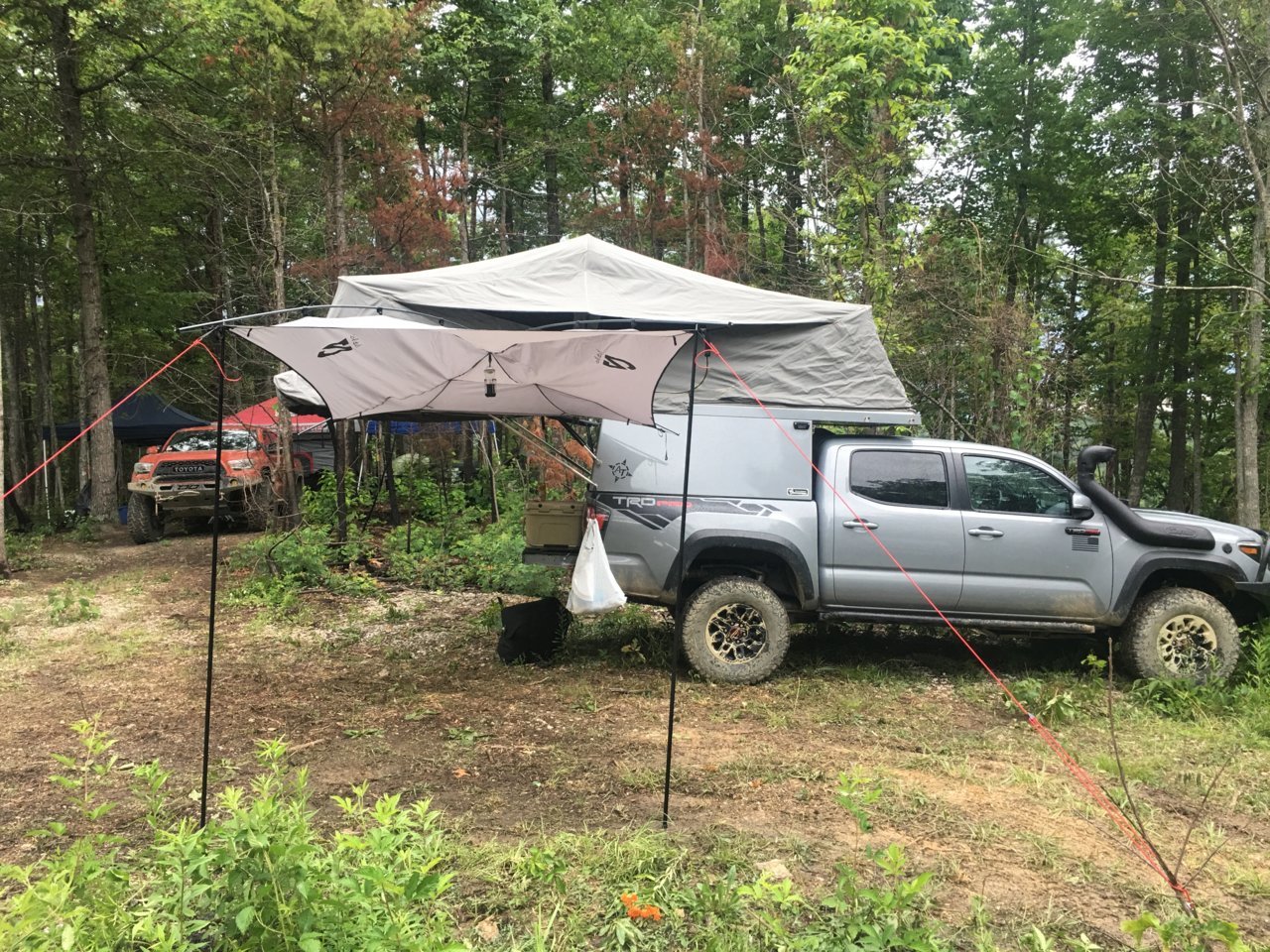

    Had to try out the awning for a bit the first night and figure out what the best configuration was for the trip.
    Made a quick dinner of burgers with mushrooms and onions on the skottle for the Friday night. i should have taken a picture of the other skottle meals made, but this is definitely my go to cooking apparatus in camp.
    Some beautiful sunsets through the trees with all the rain.
    Camp at night
    The next morning after a breakfast of bacon and eggs with veggies, it was time to get the truck dirty.
    I didn't take to many trail pics, but it was a good ride. along the way, we stopped off at this cave and joked around with a group of side by side riders, etc. It was a good time.
    Back at camp with a few scratches, but ready for another nice evening.
    Saturday night sunset.
    Shenanigans.
    Overall, a good weekend with plenty of fun and I look forward to the next one. Definitely an area with plenty to explore.
