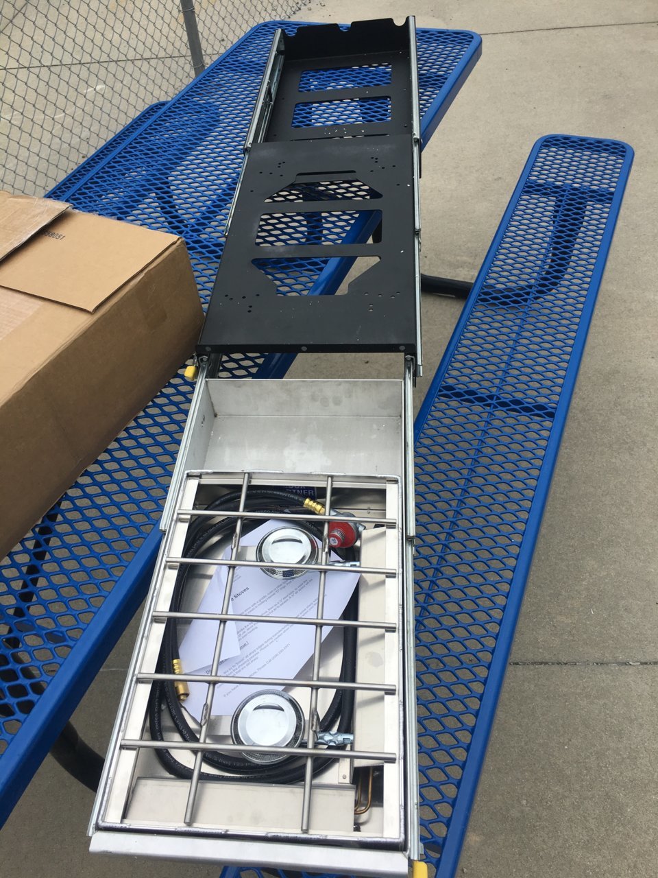

    So following the RRG meet, I was able to get in my Comboslide and do some work on the truck.

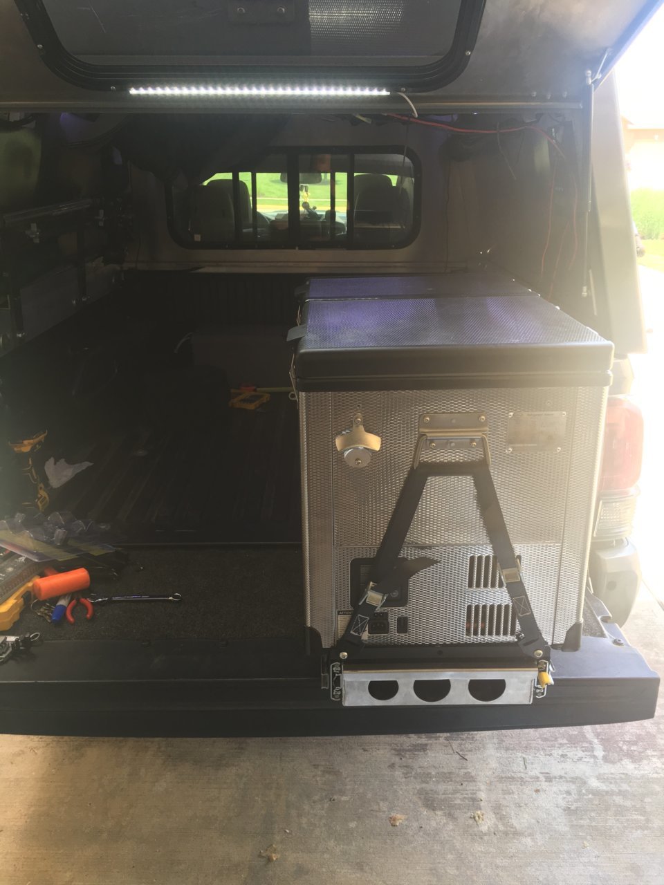

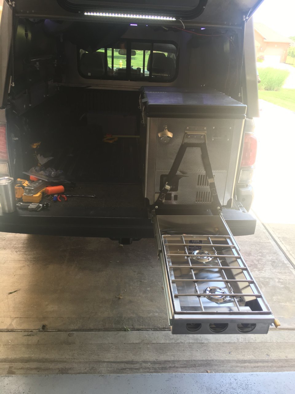

    The next two pics are the Comboslide closed and open. Honestly, this thing is a game changer. just the ability to slide the fridge and freezer out saves time climbing into the back of the truck every time to get things out or put them away. I'm a fan.

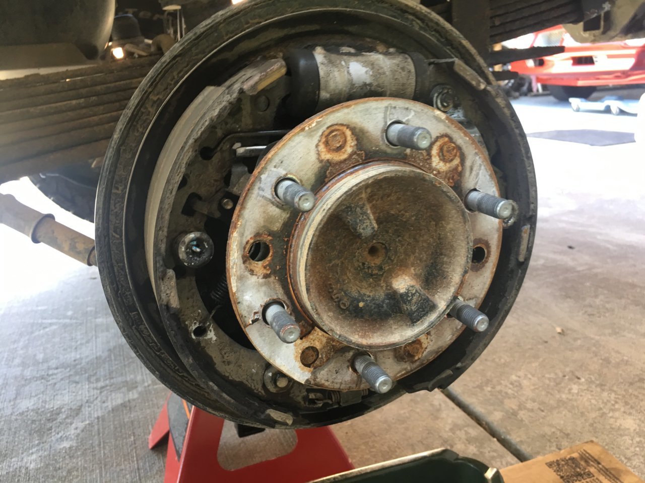

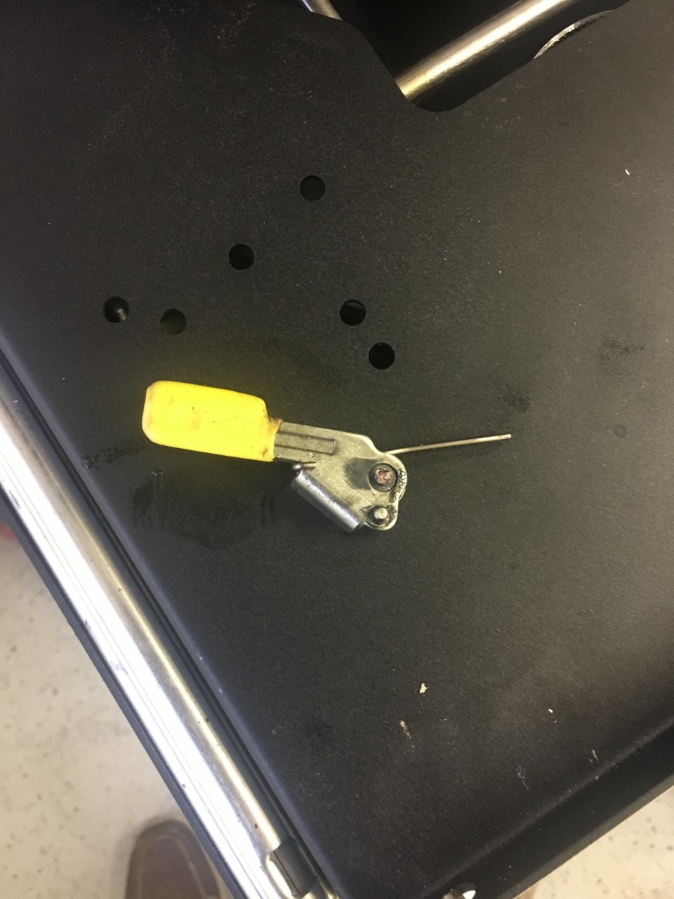

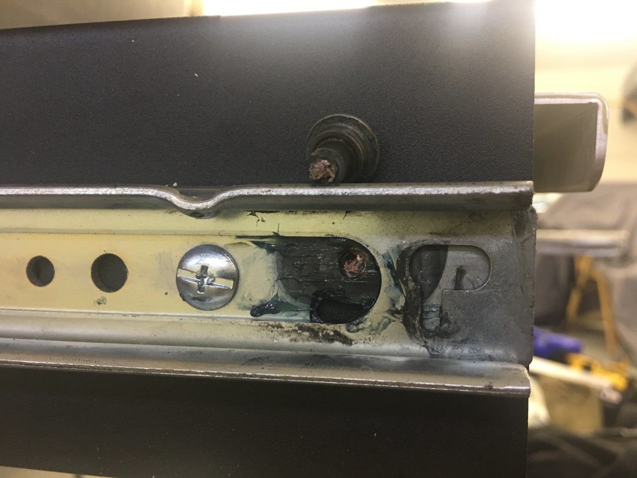

    So I get up to my parents house and go to show my stepdad the slide and the shoulder pin got the fridge slide latch broke. Looks like a defective pin. Sent an email to Adventure trailers and the next business day, they replied to my email and had shipped the replacement for me. That's great customer service. They definitely stand behind their products and make it right.

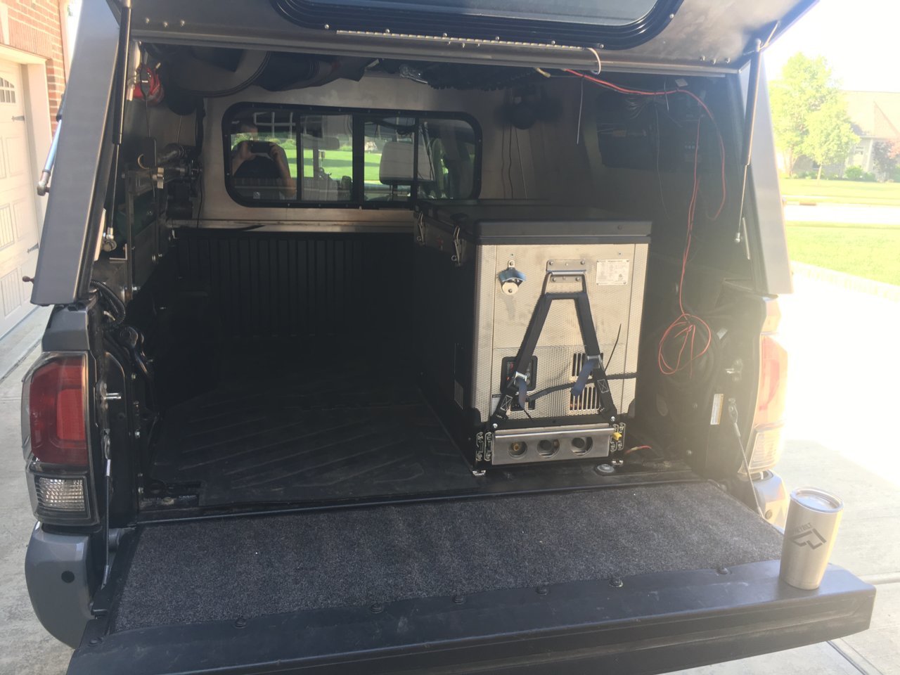

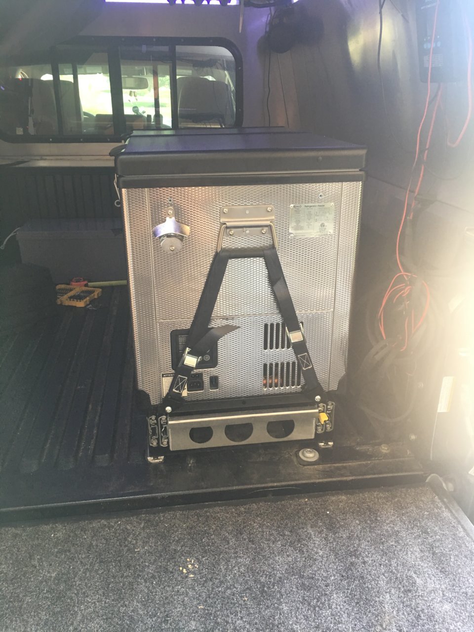

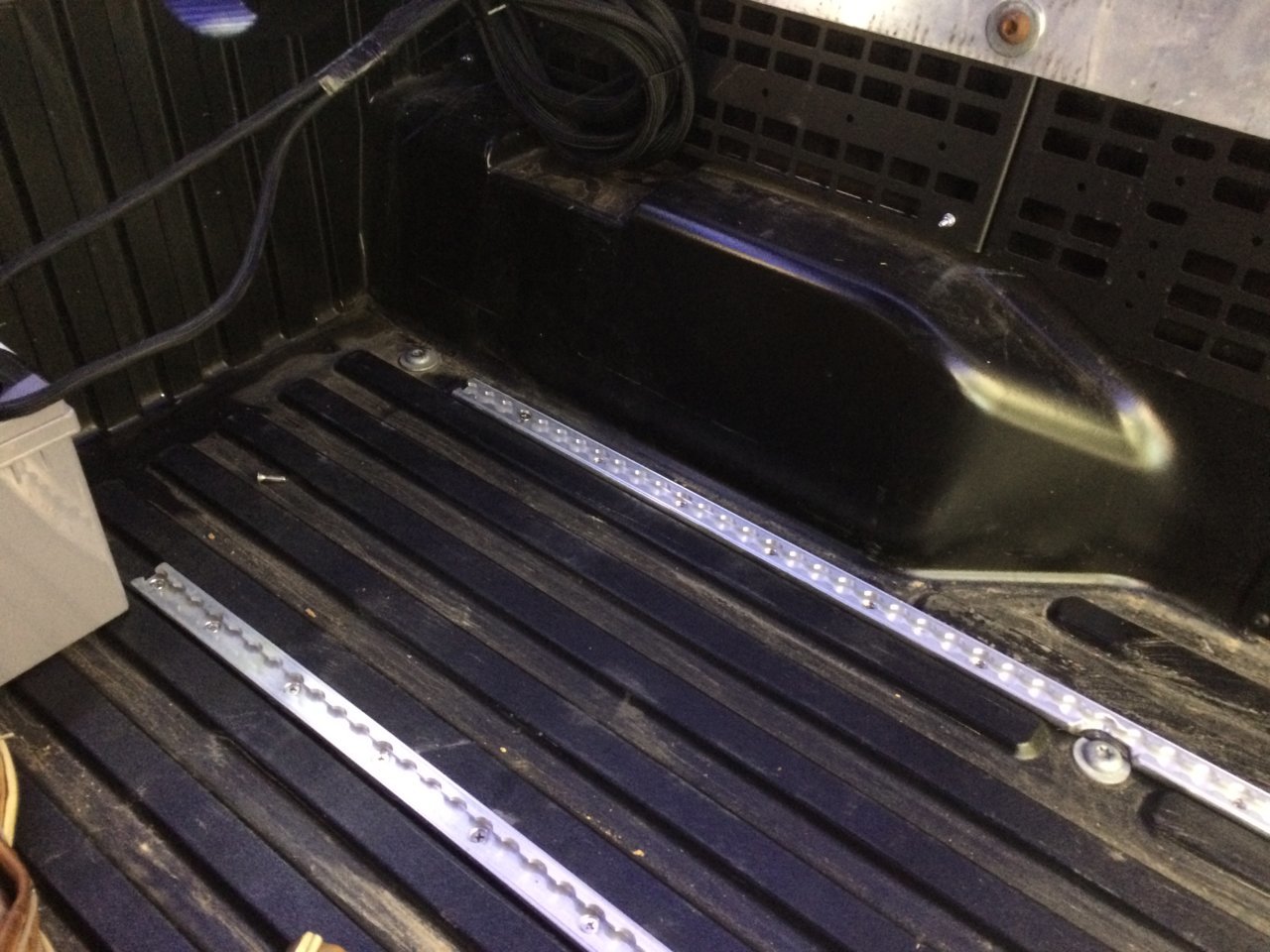

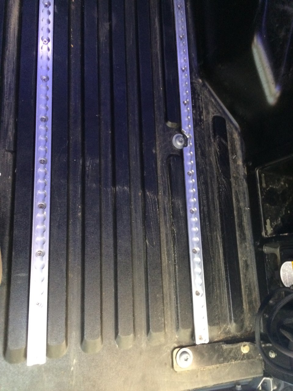

    So to mount the comboslide, we are using L track that Chris and I had cut down and ground to fit the tracks. This is mounted using butyl tape for sealant, and 1/4"20 stainless hardware. It is completely flexible.

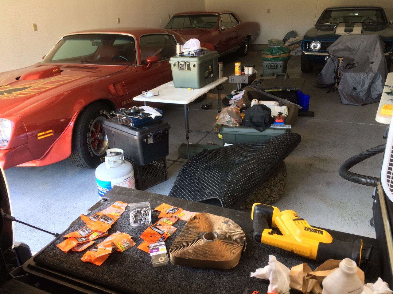

    When you unload your truck into the open bay of a garage and the project boxes are everywhere. Spent a good bit of time this weekend sorting and organizing my stuff, threw away an entire garbage bag of trash and packaging from the project totes. I was able to sort through all the hardware and put each type in a bag, so things wouldn't be as chaotic. The goal was to get the truck to a place where I could get into a project without having to hunt for things or know what I have, so I didn't just buy new every time I wanted to do a project.
    Comboslide mounted on the rails with the Snomaster on top.
    Fridge slide extended.
    Stove extended.

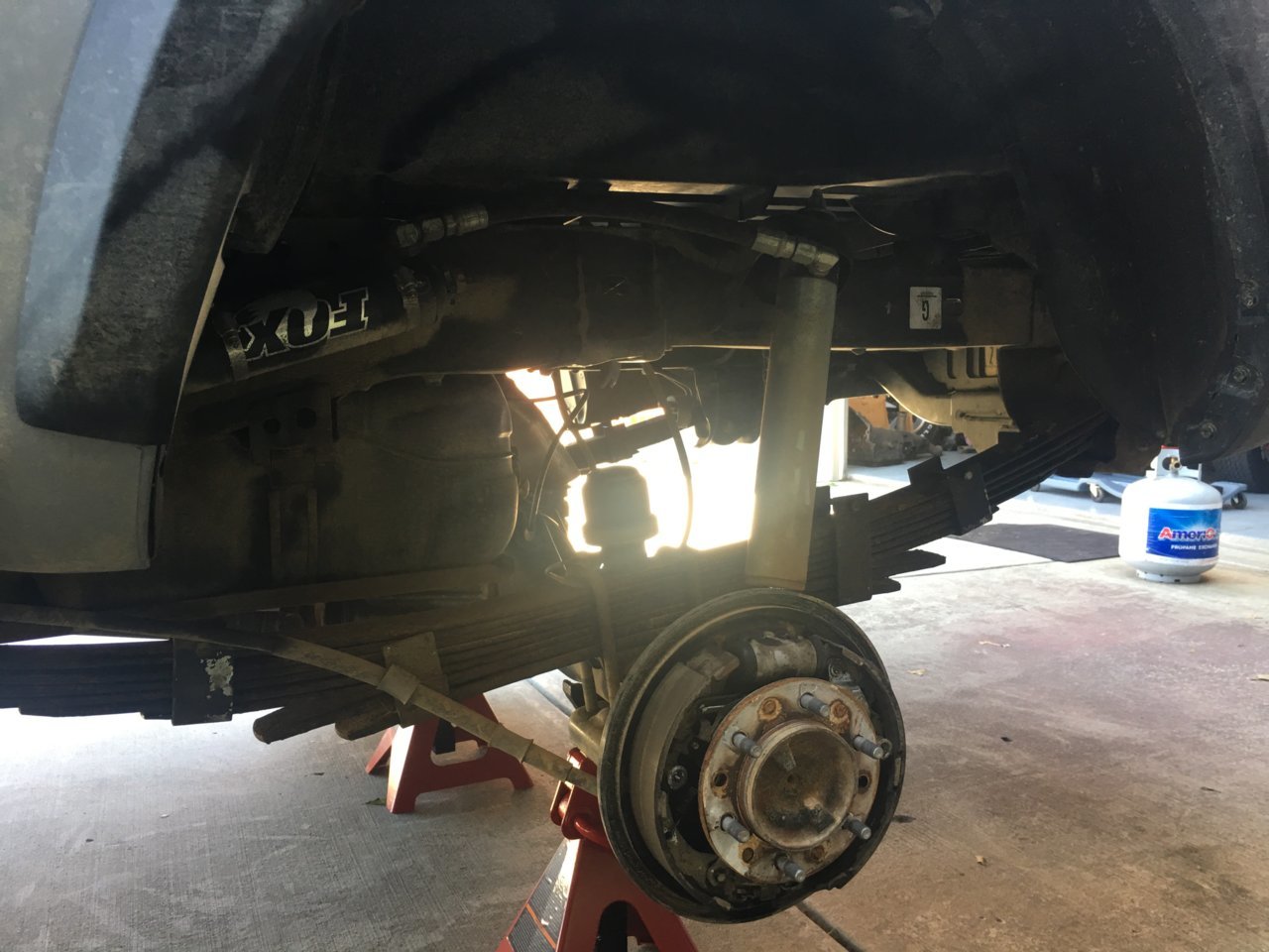

    Part of the prep for next weekend (30K miles service), rotated tires and inspected breaks.

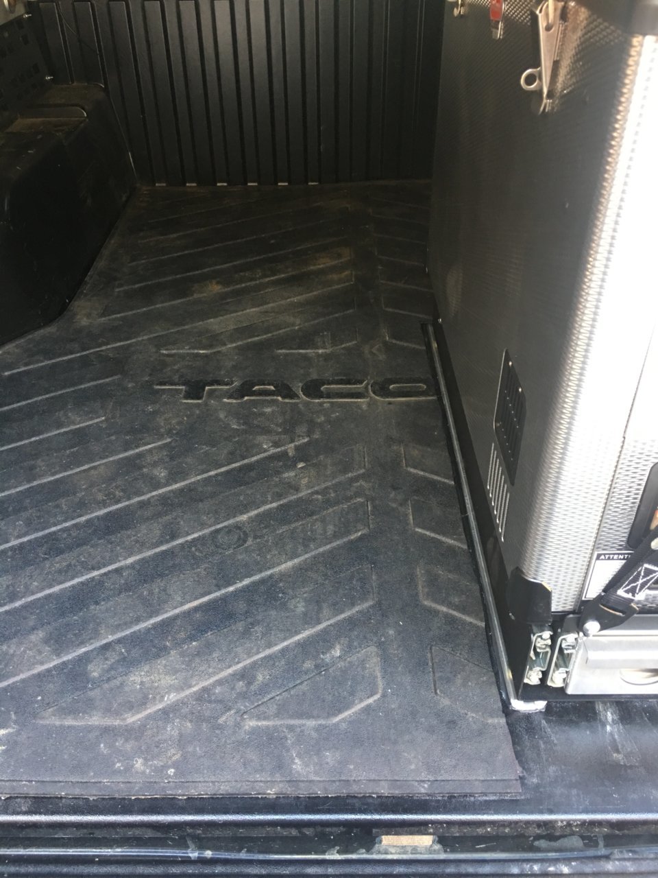

    Trimmed the bedmat to go around the fridge.
    The best thing about where it got trimmed, I was able to keep "TACO" on the logo.

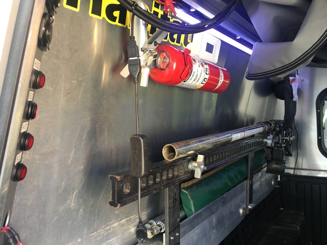

    Mounted a fire extinguisher. Open flame bolted to the truck, it was time.

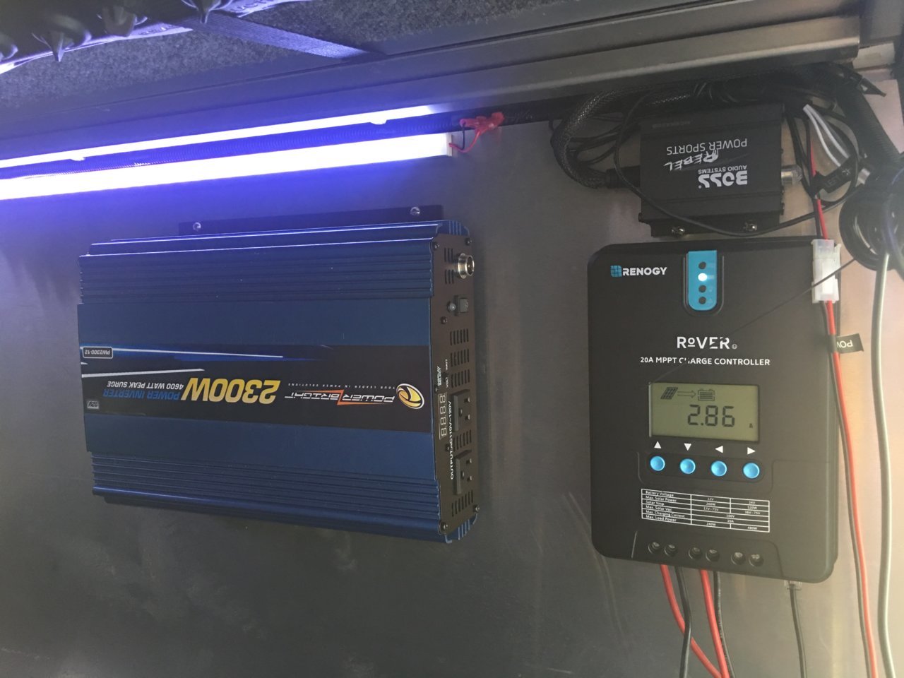

    Mounted the inverter to the wall next to the charge controller. Still need to wire everything up.

    Thanks. This has been a dream build for me as well. Good luck with your PRO. I'll be sure to follow along. :cheers:

    Clean mounting solution for your combo slide. I had not thought about grinding the L-track to fit the groves, mine sit on top of the ridges, on top of plywood. What did you do underneath the bed?
    And I like the cut on the bed mat, been debating doing that...but not currently using it.

    Basically, just lock nuts and fender washers. The strength comes from the fact that there are 12-13 1/4" bolts in each one. I hate kneeling on the corrugation. the bed mat makes all the difference of the world back there.
