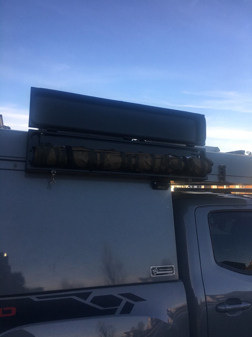

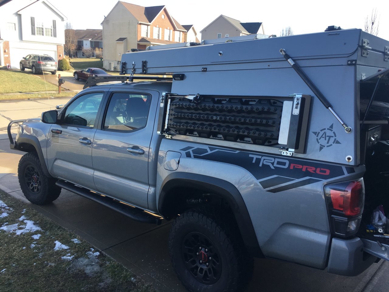

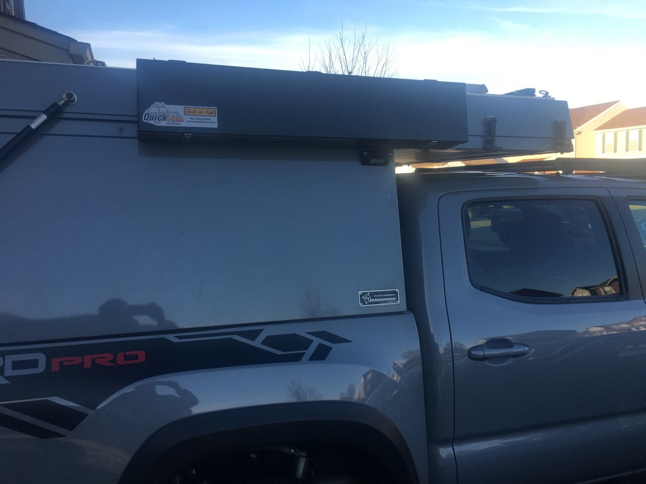

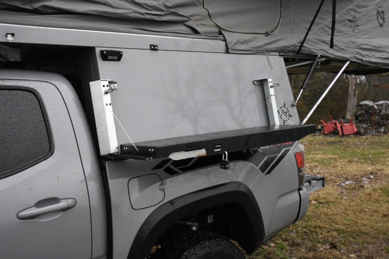

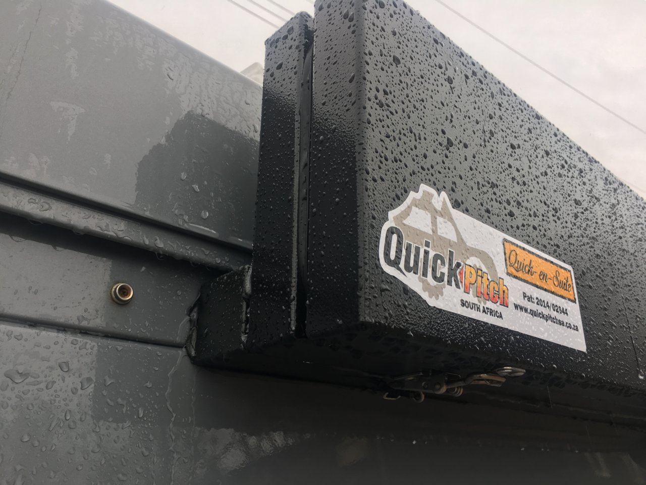

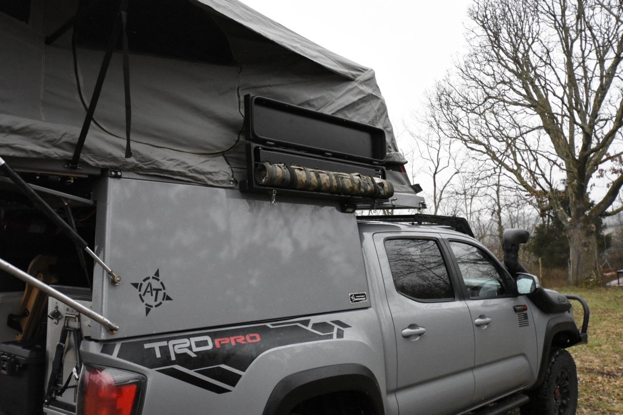

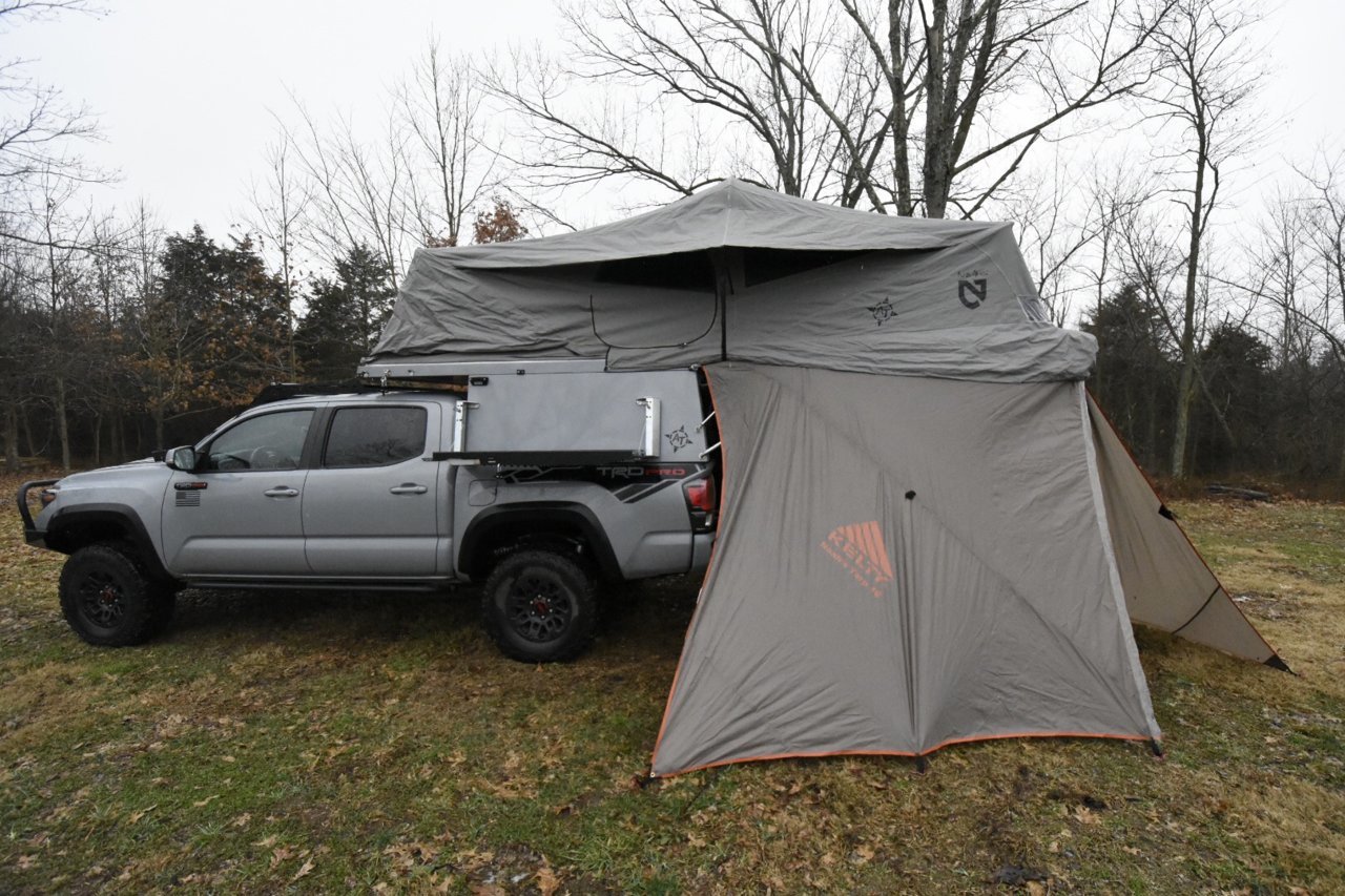

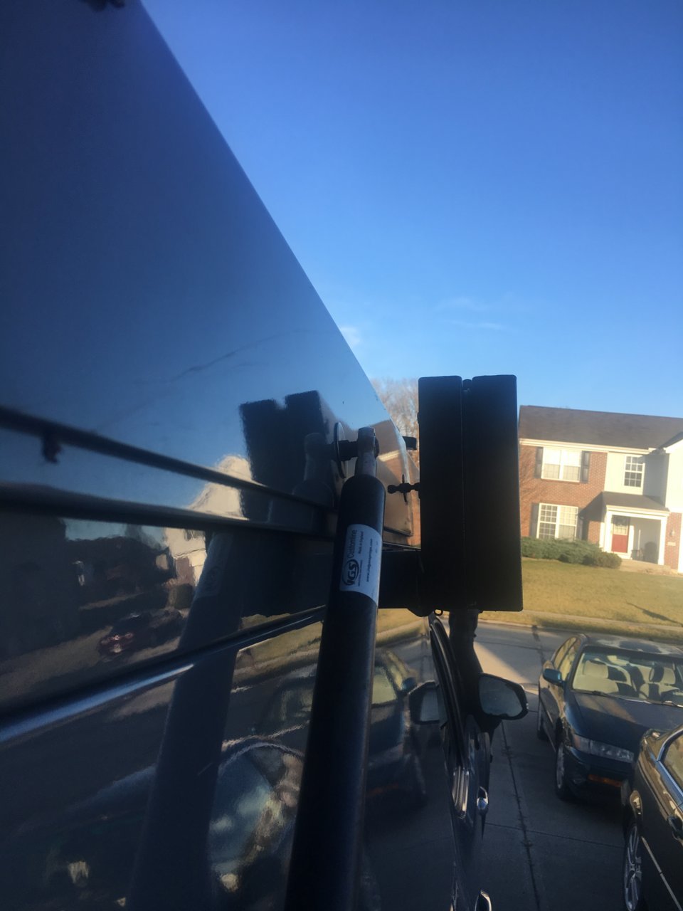

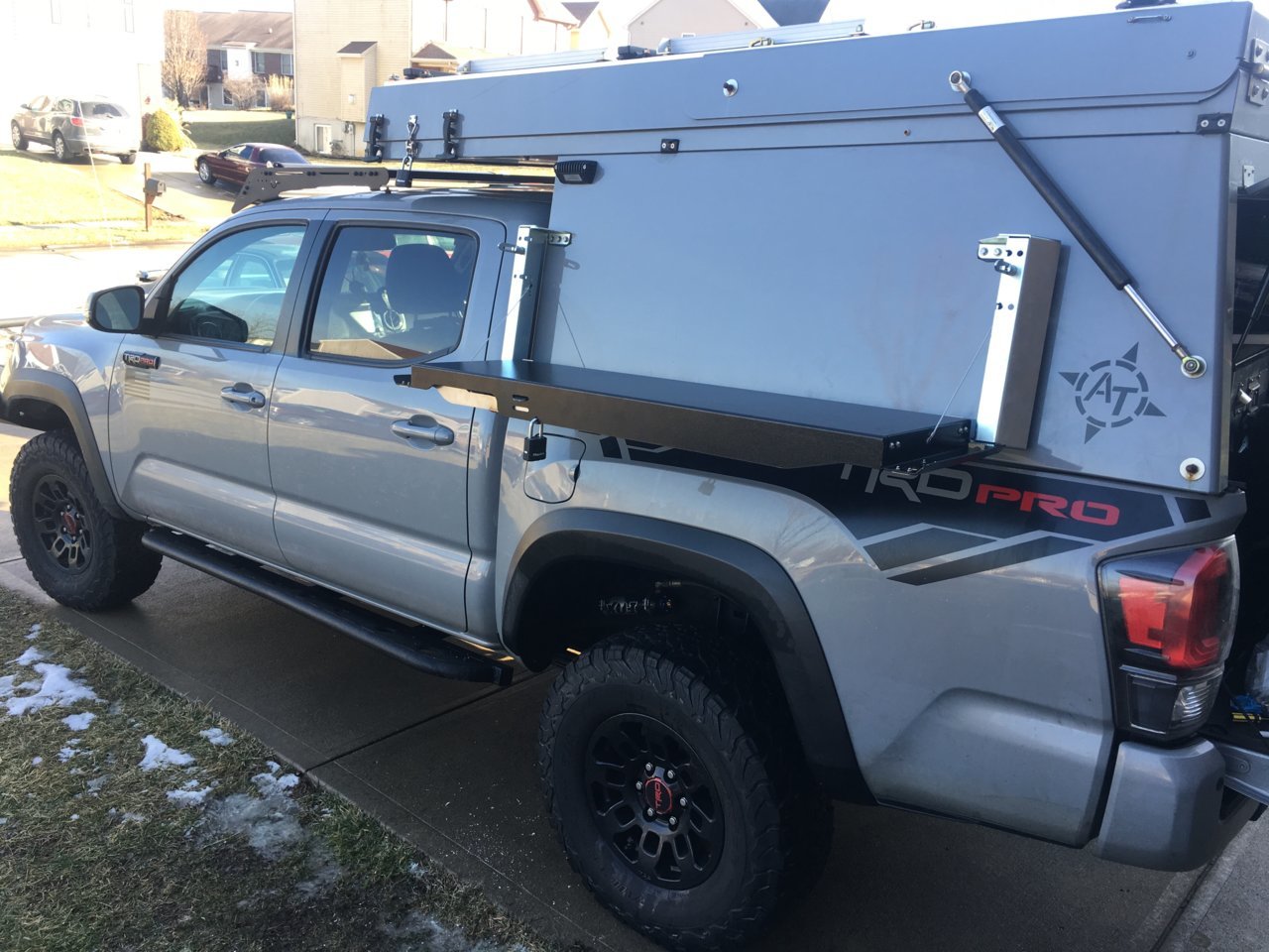

    Also installed a Trax Table, distributed by Backwoods Overland and produced by Quick Pitch Campers.
    For the installation, I drilled out the supplied mounting tabs to accept 1/4" hardware. The installation was done with 1/4"-20 bolts by 3/4" long. I used butyl tape. Rivnuts and a rivnut tool. Still need to trim the excess butyl tape.

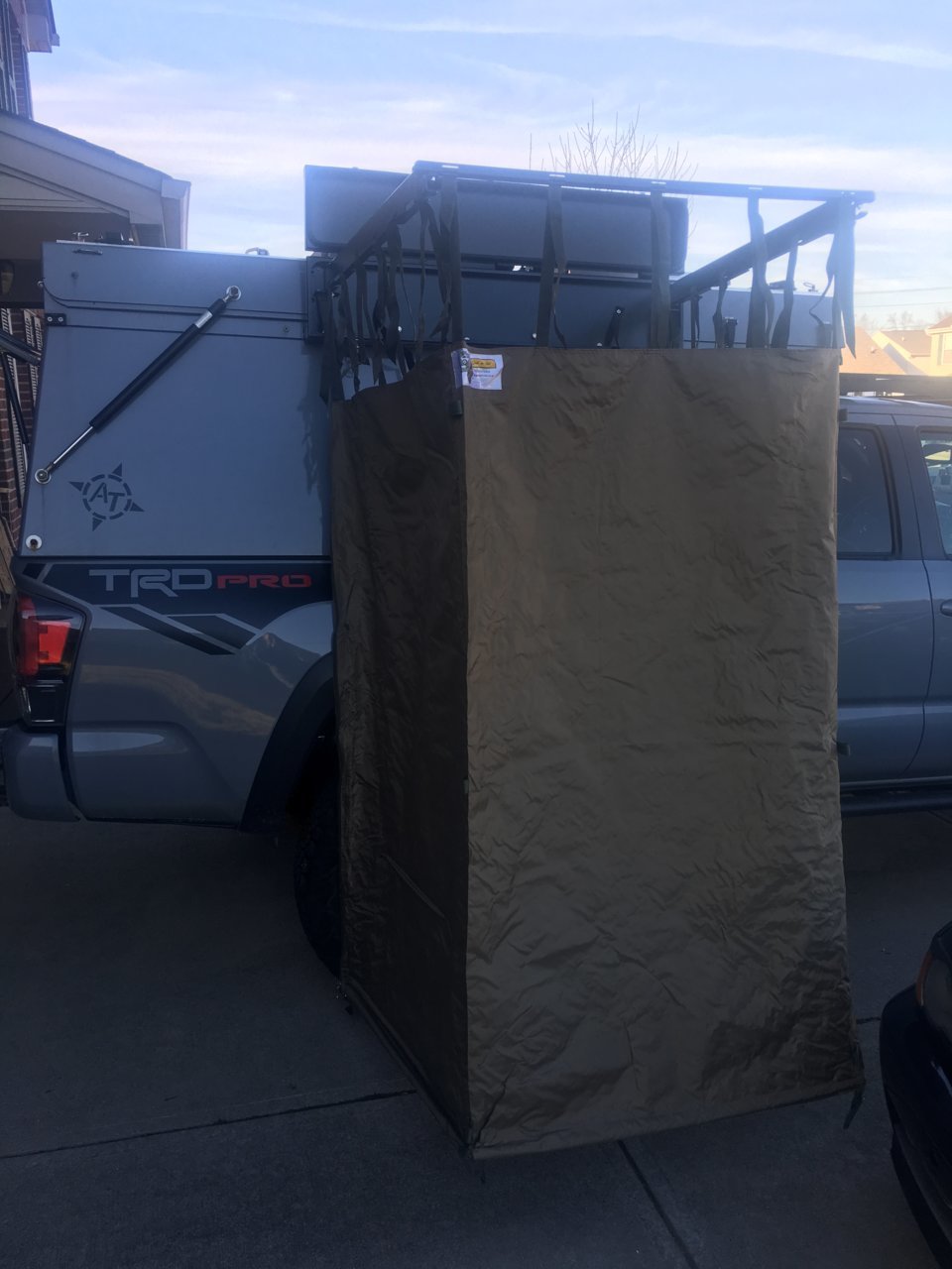

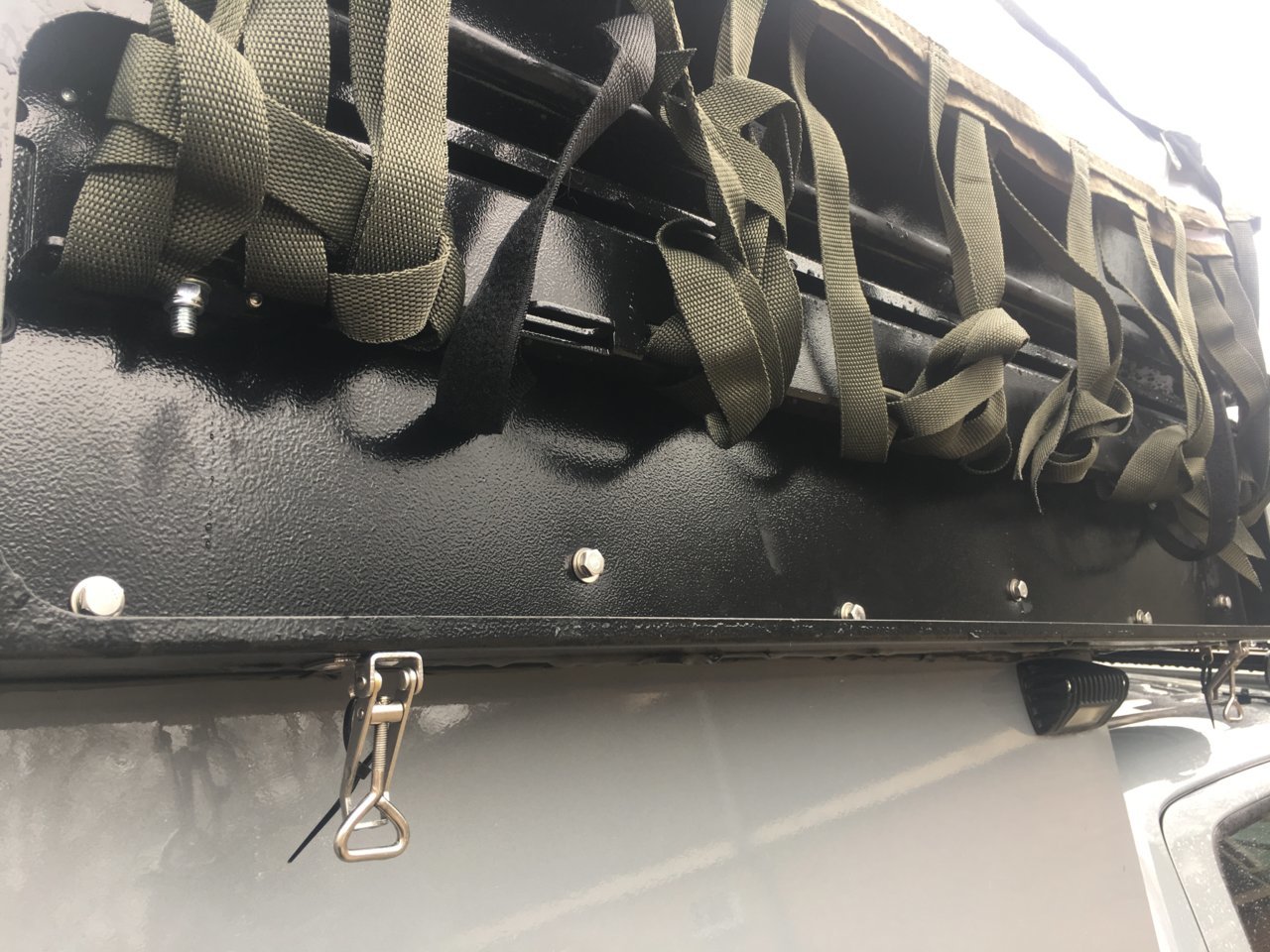

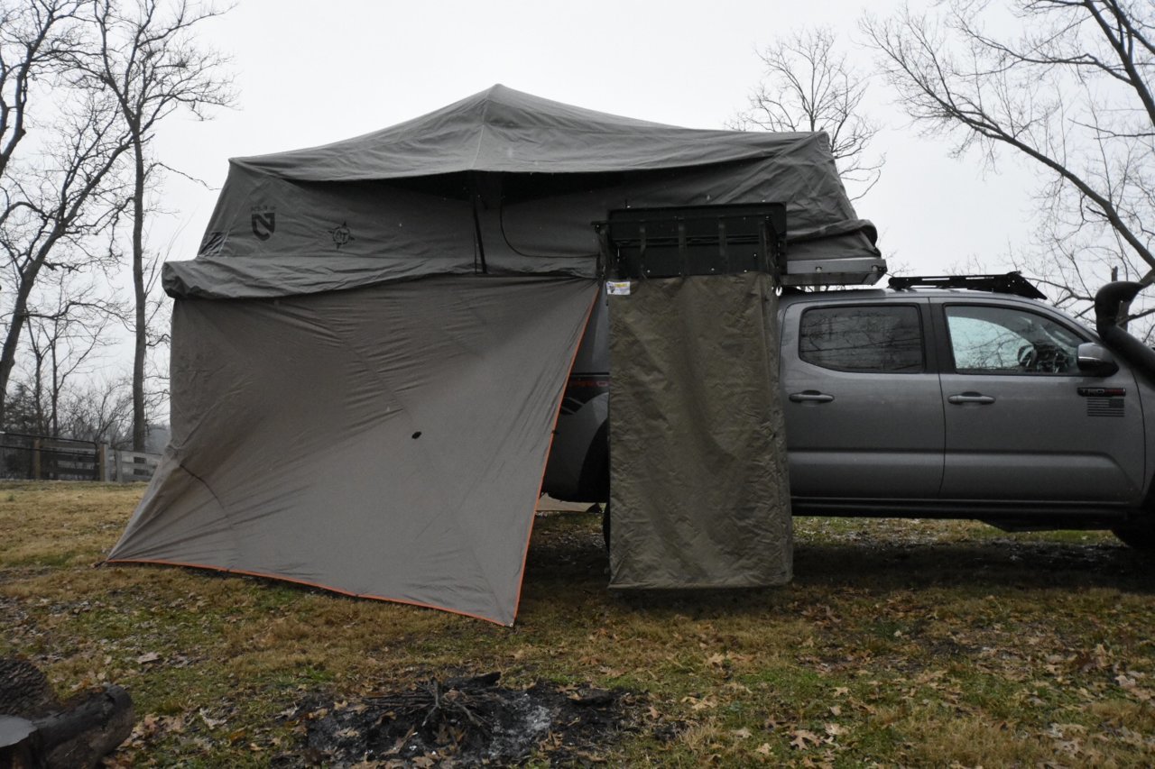

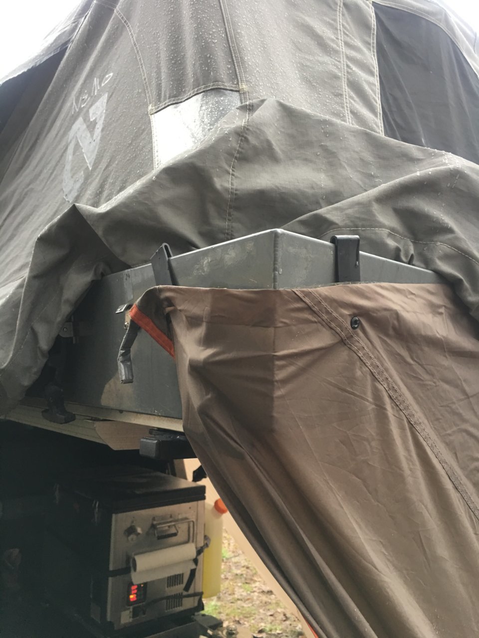

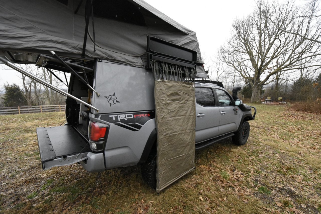

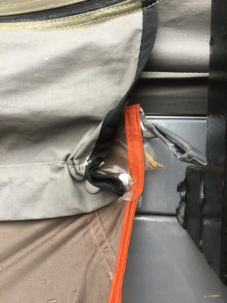

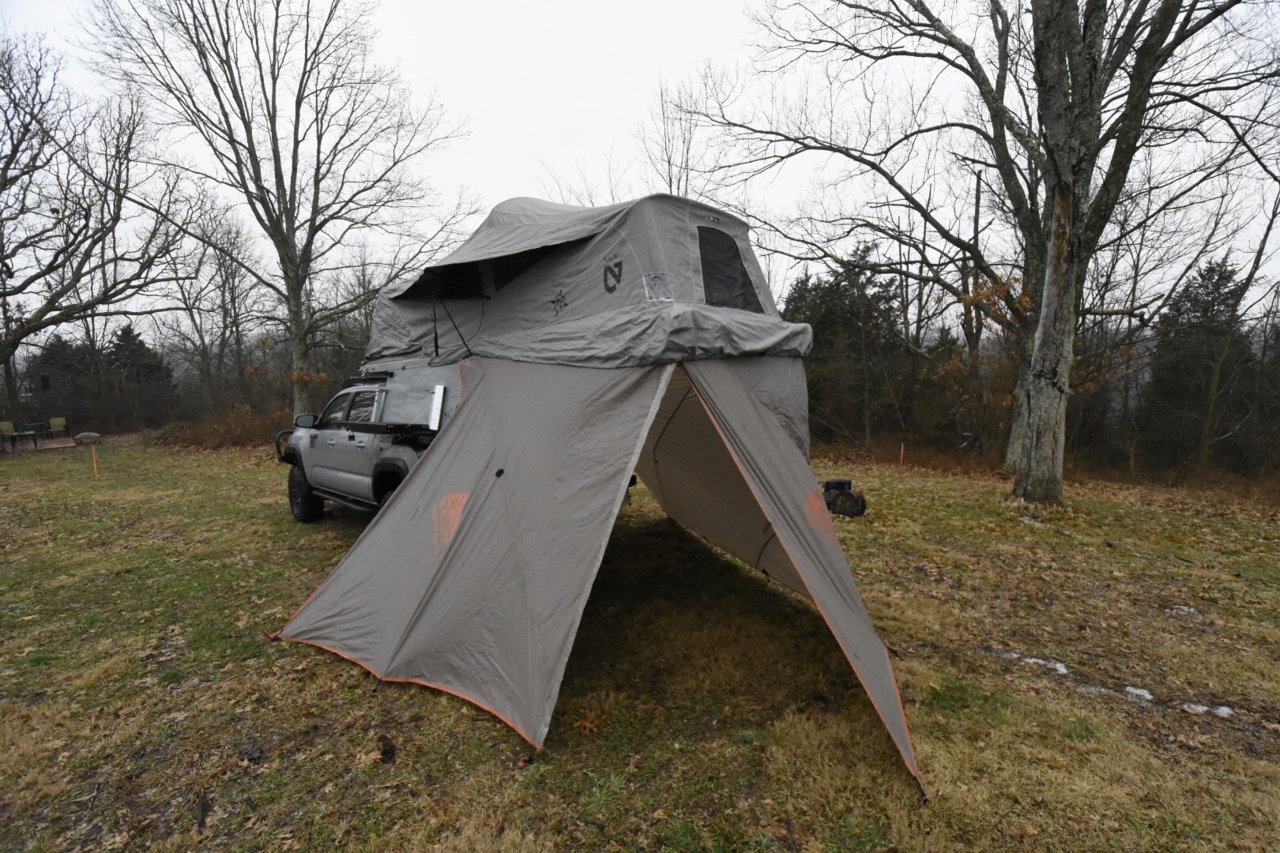

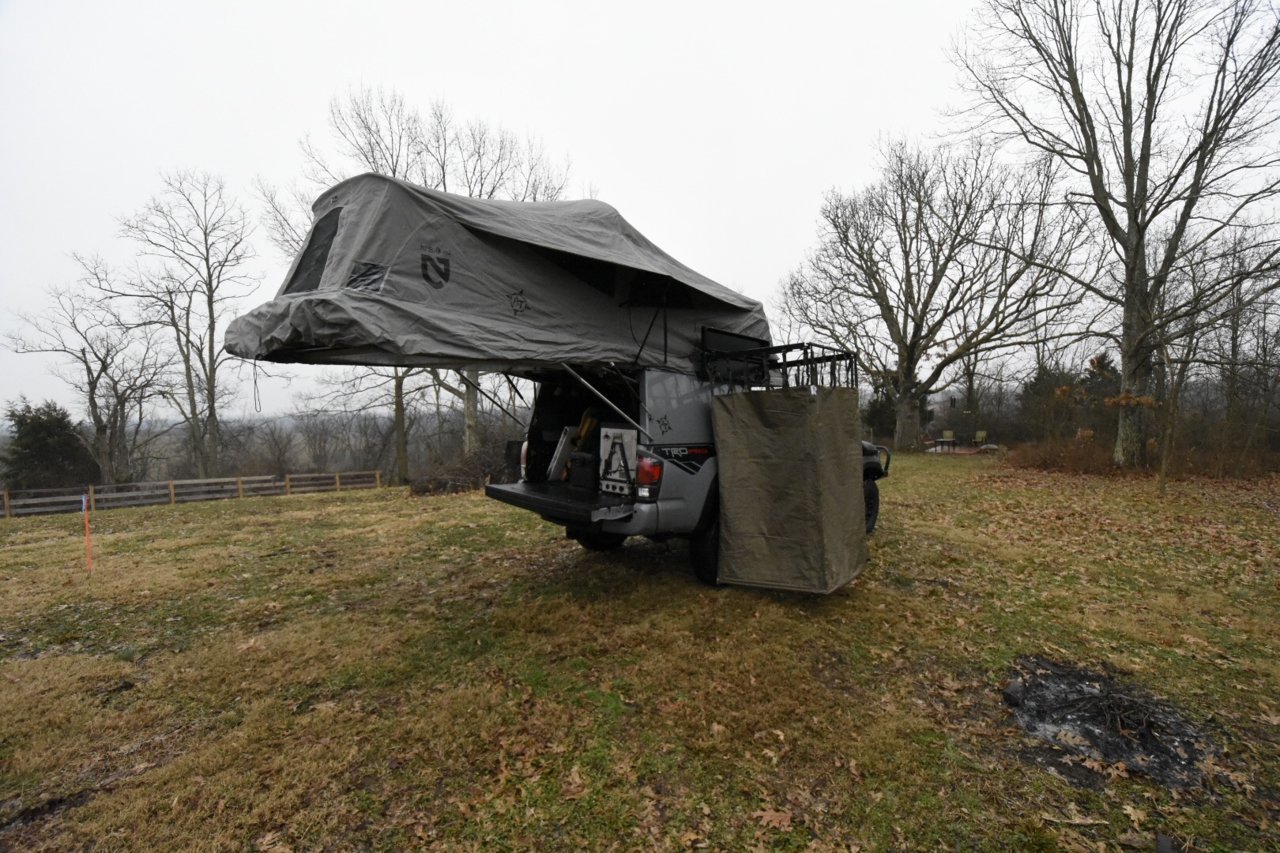

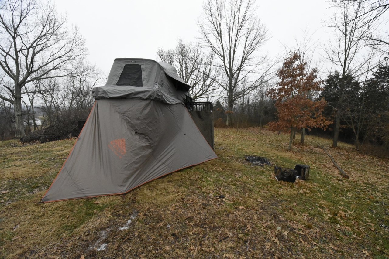

    Added a shower enclosure called the En Suite made by Quick Pitch Campers sold by Backwoods Overland. It is a delight to open and close.
    Used a 2 by 2" piece of aluminum square with end caps to space it away from the habitat, riv nuts to the habitat and (6) 1/4"-20 bolts 3" long for the install with butyl tape. IMG_4324.jpg IMG_4323.jpg IMG_4321.jpg IMG_4327.jpg IMG_4332.jpg IMG_4361.jpg IMG_4360.jpg IMG_4358.jpg IMG_4356.jpg IMG_4350.jpg IMG_4349.jpg IMG_4348.jpg

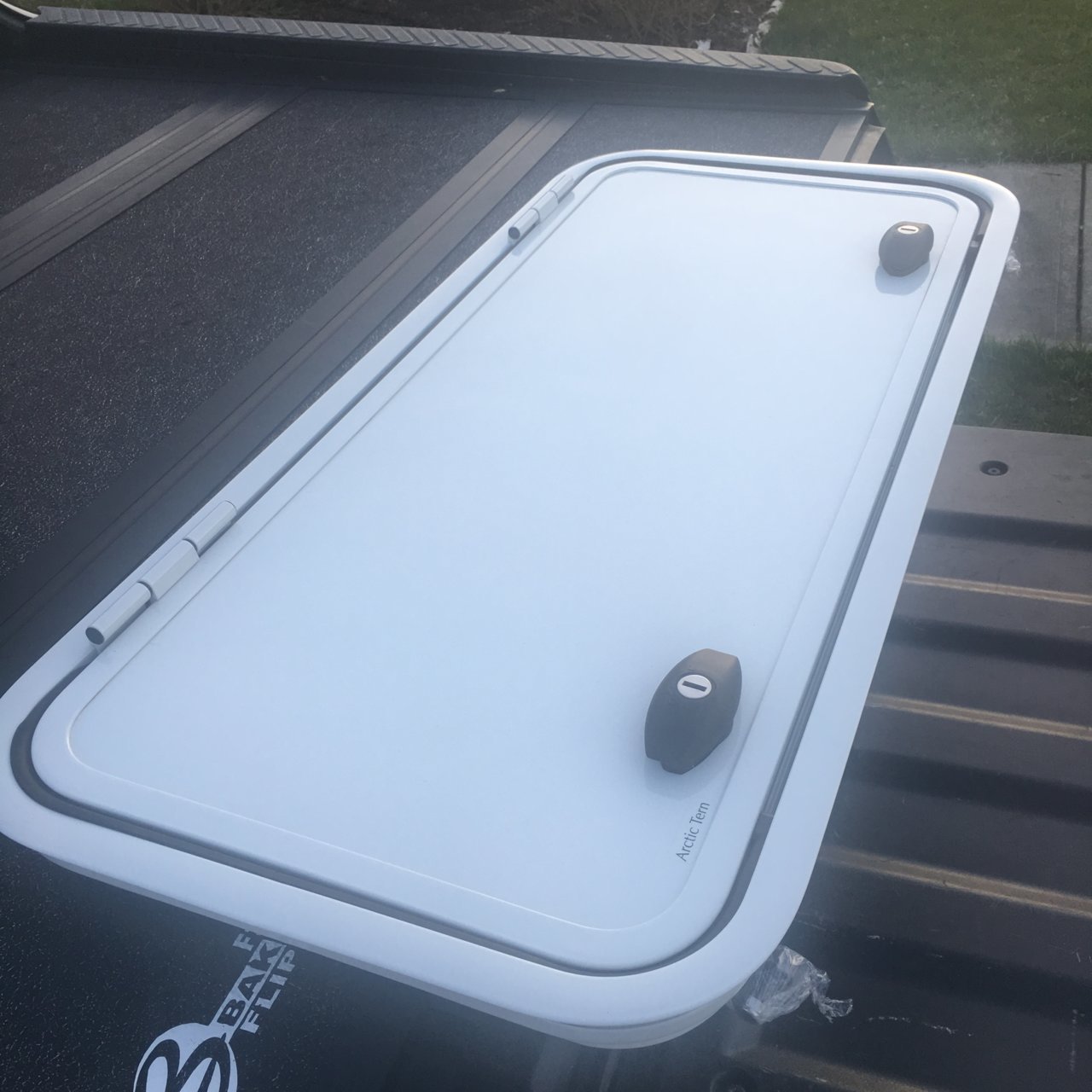

    Cutting a hole this weekend. Wish me luck.

    Alright! I was hoping someone would do this! Where did you get the hatch from?
    tacofort[QUOTED][OP] likes this.

    Tern overland. I’ll post pics and tips.

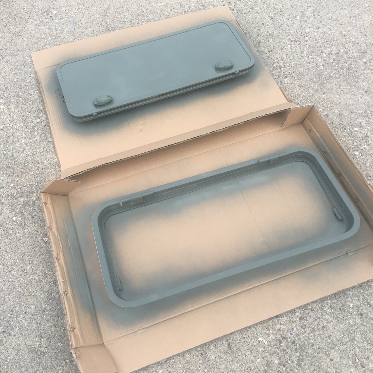

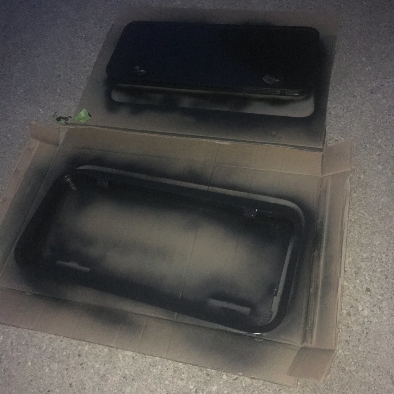

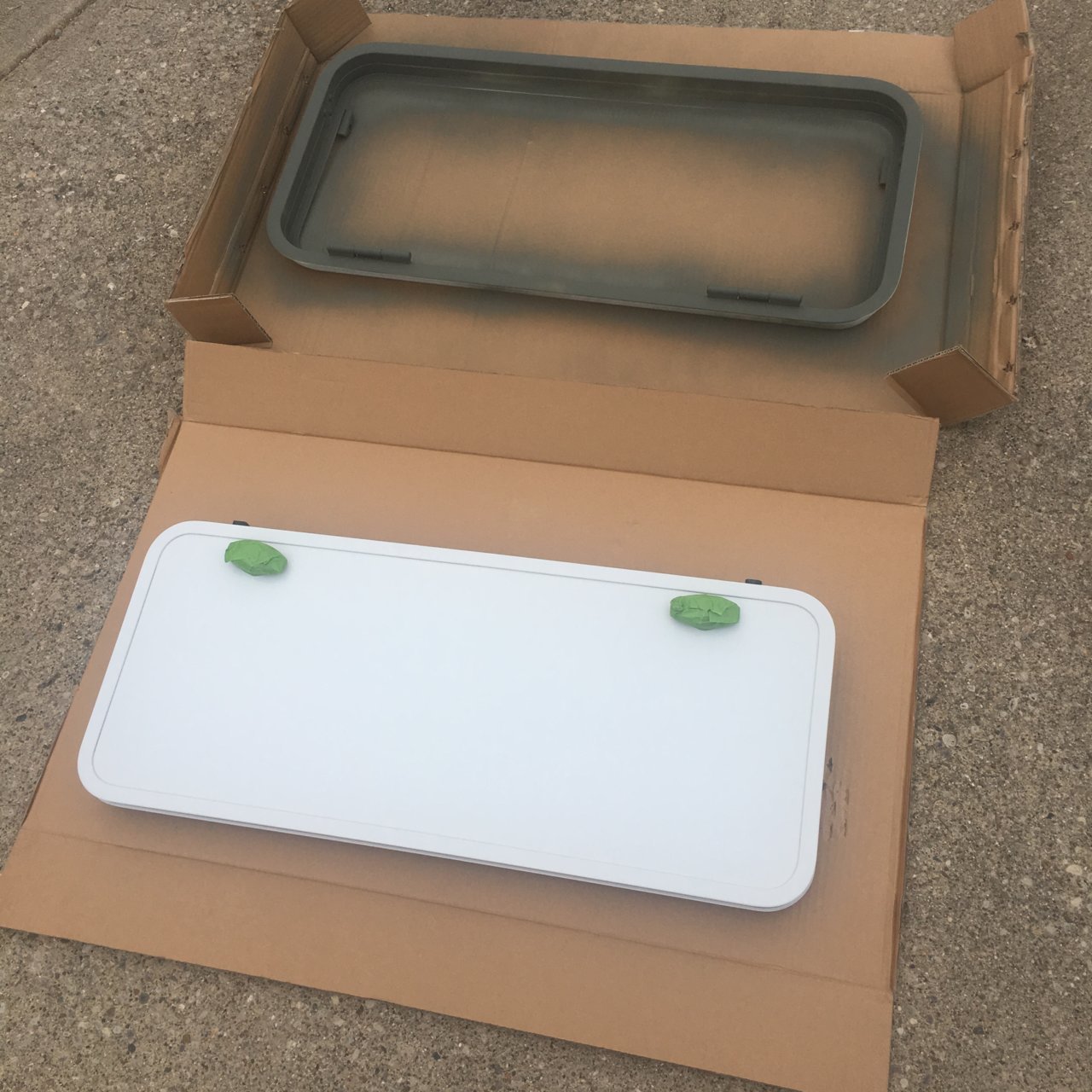

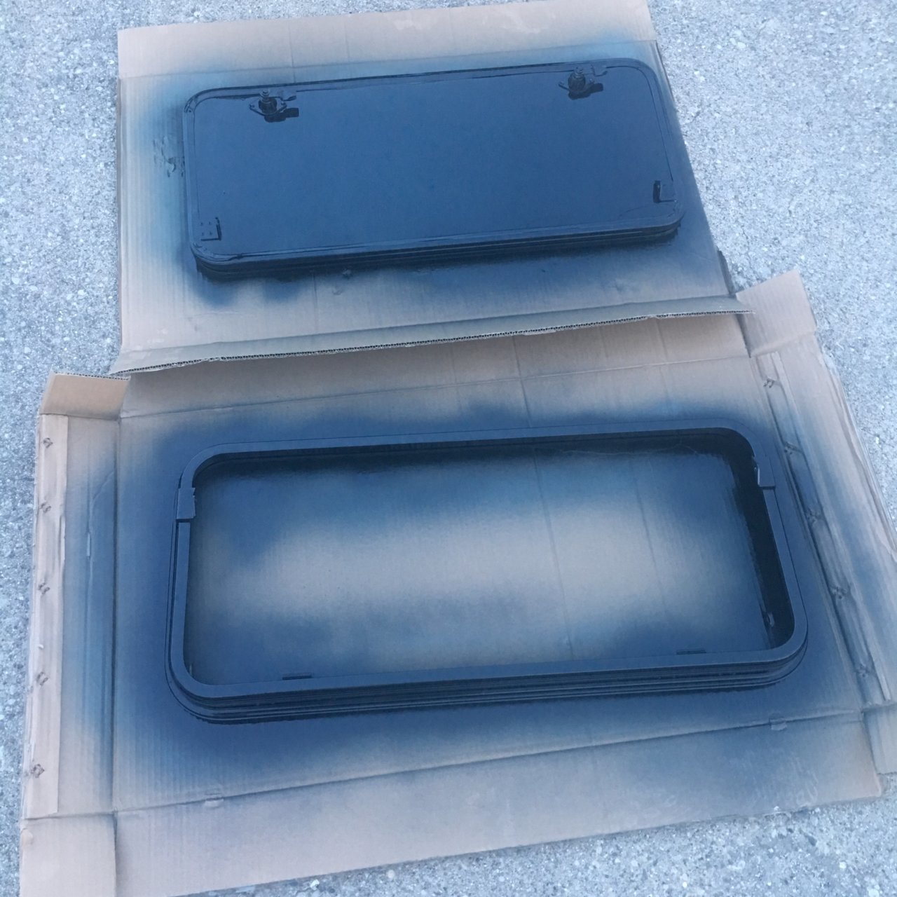

    Did a little paint this evening to prep for this weekend. Disassembled what I could, lightly sanded, wiped down the surfaces, primed, and painted the first coat while fighting off the bugs. 5B49A204-27CA-48DC-AE43-C3C081F304CA.jpgC1082707-81DF-45AE-838F-AB2443A96BDD.jpg10D86CD4-4EF3-4016-BBED-53E4D2C47C29.jpgE1F1E115-D9A0-46F1-B157-F8A24A3C2C17.jpg
