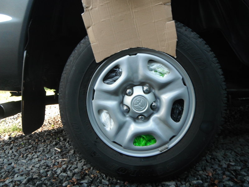

    1st, chucked the wheel covers:

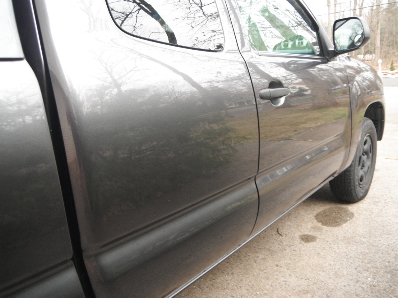

    Next, debadged sides and tailgate:

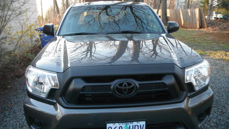

    Next, derped grill surround:
    b5.jpg https://www.tacomaworld.com/threads...gen-tacoma-today.6499/page-4309#post-12264981

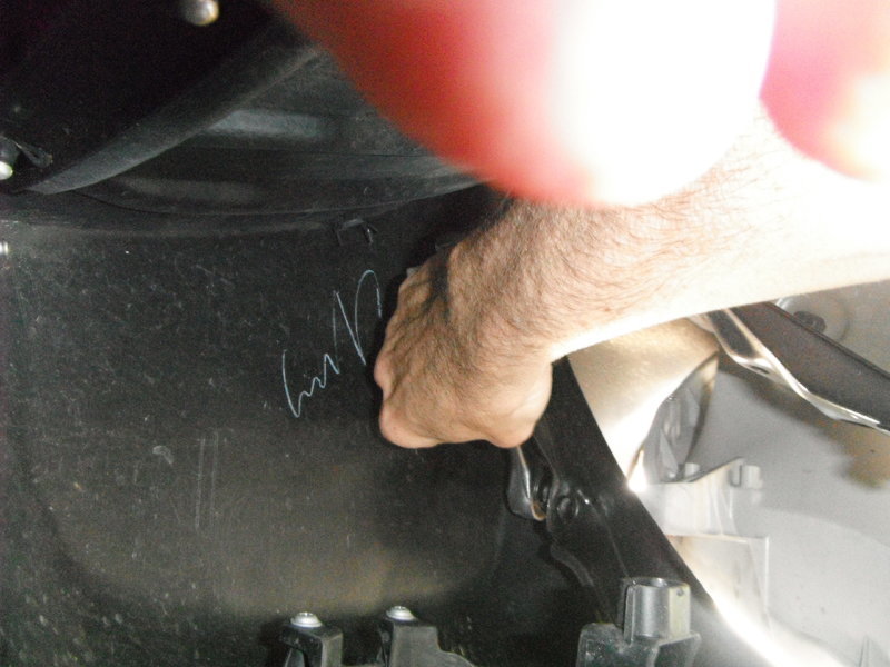

    As others have mentioned one basically has to feel for the bottom outside light mounting bolts...

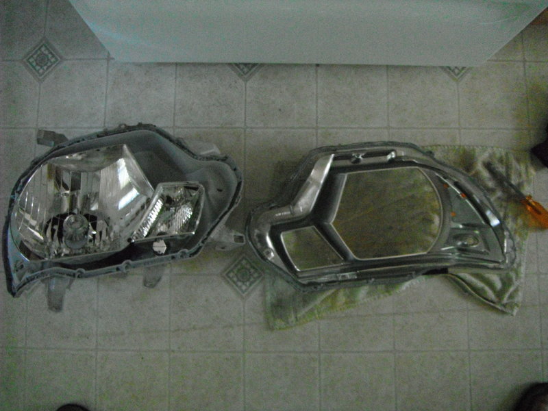

    the clip with the light housing off...
    baked at about 220 degrees Fahrenheit for 10 minutes, seemed to work well, was easy to separate lens from housing...
