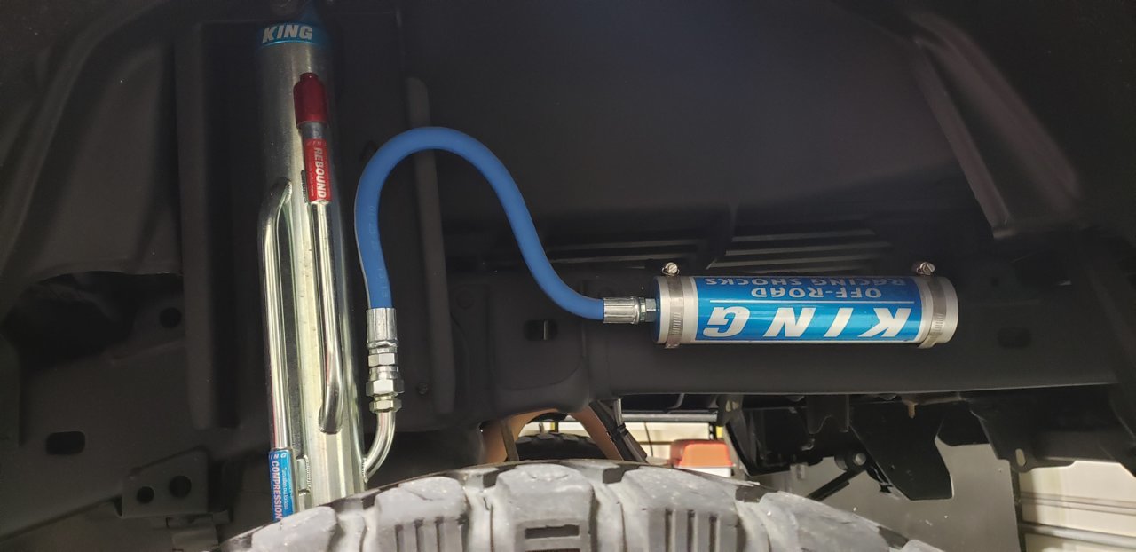

  6. Jul 12, 2020 at 5:39 AM
    #506
    Mech_Eng
    Mech_Eng Well-Known Member
    Nov 2, 2018
    #271418
    212
    Jason
    Birmingham, AL
    2009 TRD 4x4 DCSB
    See Build Page
    Damn, no one told me I was bald.
    Cut, grind, measure, measure, weld...
    Hey king sent me "free" stickers.
    Archive Garage items are so robust, it makes my frame look wimpy. Really great customer service too. Thanks for all the help!
  7. Jul 12, 2020 at 7:17 AM
    #507
    Cred92
    Cred92 PAID4MOD
    Aug 29, 2015
    #162952
    2,634
    Caleb
    Jasper Al
    Indigo Ink Sport DCLB/White RC I4 5MT
    BLACK AND BLUE STUFF
    Damn looks like an awesome job! Sweet looking setup wanna check your setup out, only alabama guy that’s done the relocate.
