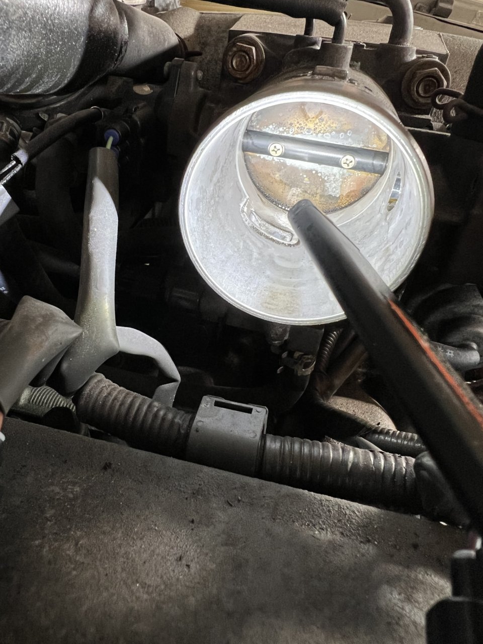

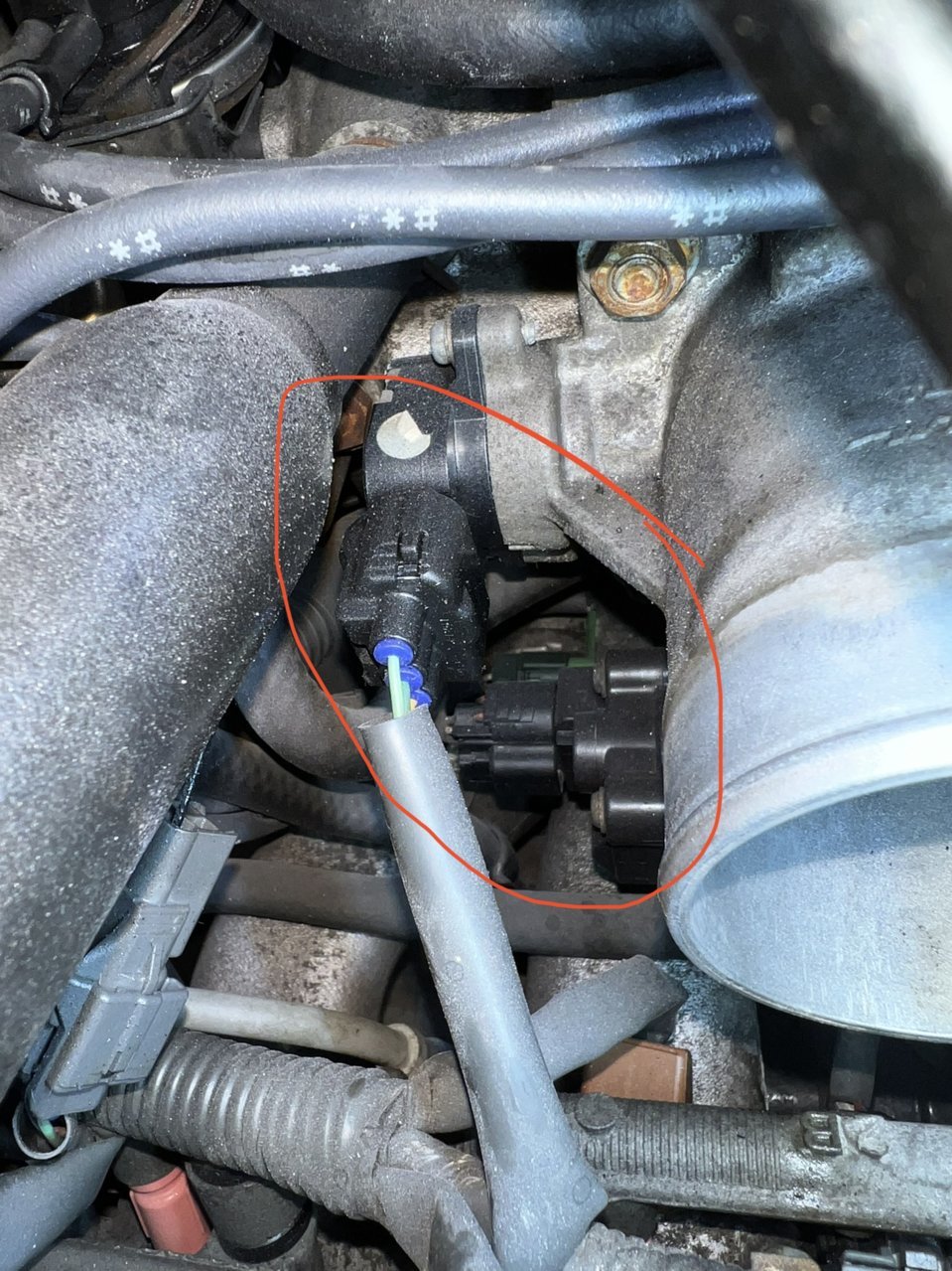

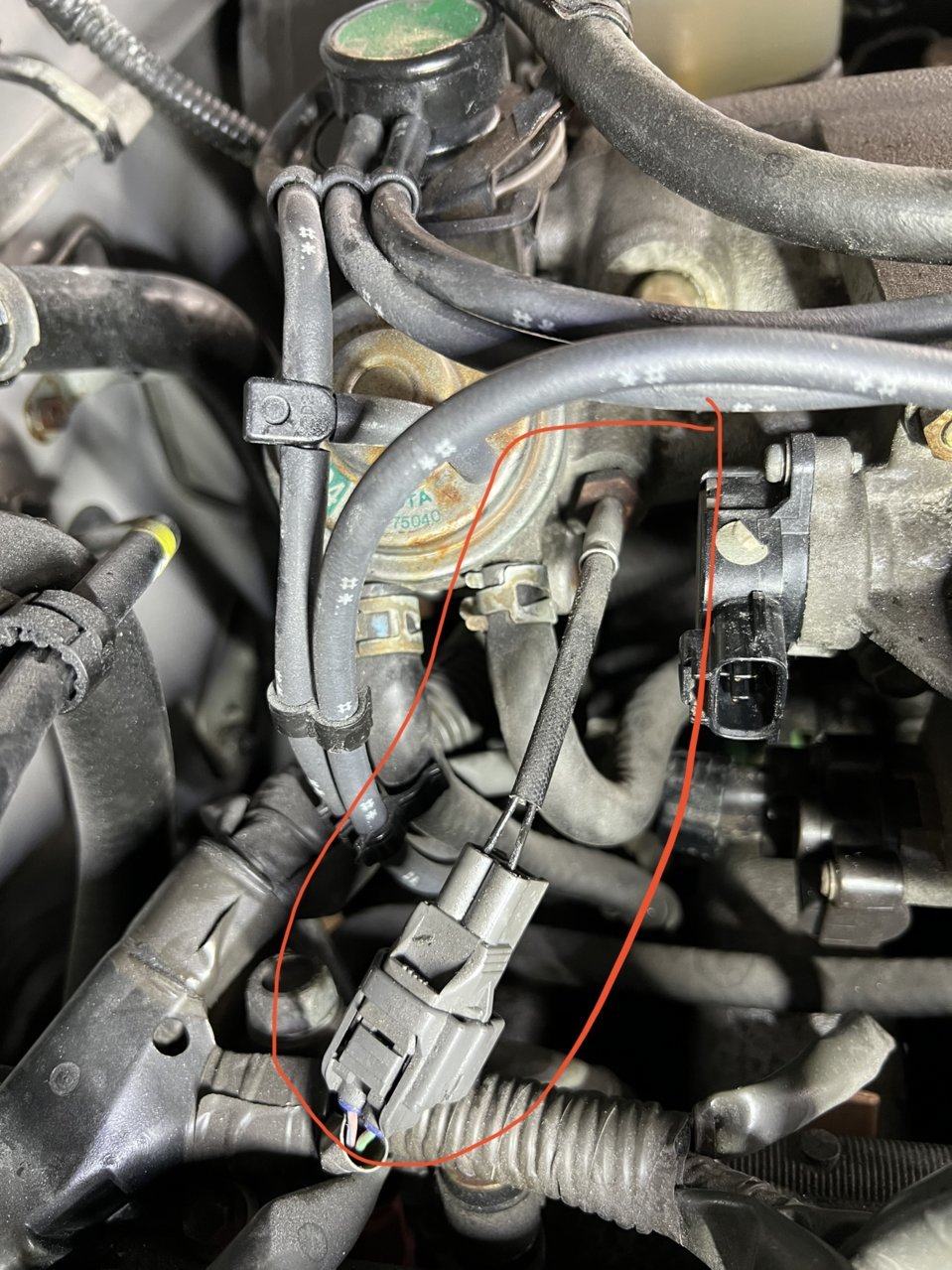

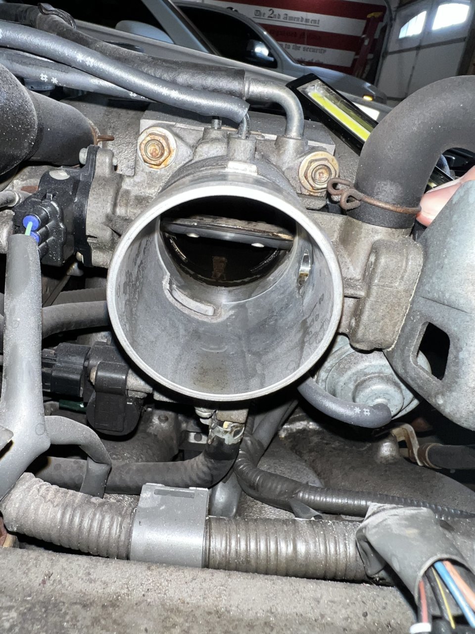

    So I just did a whole bunch of cleaning on my truck and hope to improve this problem of which it didn’t change anything as far as I know. I took some pictures of things that I have no idea what they do and was wondering if anybody may know. I couldn’t clean the rear oxygen sensor since it’s impossible to get to but I did clean the front one of which were both replaced with OEM only about 100 miles ago. I did the same thing by running it with the new MAF sensor and it still did its bucking, then I unplugged and it ran great. Plugged it back in and did the same bucking thing *to note I took the same roads with it unplugged*. I have no idea what to even do now

    If the truck runs better with the MAF unplugged then it's because the truck is running in "limp" mode.
    Rom your photos:
    1/2. Your throttle-body looks OK, but gunky around the edges. This could cause issues since the plate may not close properly.
    3. The throttle position sensor looks like it's original, and normally won't cause issues as you describe
    4. The EGR CAN cause bucking and misfires.
    EGR could be a culprit, and would be my focus in your shoes. I removed it years ago, and have no idea how to troubleshoot one on a Tacoma.
