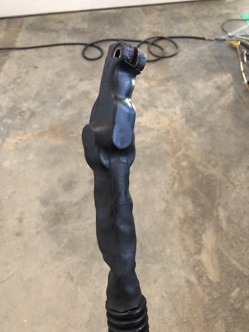

    I just had mine out while replacing the rack. It was still tight, no play at all. I have the All Balls greaseable joint in my basement just in case mine fails. It was still in perfect shape though.
    I ended up stretching a bicycle tube over it and packing it with grease while it was out. Not sure how long it’ll last, but I’ll give it a go. If the tube splits, it’s not too bad to get the shaft out and replace it with a larger one (dirt bike maybe?) that may last longer and not stretch so much.
    Edit, I uploaded the wrong pic, but you get the point. I ziptied the ends to help stop water ingress.
