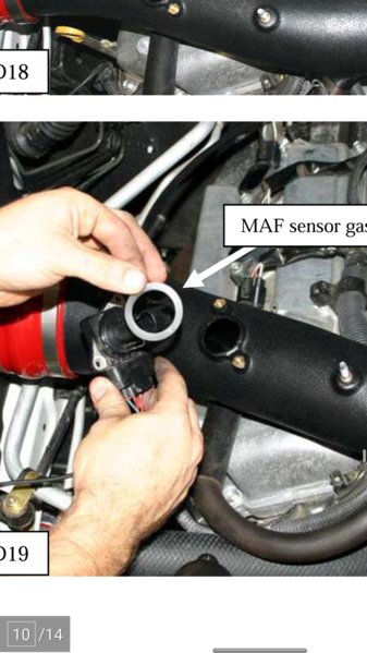

    Hey guys, I got a TRD performance intake of TW and was missing a few parts, dealer will only sell a hardware kit not individual parts and wanted to see if anyone can help with suggestions or may have them.
    1- 6 mm stainless button (alen) bolt that holds the lid

    Use this occasion to order a replacement set of flexible coupling from AFE.
    For the gasket, it's not very difficult to fabricate one. When doing a service at the dealer, they lost it and i was getting the famous P0420 and 430.

    Good idea, thanks.. what is the p0420 and 430? Are those the part numbers for the gasket?

    Codes were the result of a bad sealing aroud the maf controller.

    Ok, I see. I wonder if it's because people don't use a gasket? I know the guys I got it from said he wasn't using a gasket
    Thanks for the info

    So I ordered two couplers, two MAF gaskets (1 for a spare) and a button bolt. $30 not as cheep as I would have hoped but didn't break the bank

    First thing, i have not cats at all (DTLT headers + Spec U exhaust) and O2 sims. I know but i was getting those codes on and off for a few moment now when i realized the gasket was not there anymore. Having nothing to fabrication a gasket, i've used silicon to seal it but the seal was not perfect and i still getting the code. Never got the codes since i've installed a gasket. I've fabricated one instead of using the one supply by AFE to be sure that it will be compress when tightening the screws.
    I think it can affect the reading of the MAF. Not enough so the FI loop can compensate and still be Inside parameters but enough to generate a code about catalytic converter.
