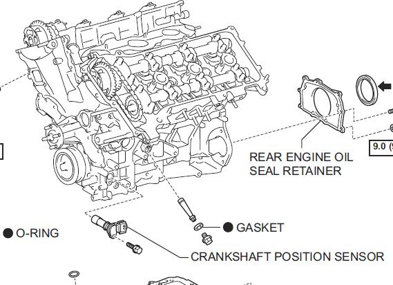

    I don't recall culprit being mentioned yet, but what about the crankshaft position sensor?
