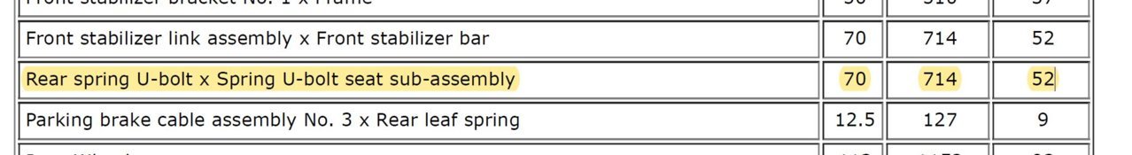

    Try tightening the U-bolts on the rear axle. Is yours rattling in neutral?
    I chased this down for months, then finally when i lowered my truck and had to install new ubolts that fixed my rattle

    U-Bolts folks, tighten your rear axle u-bolts. Fixed the rattle in neutral on my 2013 6spd

    Did the dealer replace the u bolts? I know on 2nd gens, the factory service manual states something like 45 ft/lbs for ubolt torque spec. I think that is a typo because its way low, i think it should be around 75ft/lbs. reason i ask if toyota did that swap is because they torque to 45ft/lbs and the problem of loose ubolts could still be there.
    Mine was more of a metallic rattle in neutral. Yours sounds like more of a clatter.
    Also, ubolts need to be torqued while weight of the truck is on the ground

    Proper torque for the factory u-bolts is 52ft/lbs according to the FSM

    Torqued mine to 75 and havent looked back. I think 52 is low for the only thing holding the axle in the truck. It was 100% the cause of the rattle in my truck
