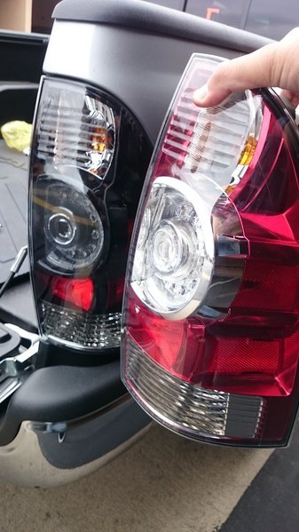

    Perfect and love them

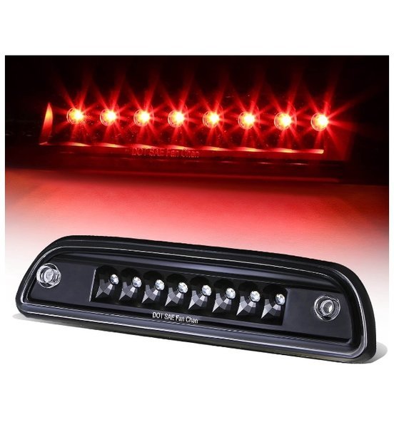

    I have a long question on these LED conversions. I recently swapped out my stock third brake light to an LED version and it caused a major short in my system, it caused an error that caused the shift lock to stick and my brake lights to stop working. I went through the whole troubleshooting process as far as my skills would allow, questioned everyone on TW and ended up taking it to the stealership for them to tell me the LED caused the short. So I ended up reinstalling the OEM third BL. Still have the LED third BL.
    Now, as with this LED light and any other LED lights we can replace, do we NEED to use resistors or decoders when we swap out the tails, heads or fogs in order to prevent errors? If anyone else here has swapped out to LEDs and had issues and used resistors or decoders to fix it, which ones did you use for which light? I want to swap out all my lights to LEDs.

    No resistor needed for the fog lights.but I replaced my third brake light bulbs with led bulbs from superbbrightleds.com and I haven't had an issue yet.

    These black depo tail lights do not require a resistor to work with the supplied bulbs. If you switch the turn signal bulbs to led you will need to get resistors, same on oem and this light. Sounds like either a faulty 3rd brake light or maybe an exposed wire possibly caused your issue. Which did you buy?

    image.jpg sold by auto dynasty through Amazon. So as long as I keep the stock turn signals, no resistors are needed. Cool
