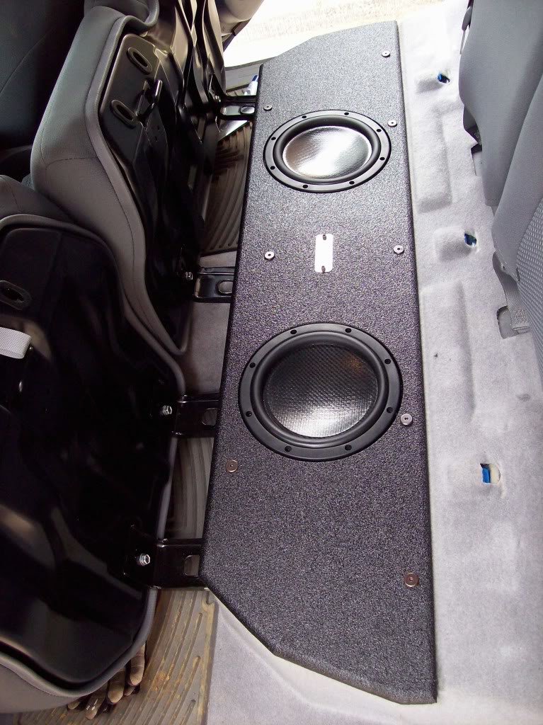

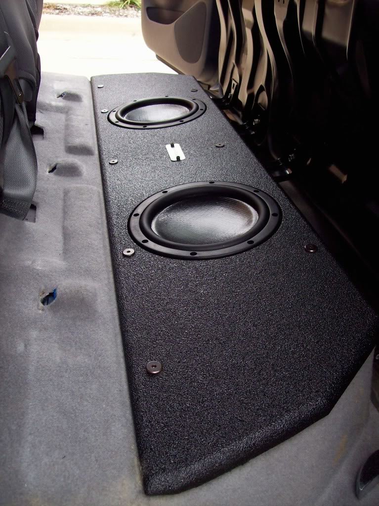

    Alright, here it is. Y'all are pretty familiar with the underlying infrastructure if you've been through this thread. If not, check the earlier pages.
    This time I decided to go sealed. It made life a ton easier and the box is pretty much dead on specs for these drivers. Speaking of, the drivers are the Elemental Designs E3.8 subwoofers which are an 8" driver. I'm running two of those sealed in the tub area under the rear seats in the double cab. Volume should come out to right about 1 cube.
    I'm getting quite good at making these baffle boards too so swapping out subs is a snap. I think this one sealed extremely good too.
    The sound is VERY tight an transient. The attack on these things is pretty darn awesome. The low FS on them makes them dig pretty deep with the cabin gain. I haven't tuned any yet with the Audison Bit.1 (not for these subs yet) but when I get some time I'll make a few tweaks. Overall I'm very happy with the way these turned out.

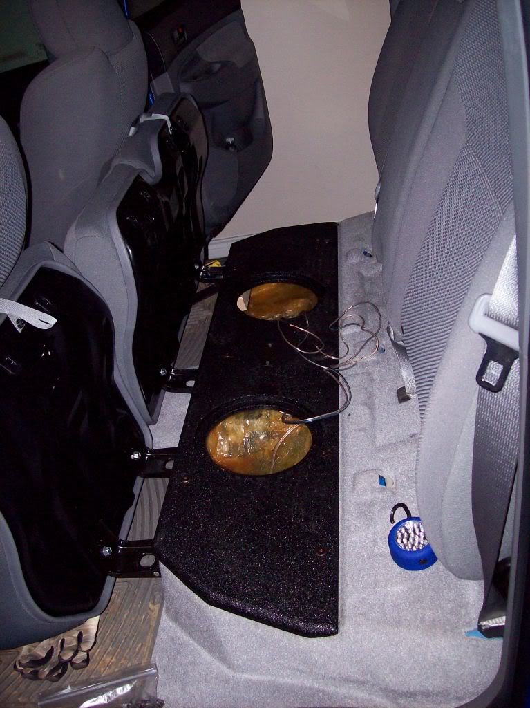

    So did you end up glassing the entire bottom?

    Yeah, the whole inside of the tub is glassed. It's been that way for a while. That way all the holes are sealed up and it's VERY rigid. Any time I want to change things up I just make myself a new baffle board for the top.
