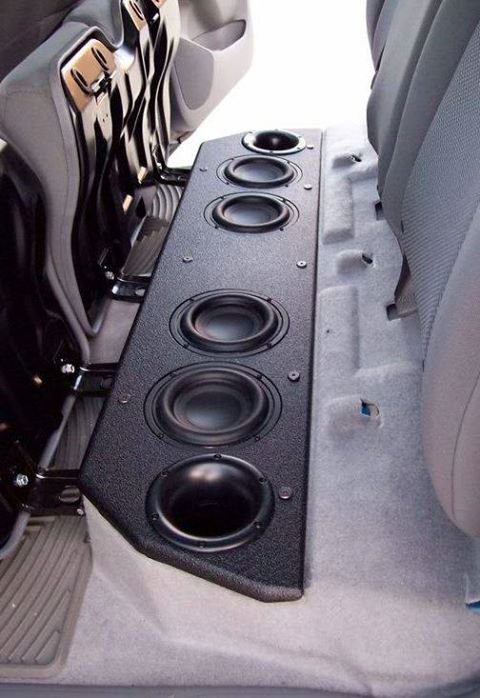

    I just did it...but in a simpler fashion. I "tweaked my ledge a bit with a soft hammer, it goes back easily enough. I then foamed and blueskinned (think tar paper but very similar to original dynomat) the entire enclosure dead and sealed. I gasketed the top plate and if I was willing...I COULD go back to stock and no one would be the wiser. I used to Earthquake sws 8xi (2 ohm) subs because I really wanted to try them. Results? Fat, quick bass that blends well, from snoop dogg to Jazz...its brilliant and unseen.
    Took about 5 hours, but I sound deadened the rest of the floor and back wall while I was at it. I didn't care too much about looks, as you can see, but it could easily be made nice quickly. I used the bin as a template and just made it a bit "longer" on each end.

    In the past I made a few baffle boards (the top) for people looking to roll their own but I got rid of the template last time I moved so I'd have to start from scratch. So yeah, it would be a VERY expensive endeavor for anyone who wanted one now. The good news is you guys have photographic proof of what I've done already so it would likely be better to go to a local car audio shop and have them copy it. :D

    Do you have any pics of the bin metal being cut? Not sure what you mean by bin metal.

    Why didn't you use some sound deadening material on the inside of the cab? or in the tub part under the seat?
    Could you tell me or direct me to a post that explains sealing the top board to the under seat tub?
