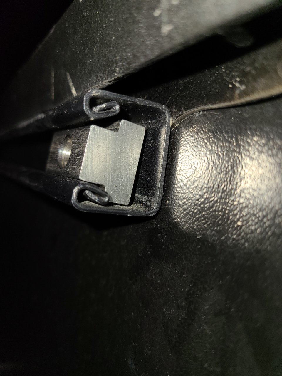

    I wanted to get some T nuts for my tacoma bed rails to mount the bed rack I'm building. The issue is that every single t nut that says for tacoma has a 7/8" body width, when the slot is 1 inch. It's super frustrating because the 7/8 "works", but it doesn't fully engage the rail and it looks like it will pull out if you really tighten it. This is super annoying that not ONE company has realized it's super loose and made one at 1". The other issue is that I can go to mcmaster or grainger and just get a generic t nut. But the frustrating thing is that I can only get stainless up to 7/8". And my truck is exposed to weather so obviously I would want it to be stainless. Has anyone found any good t nuts that fully engage and are stainless?

  5. Nov 20, 2020 at 2:43 PM
    Alexbar10
    Alexbar10 [OP] Well-Known Member
    Nov 20, 2020
    #347293
    86
    Alex
    2020 black tacoma TRD PRO MT
    Here is the t nut, can see it's way too small
